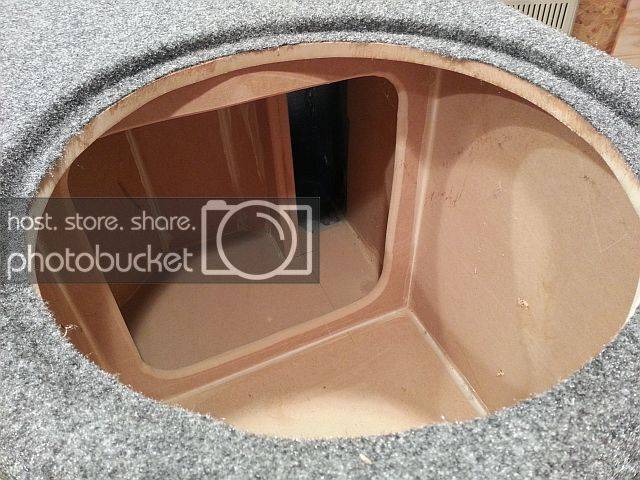

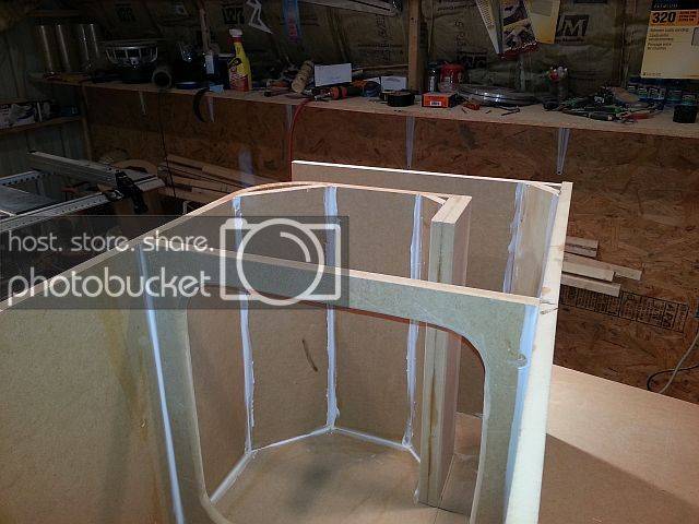

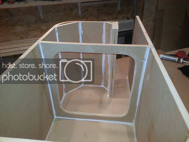

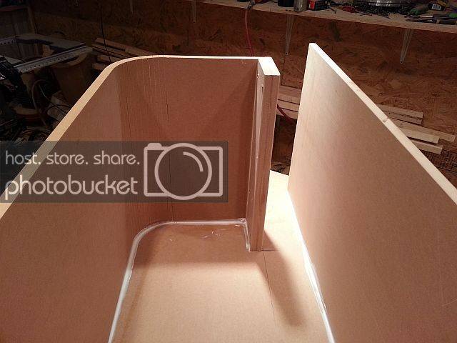

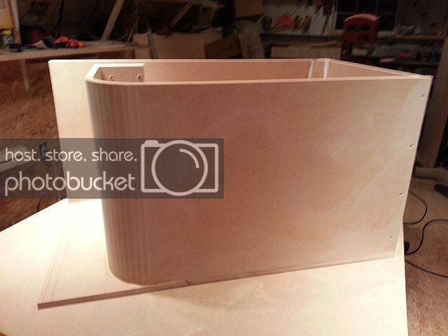

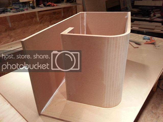

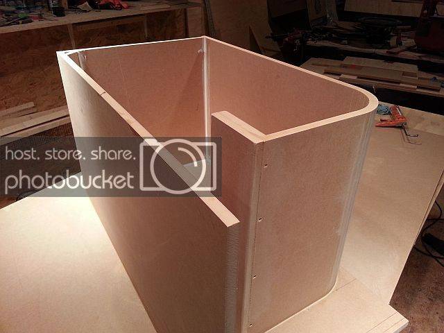

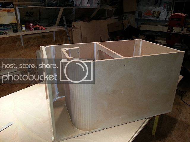

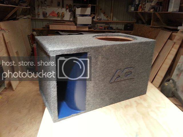

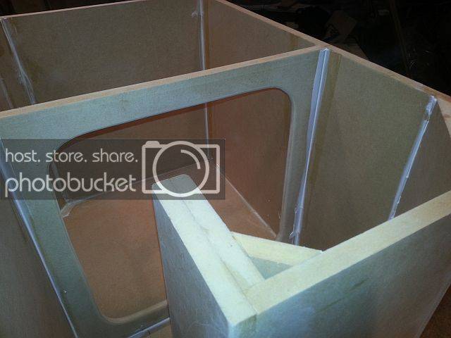

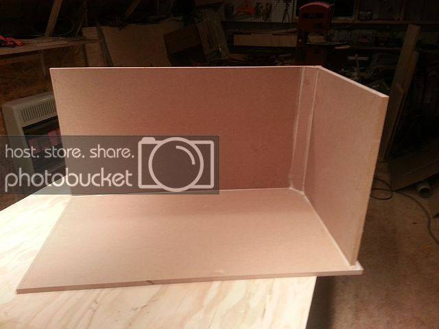

This is for a single 18" AQ HDC 3.........6.5 cubes net...33hz.......Going to be sub up flush mounted...AQ logo to the right of kerf port.....custom blue painted port....
