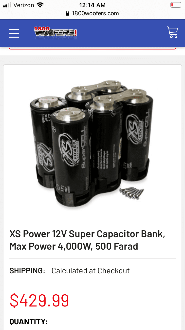

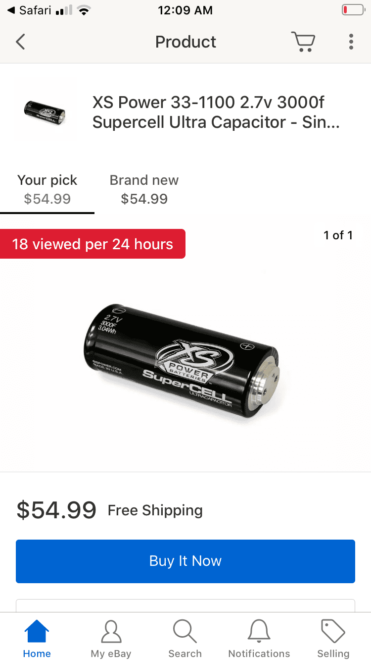

1-5f caps are garbage. They're usually the large 2 liter bottle looking things. Maxwell or XS power banks of caps end up being around 450f (3000f per cap, in series it's 3000f/6).
One battery and 1-2 banks of caps along with your alts will give you what you need. There's a lot of hype around lithium right now. Whether it be LTO (which look decent) and other chemistries but there's a lot of unknowns when it comes to longevity. On music, a cap can discharge and charge at a rate that well exceeds alternator and amplifier output so your alternators will essentially see a constant "max" load and the caps take care of the rest.
Hard to describe until you see a build in person and watch the voltage. You're talking <$400 for 2 banks of caps and the life cycle is a factor of 10 or even 100x as long

20646
so I just get 6 of these?
And if I go with the cells I would have to wire them in series? Could I just get the 12v Xs power SuperBank cap (the second pic that looks like a regular car battery) to make it easier?
