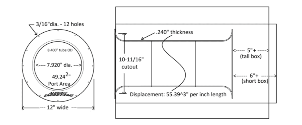

I know the general rule is at least the diameter clearance from a wall , running a 8" aeroport and I'm at 3" clearance should I shim this port up ? will it really kill that much bass ? If so what is the easiest way of shimming a port outta the box

Here's the info on an 8" aero...
Looks like 5-6" is what they recommend... it's all dependent on the flare area and box height I believe

So the more clearance from the bottom the better? I could go from 18" port to a 17" port I think it changes in torres from 33 to 34 hrtz

But the answer you are looking for is half the diameter of the port. You have an 8" port so 4" to from port to the inside of the box wall. This is what I was told when I came across this issue years ago and it worked out well.
