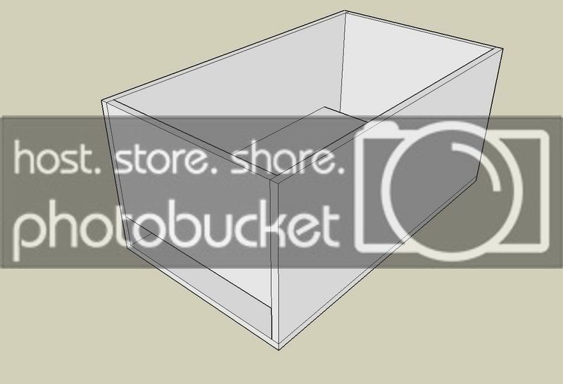

About to throw the white flag! Can someone check this box please..........
4ft^3 Net Tuned at 33hz...
Panel Dimensions:
Top and Bottom: 20.5"w x 35.25" d
Front: 19"w x 12"h
Back: 19"w x 15.5"h
Port1: 19"w x 30.25"d
you are the definition of awesome my friend.
Thanks:)

werd...have fun with the build. Post pics while your at it. I'm getting ready to do 2 15"s type-rs in my '94 explorer sport off 3kW RMS daily with 6kW RMS burp...so thanks for finally getting me to design a box for 'em, lol....
hahaha, yeah got two type-R 15's goin in mine too, but not that much wattage //content.invisioncic.com/y282845/emoticons/eek.gif.771b7a90cf45cabdc554ff1121c21c4a.gif 2krms. thanks a bunch for this, really gonna help me along. i believe second type-R gets here tomorrow //content.invisioncic.com/y282845/emoticons/yumyum.gif.0556df42231b304b9c995aefd13928a8.gif
Kewl...have fun my friend. I'm sure they'll wang chung...
