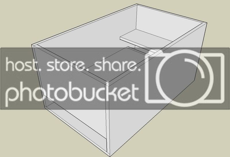

About to throw the white flag! Can someone check this box please..........

two port walls? //content.invisioncic.com/y282845/emoticons/frown.gif.a3531fa0534503350665a1e957861287.gif

Yea...for your effective port length with your 3.5x19.5 port, I got alittle over 40"....I"ll post a pic real quick...
port can be up to like 5" if that will get rid of second wall
More port area only increases port length while holding Vb constant...it'll be fine the way it is...the ONLY thing I might worry about is clearance...you have 12" from top of Port Wall 1 to the bottom of the top piece...But A.) The type-r have side vents on the motor structure and B.) The type-r's are no where near 12" deep...
