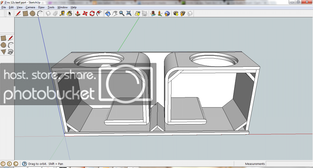

You could do around 7-8ft3 net volume and be just fine. I would do a rather generous amount of port area though.
Subs forward with port up or subs up with port up will work nicely.
like this.
