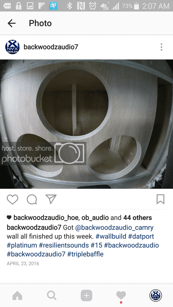

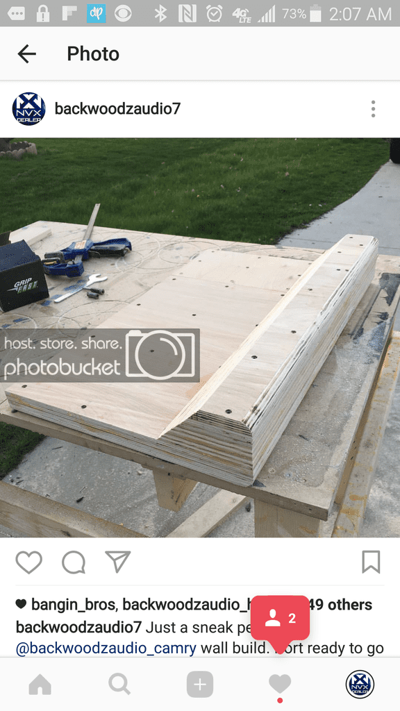

Build originally consisted of 3 resilient sounds platinum's 15's on a taramp 6500 a singer 240 and a couple agms all shoved in a camry. The original goal was to hit a mid to low 50 and demo monster so we tuned it for such. Box 3.5 cubes per subf tuned to 31 with fairly average port area. We took it to the first show and it exceeded my expectation out of the gate a 154 3 round music average and earned a 1st place trophy. After that show we took it to a meca show and to my surprise it was doing this 54 while only clamping 2k. So we upgraded power and gained to a 155 with the taramp 8k while only clamping 3k. So now we are here with a taramp 15k and the car us currently siting at a 57 no idea on clamp numbers yet we will figure that out at the first show This year. Future upgrades include some lithium and maybe try to put a second alt on somehow so I will try to update as things change. All scores listed on the dash driver door open. The video is also with the original setup with the 6500.

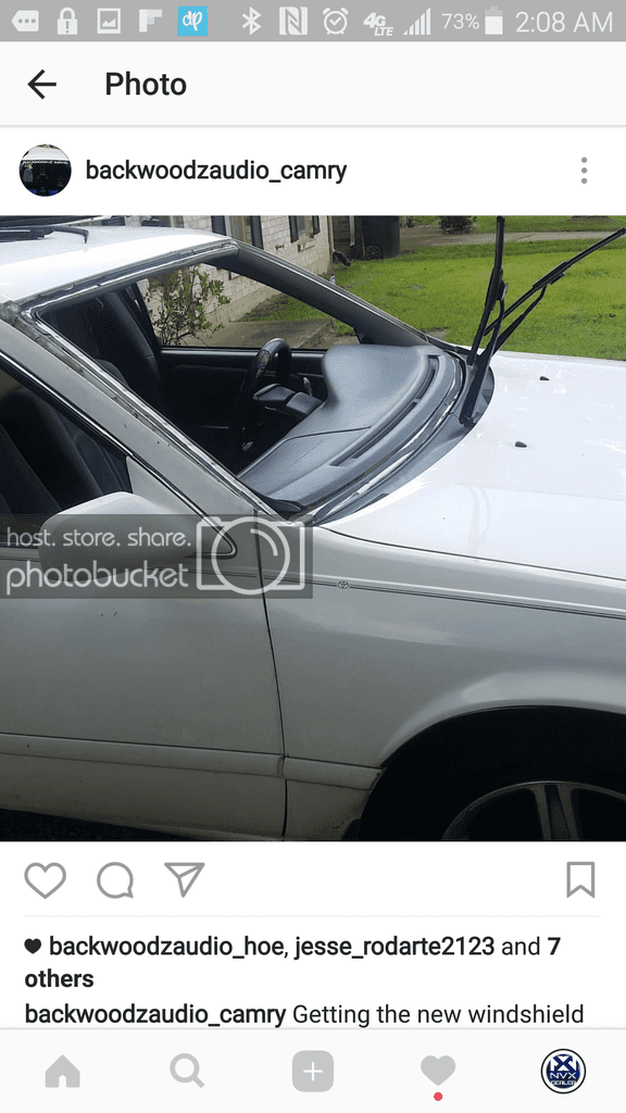

lol rip windshield
