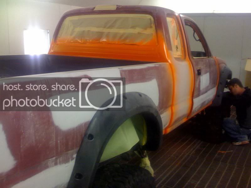

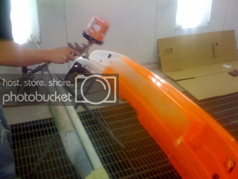

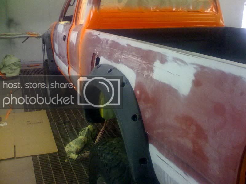

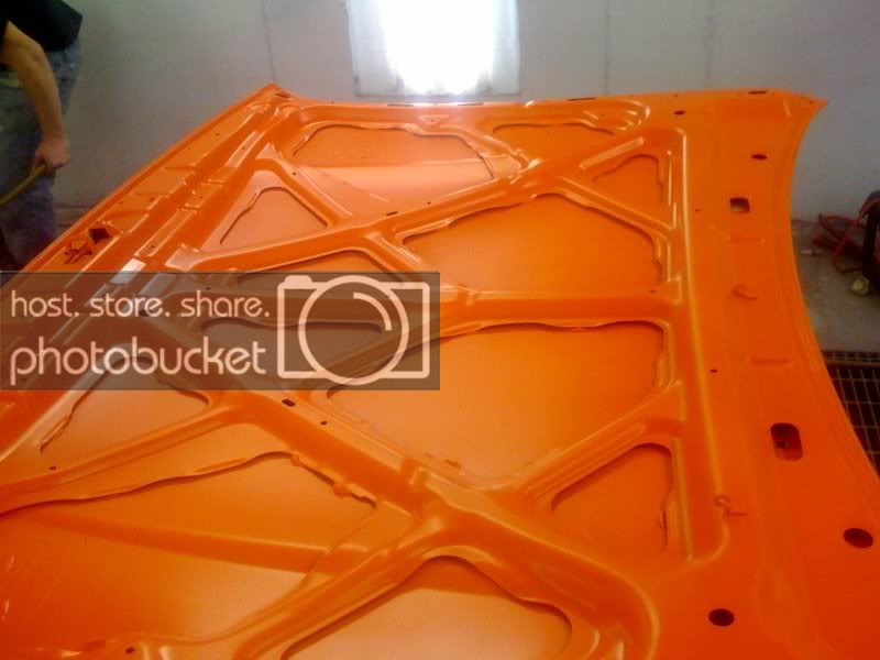

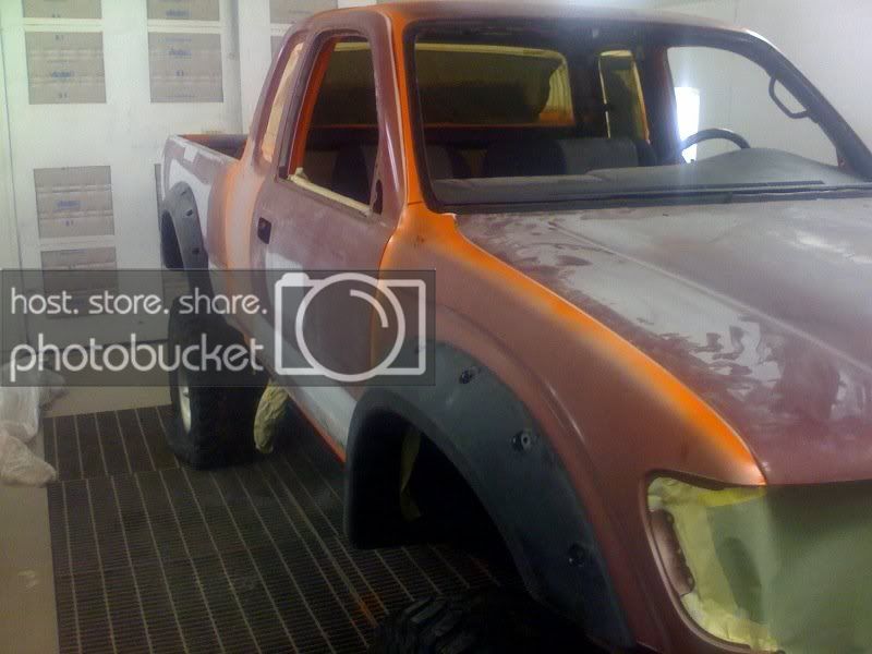

Ok my friend at the paint shop got tied up on insurance jobs so the paint progress was slow it is going to be finished soon we masked the entire truck tonight and sanded everything down so we can paint tomorrow. Pics so far

Even though some people are gonna say they're tacky, I say the truck is gonna be sick with the oversized fender flares, I love the things
Are you going to spray them orange or leave them black? Please say you're leaving them black.
They are going to be orange
interesting to see you didnt primer over the fender flares.
Just curious, how is this a 4 stage paint job if your not even priming it? Maybe I am missing something, and im sure my Dupont certification doesnt mean to much but last i checked.
Also I have usd house of kolors tangelo orange on multiple show cars. If you want to do it right, lay down a solid white primer, then the flake in a silver base, then the tangelo, followed by clear. This is how my last project turned out.
Not using house of color, but 1st coat is white chromatic. 2nd coat is orange. 3rd coat is prismatic pearl. Then high solids clear. Remember lambo orange is a ppg color. Hope this helps.
