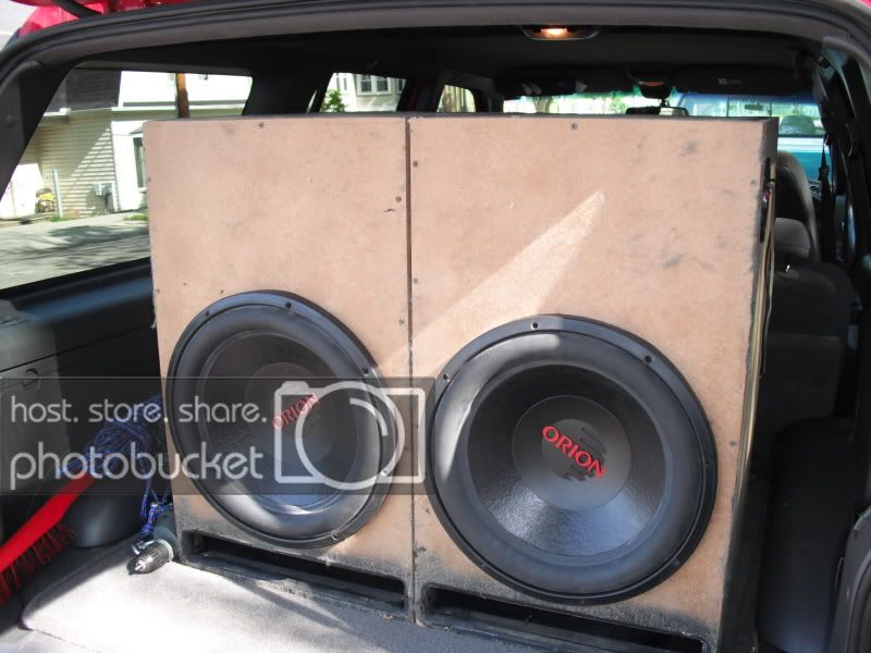

So my question is: does anyone have experience building an enclosure for an SUV that utilizes 2x12's and 2x15's. I have my 15's in a box built to spec but i'd like to change the shape for those and be able to make room to add to 12's to get that mid-bass response.
The 15's require 3ft cubed and the 12's I haven't decided on but I'm thinking MTX 9500's
I will post up some pics of what im working with and a sketch after I figure out dimensions and placement.

Im pushing 2 hcca's w/ a M.A. Audio HK 802sx 4400watt. The box was custom built for a silverado so I choped it in half and lined them up side by side facing the hatch. These subs are 11 years old and when installed they were installed to this box and from what I've read, have the right dimensions. 3 ft. cubed per side.

per side and Its sloted/ported. Ill post a pick here in a min.
