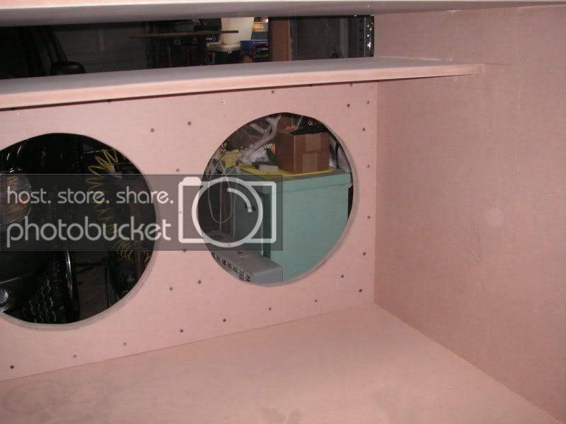

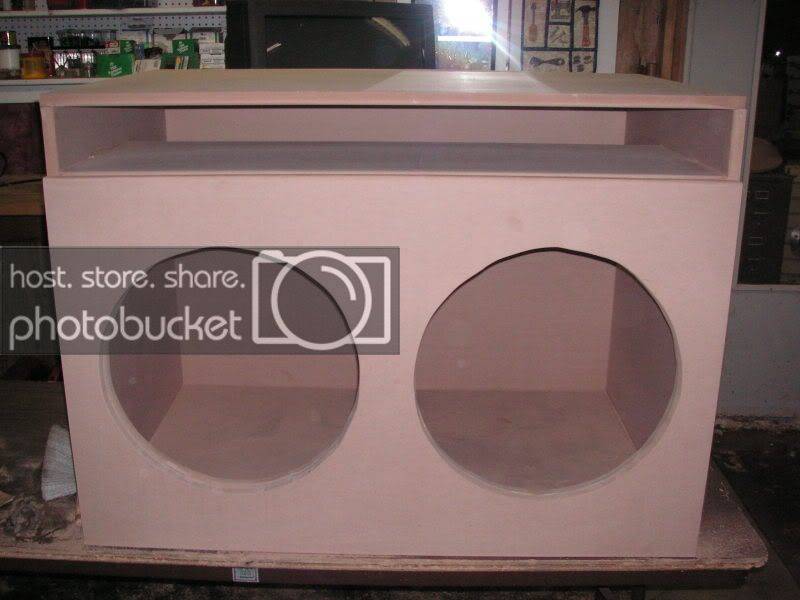

Well started on the box, still needs a lot of work tho //content.invisioncic.com/y282845/emoticons/crap.gif.7f4dd41e3e9b23fbd170a1ee6f65cecc.gif It will be 15 cf3 after all displacements, with a 160in. port area tuned to around 34. Here is just a couple pics. It will be braced also, just haven't got to it yet.

anyways. that single psg won't keep up trust me. do some door pods or at least add some tweets on the a-pillars. i have 3 sets per door + tweets on the a-pillars and it keeps up alright to my btl's.
and don't forget to add major bracing on that box btw.

Thanks for the replies guys, yea I'm going to throw the psg's in there and then go from there. I'm keeping the rear seats and basically doing like what you did kentb. I will be adding some bracing in there like i said. This is my first box and so far I think its going alright. //content.invisioncic.com/y282845/emoticons/smile.gif.1ebc41e1811405b213edfc4622c41e27.gif What does an MLA module consist of/price/where to get one?
Looking good.....port area might be a little small but hopefully you won't hear any port noise. Good job for your first box so far!
Any one know how much those mla modules cost and, where to get them and how hard to install? KHARPS thanks man yea I know I was kind of worried about port noise, but I tried to round all the edges of the port on both the inside and out, will prolly sand them down even more, so hopefully that helps //content.invisioncic.com/y282845/emoticons/smile.gif.1ebc41e1811405b213edfc4622c41e27.gif
