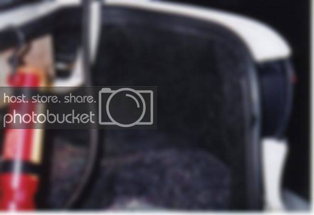

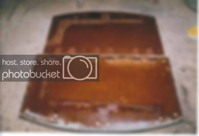

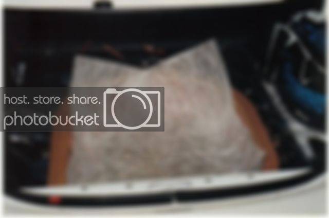

Here is the motorized trunk.

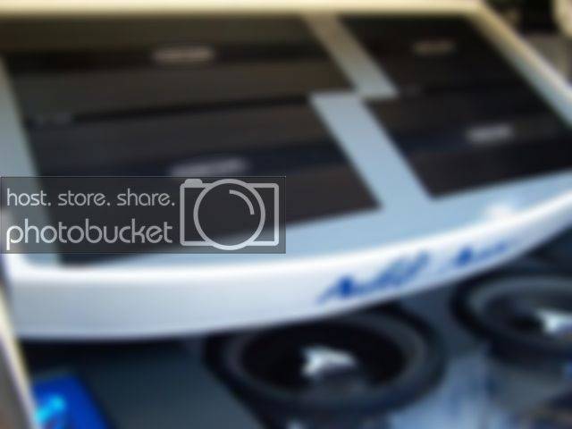

Amp Rack under the rear deck for 2200 watts of Concept amps.

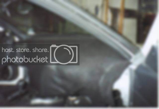

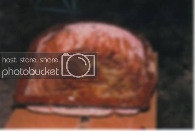

New Kick Panels for 2009.
Tweeters were moved to the kicks and out of the a-pillars.

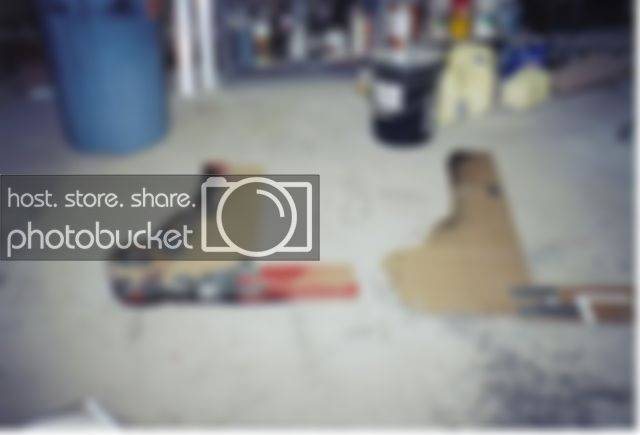

Stretching fleece and fiberglassing
Wired, Dynamatted, and stuffed with Polyfil.

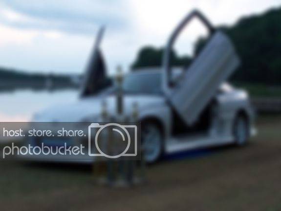

Exterior

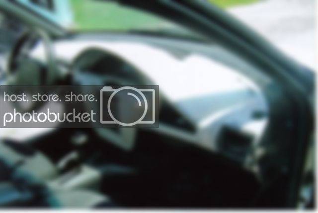

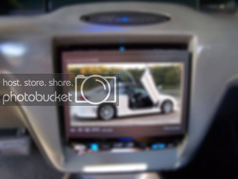

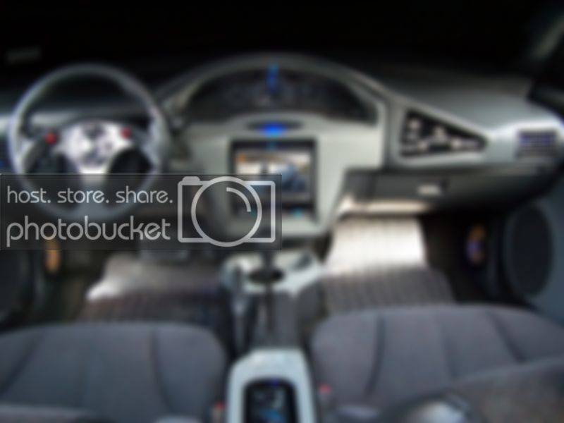

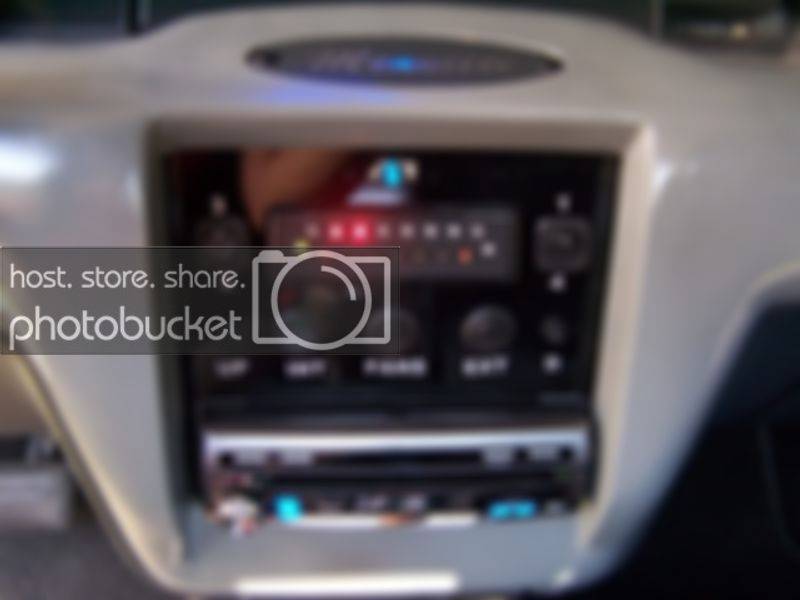

Dash looks good with the screen up and not so good with it down. Cheesy star wars effect is what comes to mind...

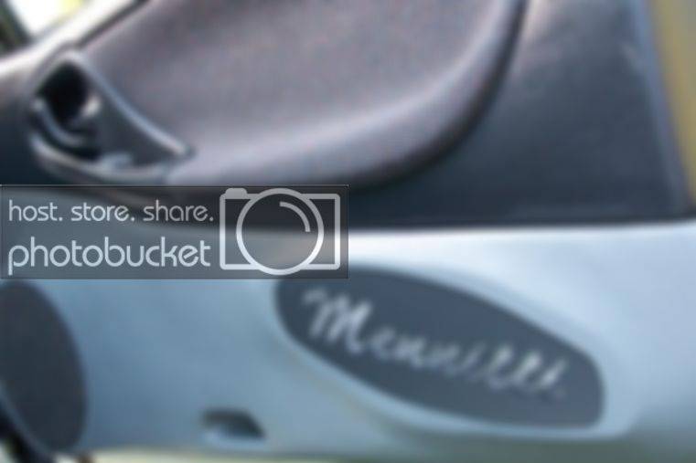

Name plaque on the door just doesn't flow right. Maybe if the lip followed the plaque cut out better...
Yep. I threw the doors together in a day for a show. As I mentioned, next step is upholstering the lower half of the doors....including fixing the lip to match the plaques curve.

First off the doors are not bad, but id loose the personal naming scheme though //content.invisioncic.com/y282845/emoticons/wink.gif.608e3ea05f1a9f98611af0861652f8fb.gif
If that hole in the door is for the midbass’s port and you really built the door panels in an enclosure ported and tuned right that a huge bonus.
‘Would like to see build pic’s of the doors in progress if you can.
If that hole is not a port and the doors are not really a real enclosure with a tuned port then un-give yourself that bonus
The dash like others state is really good and really bad at same time
Loose those radioshack switches and lights m8
It looks kiler with the alpine in tv mode but once radio is down looks like total cheese
If you want a switch box area for yourself build a compartment in center console out of sight.
lol I picture you entering the car and flipping switches while you talk to houston at mission control, hehe
Kickpanels look great in build quality but the imaging doesnt look right if at all
The midrange isnt so bad but the tweeters are deff not angled and you want the image to be dead on with kicks and you have room there to work with all angles but you seem to have gone more for the lets install components in the kicks rather than does it sound right or should i angle the mids and tweeters at an angle toward the listenrs ears before I glass.
ampack is very neat

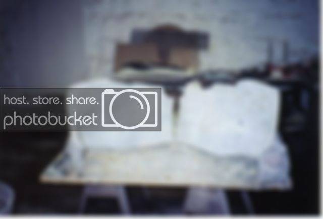

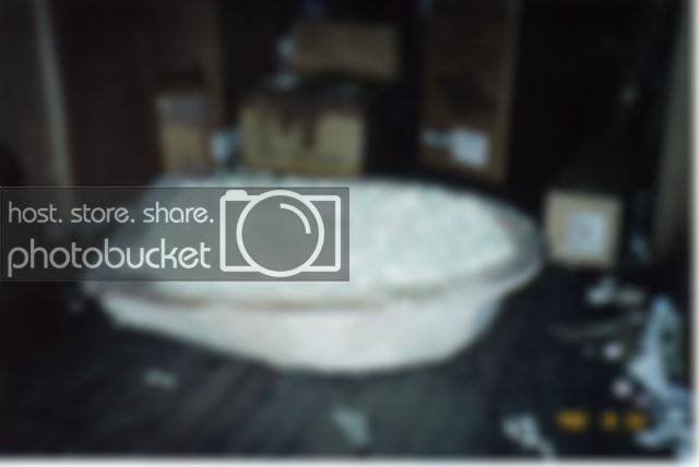

sub box is nice and basic but i can still see the bed sheet or whatnot you used for the mold and the box doesnt look to thick
