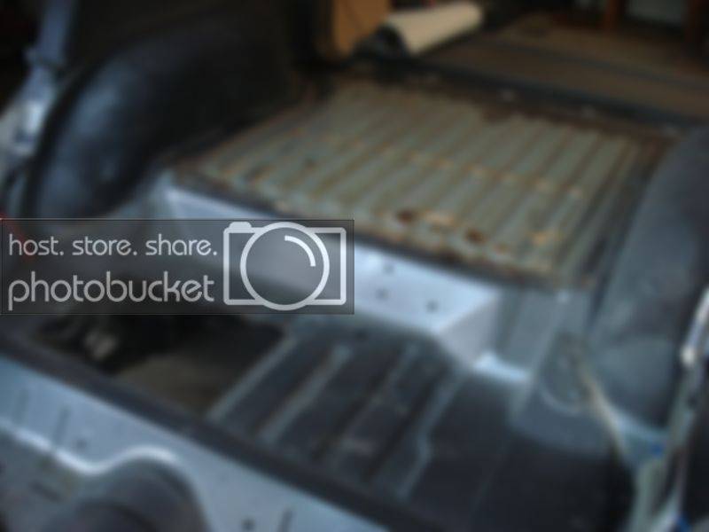

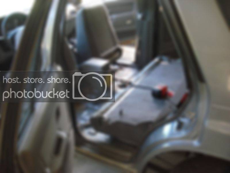

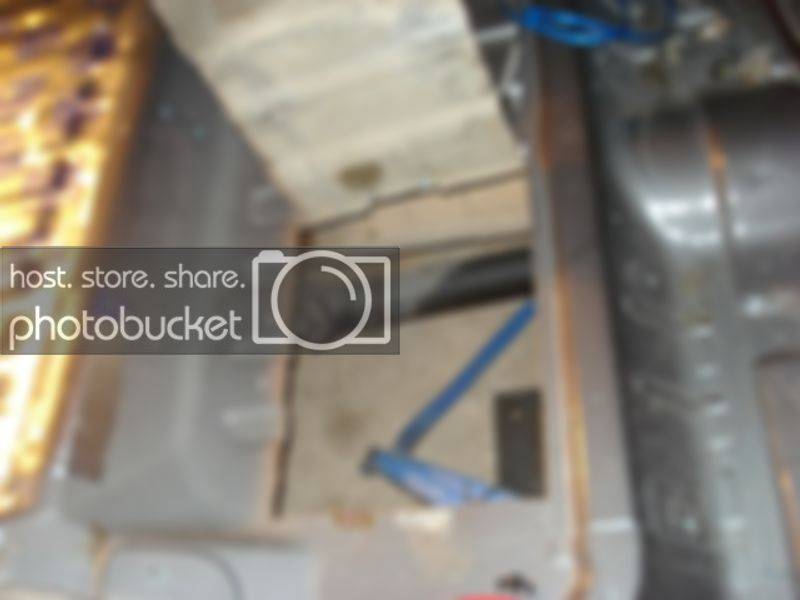

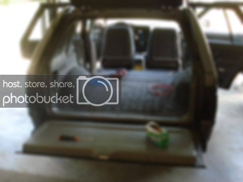

started out this evening by pulling the rear seat, carpet and side pieces.... pulled up all the oem sound deadner that was on the floor seeing how it was pretty much all the way loose and cleaned the floor really good with paint thinner then started laying down some fatmat i had left over from when i did my d50.... im going to meet up with djm4rshm2llow tmrw evening and getting some dynamat from him...ill have to order more after i use what i got and what ill be buying tmrw. for now i just want to get everything from the back seat back done then ill do the front later... onto the pics

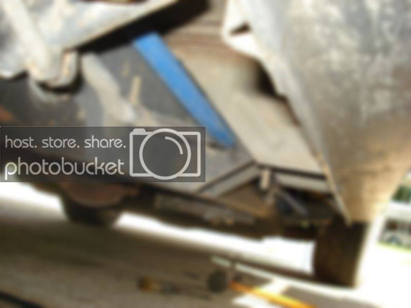

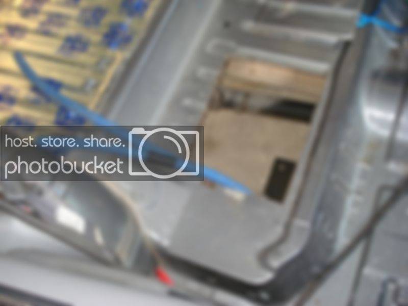

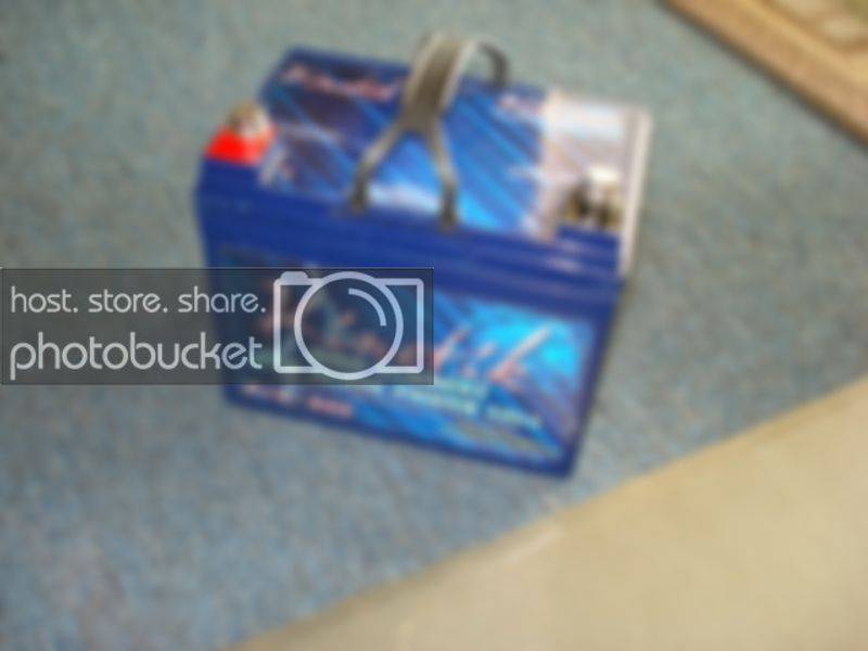

my buddy that i bought the passport from was going to put hydraulics on it and this is where he was going to mount the pump but with a little more bracing and a good battery box its going to be the perfect place to put my 2nd batt. its right under the pass back seat...i still have the section of floor and ill be putting a hinge on it and sealing it some some type of gasket

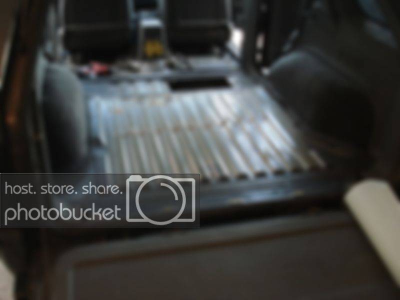

this is where i stopped for the evening

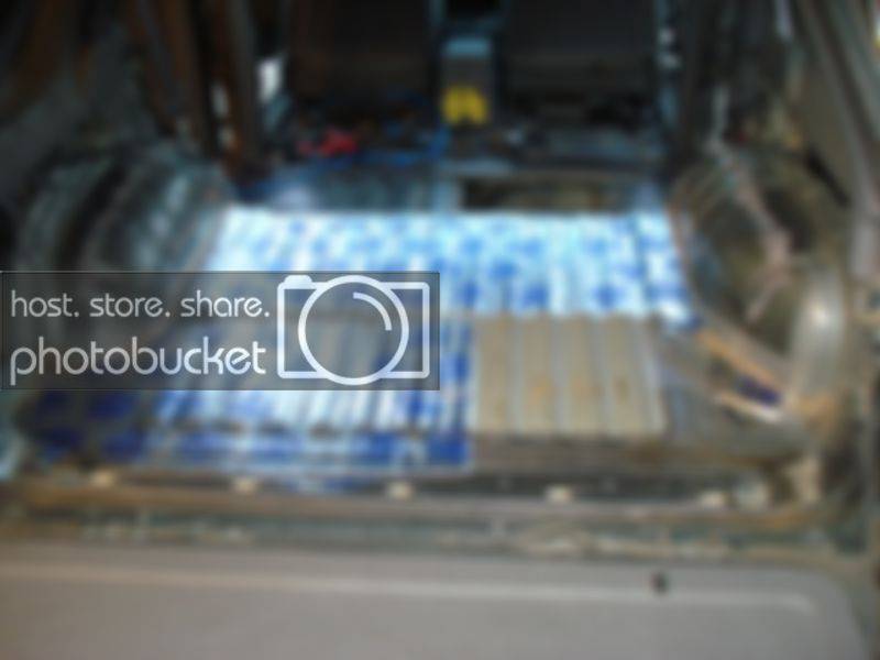

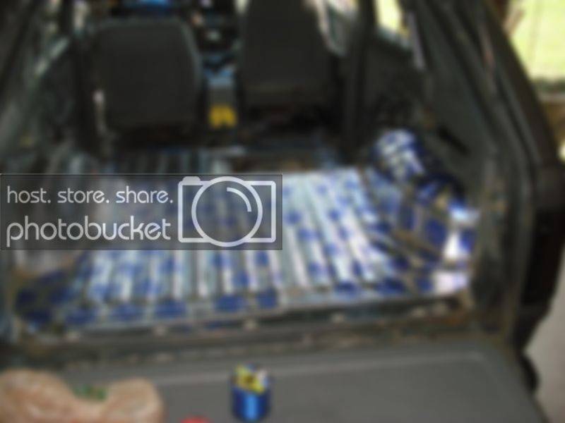

got some more work done sat and sunday evening....
first layer of the floor and pass side wheel well done..

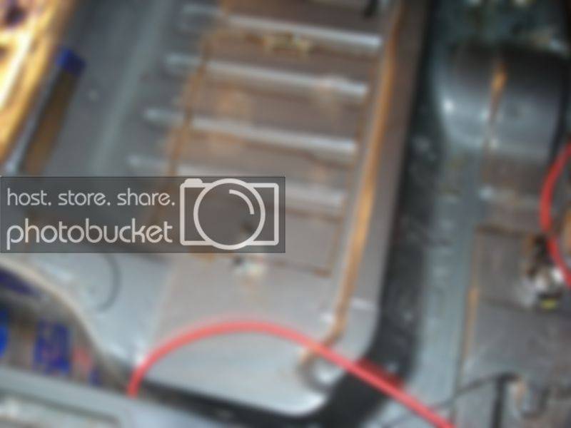

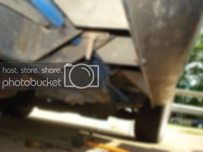

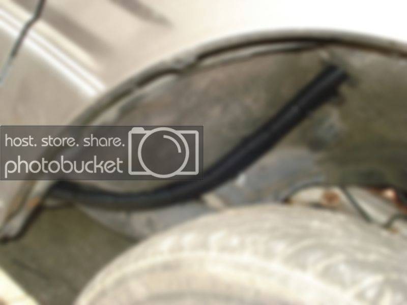

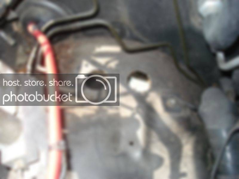

so i couldnt figure out how i was going to get the wire into the engine bay because there wasnt enough room between the frame and the exhaust for the wire to pass safely throught so this is the best thing i could come up with. i drilled the holes out with a hole saw, cleaned the edges with a file and put some moudling around the hole and wire loom over the wire

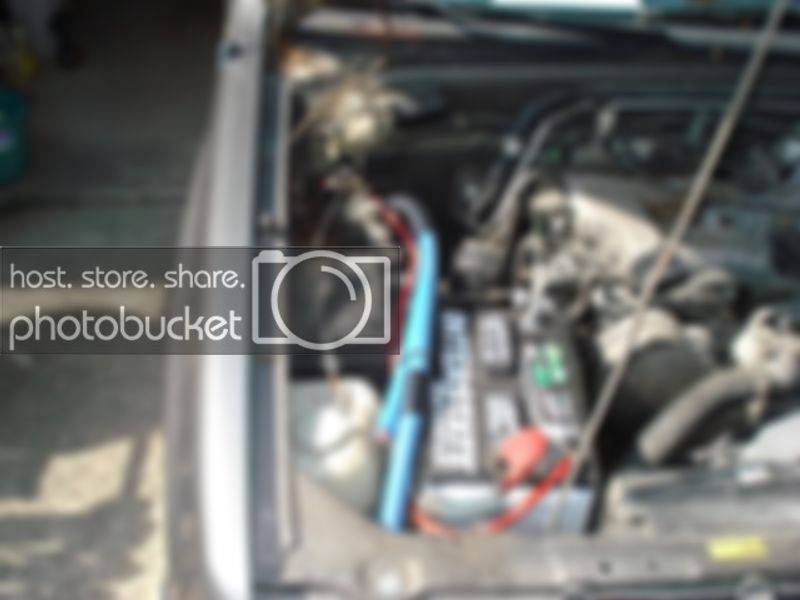

ran under the body, secured and out of the way

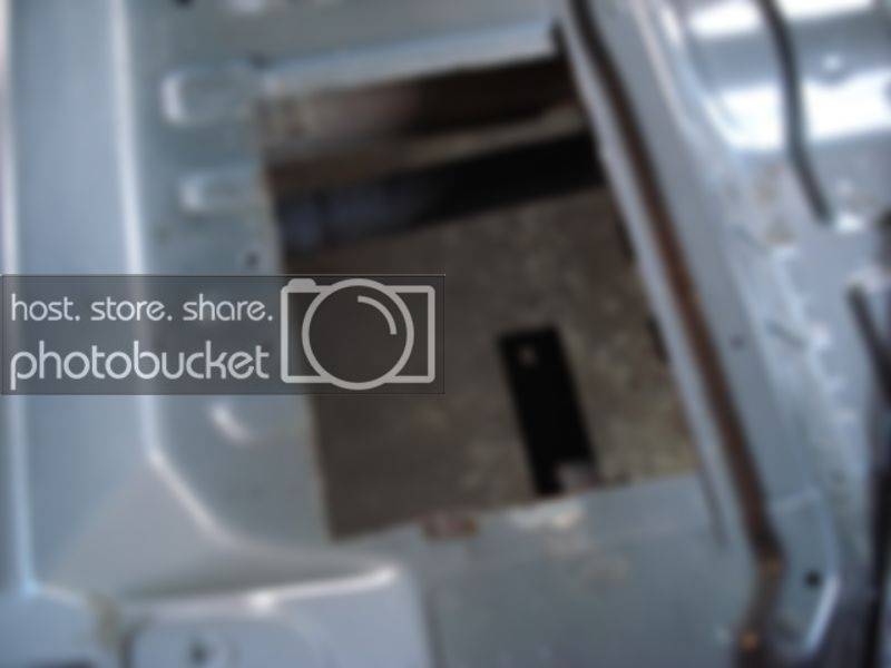

wire comig up throught the floor access
got the hinge and hold down installed... im going to take it back off and clean some of the edges up and seal it up tight
