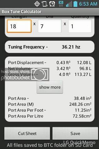

This should do nicely 24d x 22w x 16.5h 11.25 inch per cube. A 8" was hella long and came out to 16.58 per cu.

Sonotubes make a 7". But i do have some some thick wall 8" pvc thats 7.5" inside. I was just statimg that a 8" areo well be a little muh on the port area. Pscho ports and areos can be had in 7".
