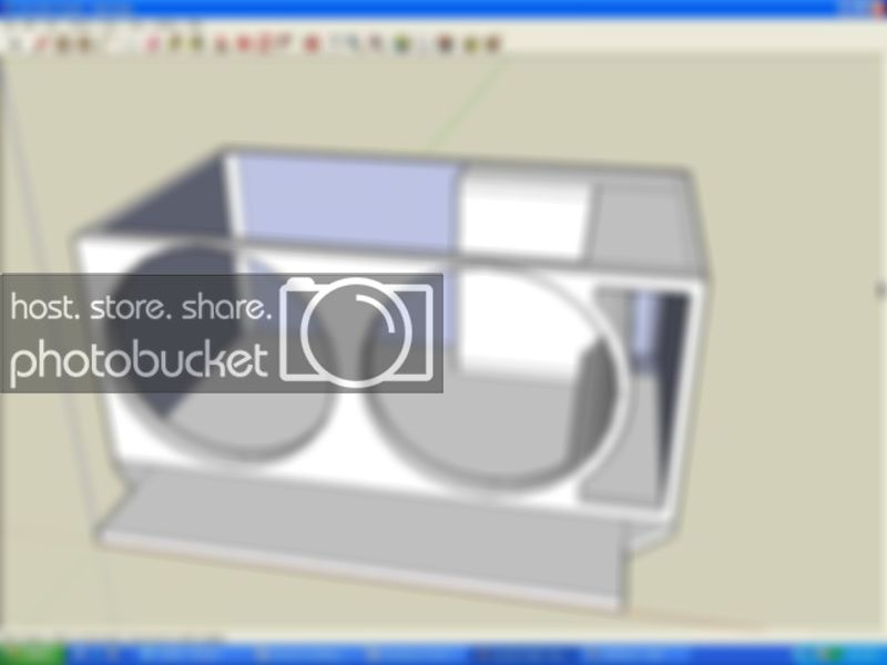

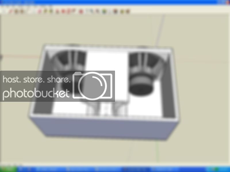

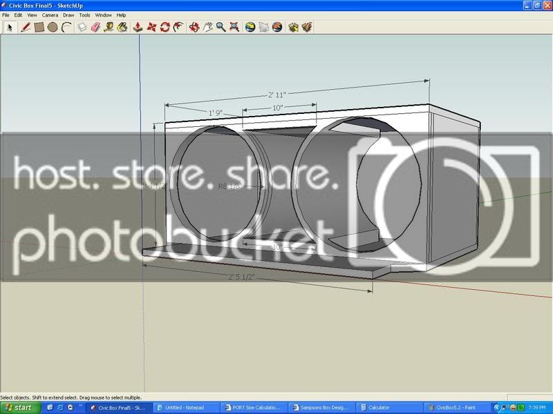

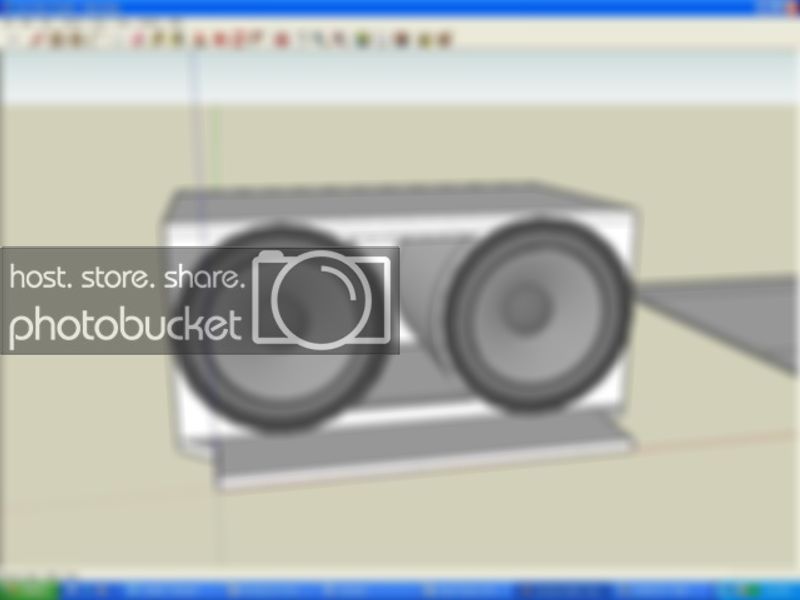

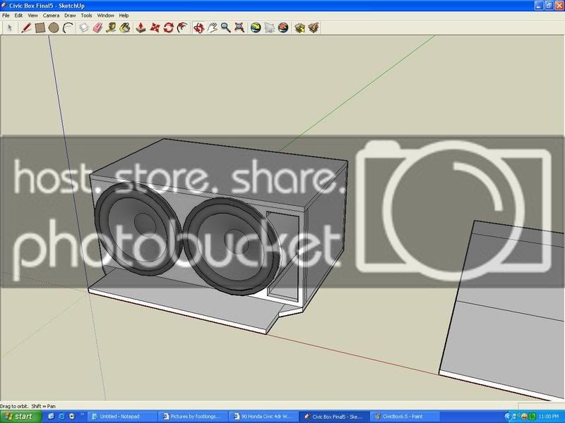

well i run a trunk car but **** man this is so far from what i do to get mine loud lol. you could fire the subs back port to the side. on that design an 2000 watts or well a hifonics 2008 i was doing a 142 on music. would love to have both in to see what it does on the meter an will find out this weekend for sure what it does.
but yea i would say try subs back an port to the side.
The only problem I have is the box I have in there is touching the back of my trunk and **** near touches my back seat so I don't know if firing back will help.. And my wheel wells touch the sides where my port would go.. I'm not sure .. I don't know if my box should be any smaller than it is to use that design...
or
any tips on how to make that port? Kerfing the only way? or anything else? Im too familiar with basic *** desgins to try anything new.. lame yes, but hell i dunno..
