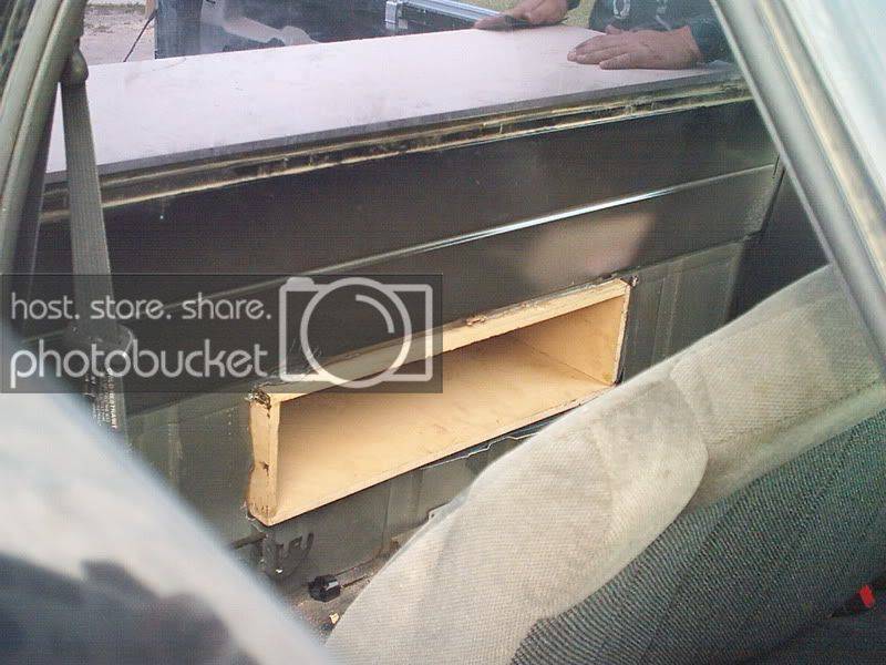

Heres a starting pic of a system I did in a 95 Sonoma reg cab with 2 15" Earthquake Magma`s in a Bandpass Blowthrough. Port was 6" by 24" inside.
It worked real well for daily the flex of the cab was unreal for equipment used.
Dont mind the cutout it was covered with a carpeted pretty panel //content.invisioncic.com/y282845/emoticons/biggrin.gif.d71a5d36fcbab170f2364c9f2e3946cb.gif
Go to a Rv\Trailer place and as stated get an accordion boot seal

i was thinking something like that. anyone else have any pictures?
