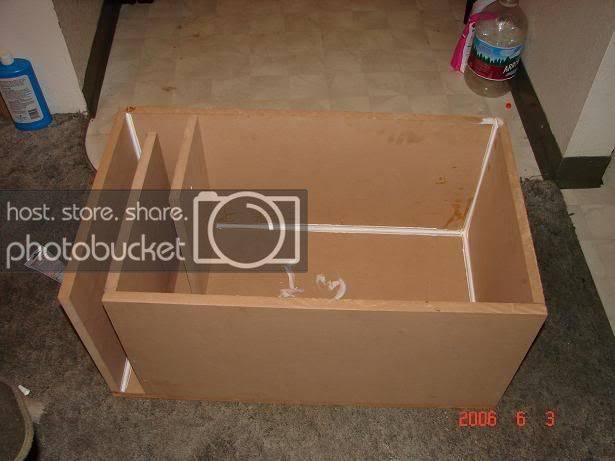

Heres the car by the way, It's got quite a bit of pick up if you know what i mean:naughty: The other pic is my first good box I built.
