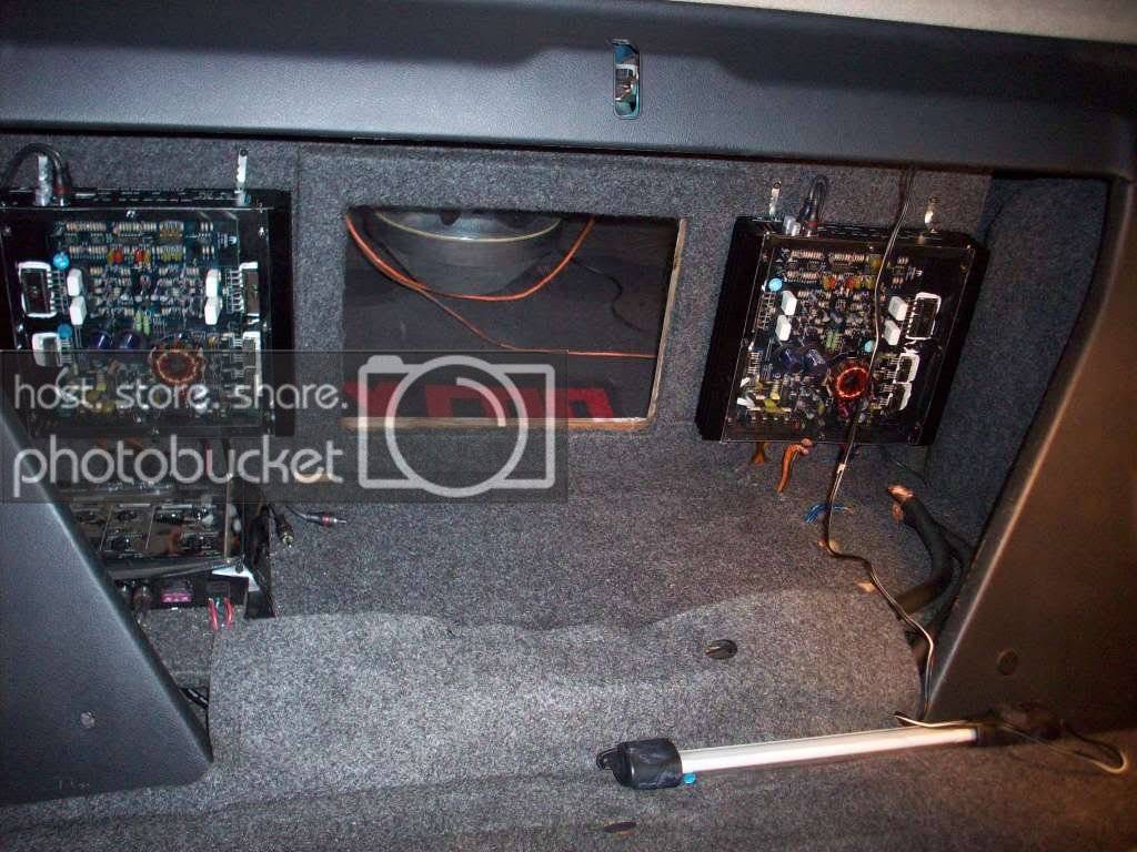

Copied my build log from ssa forum, pictures are some what out of order.

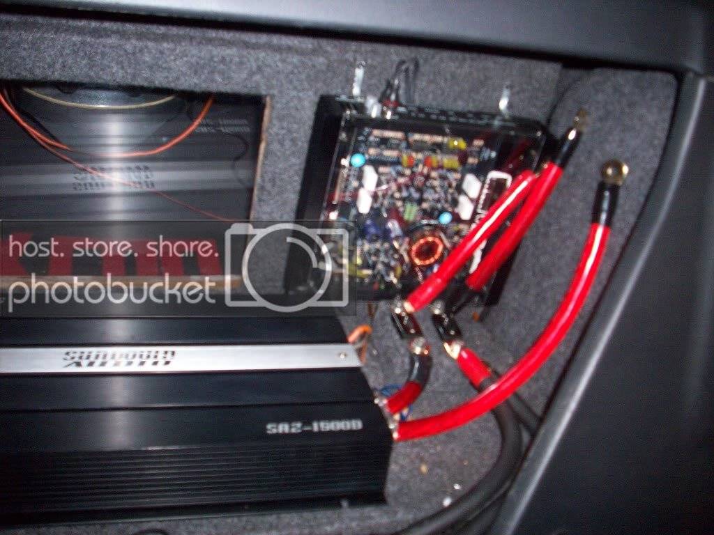

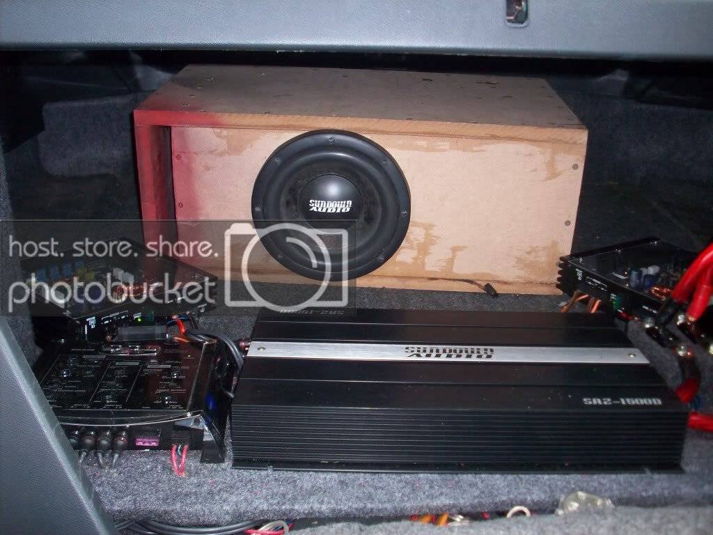

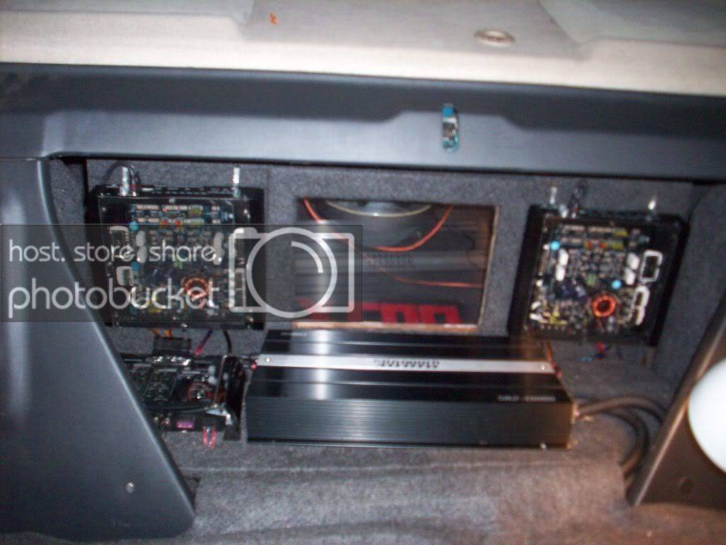

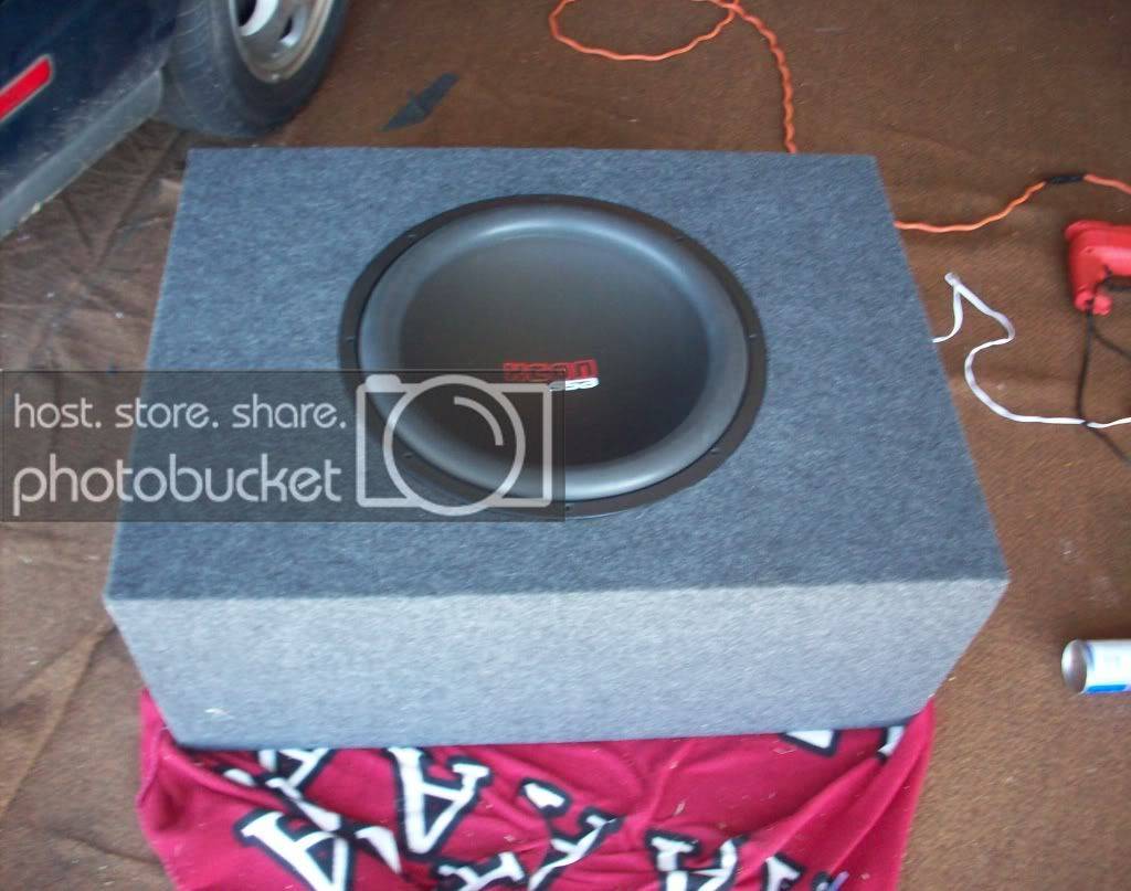

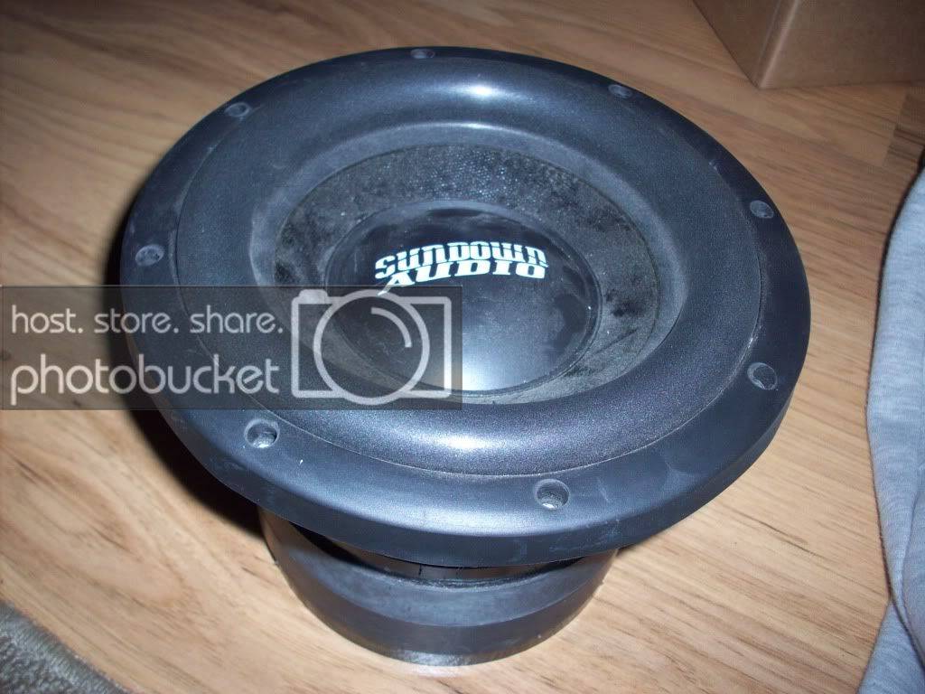

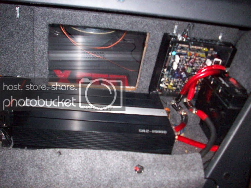

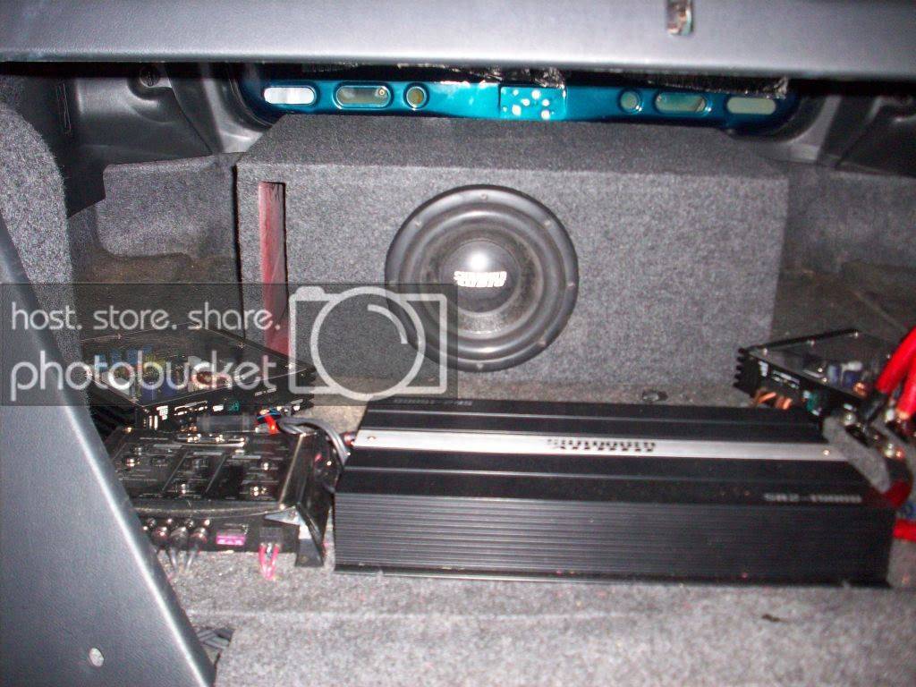

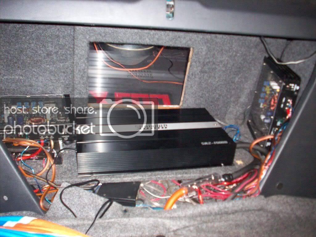

Current setup is Sundown Sa-8 & Saz1500v2

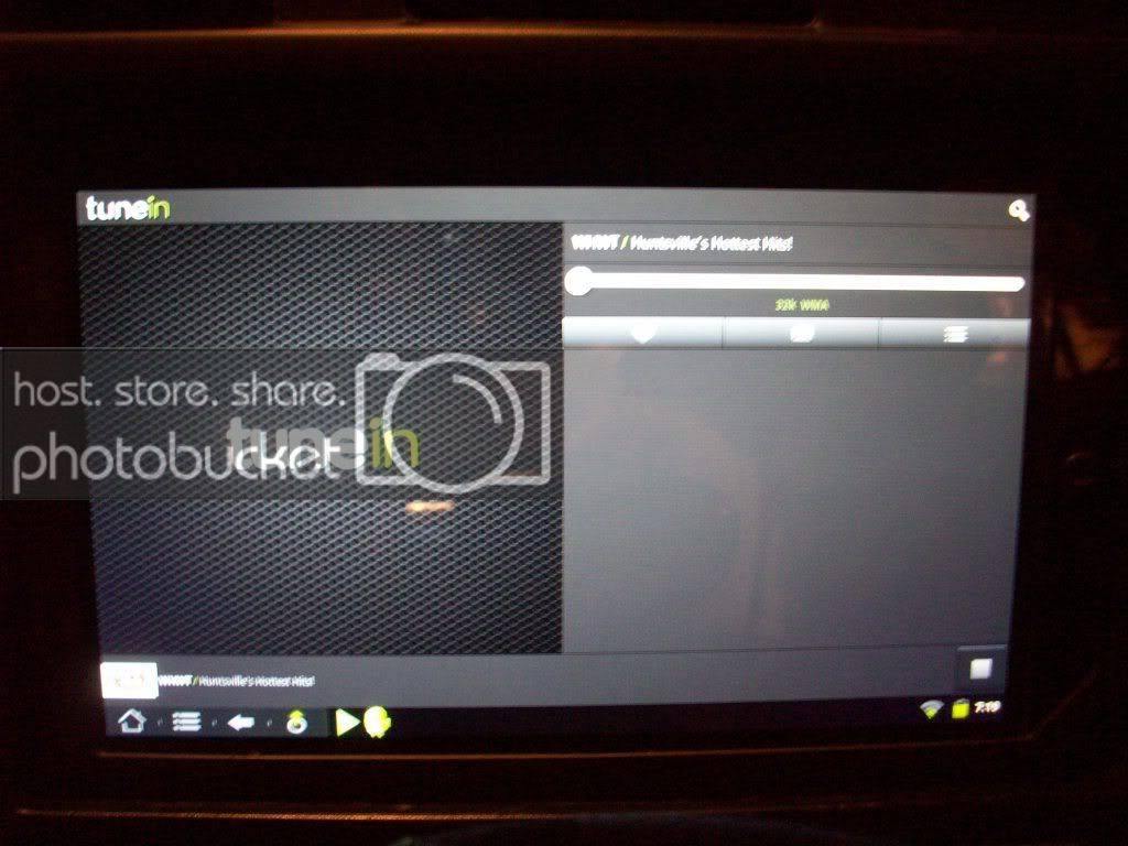

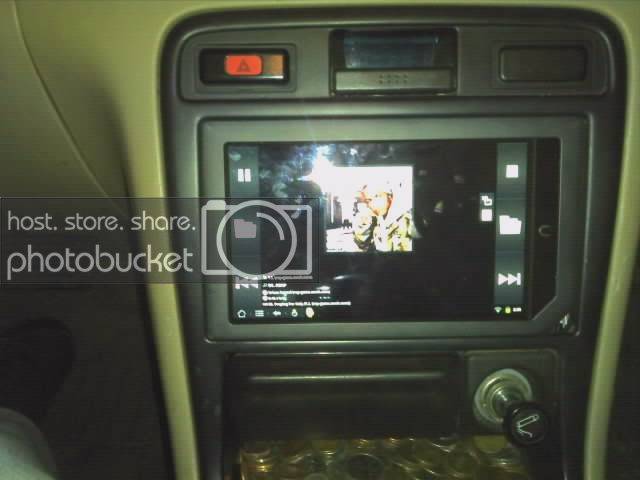

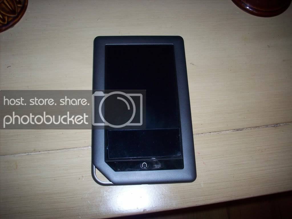

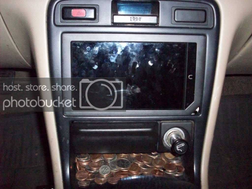

Nook Color
3g tethering with my phone for google maps for navi and streaming fm radio.

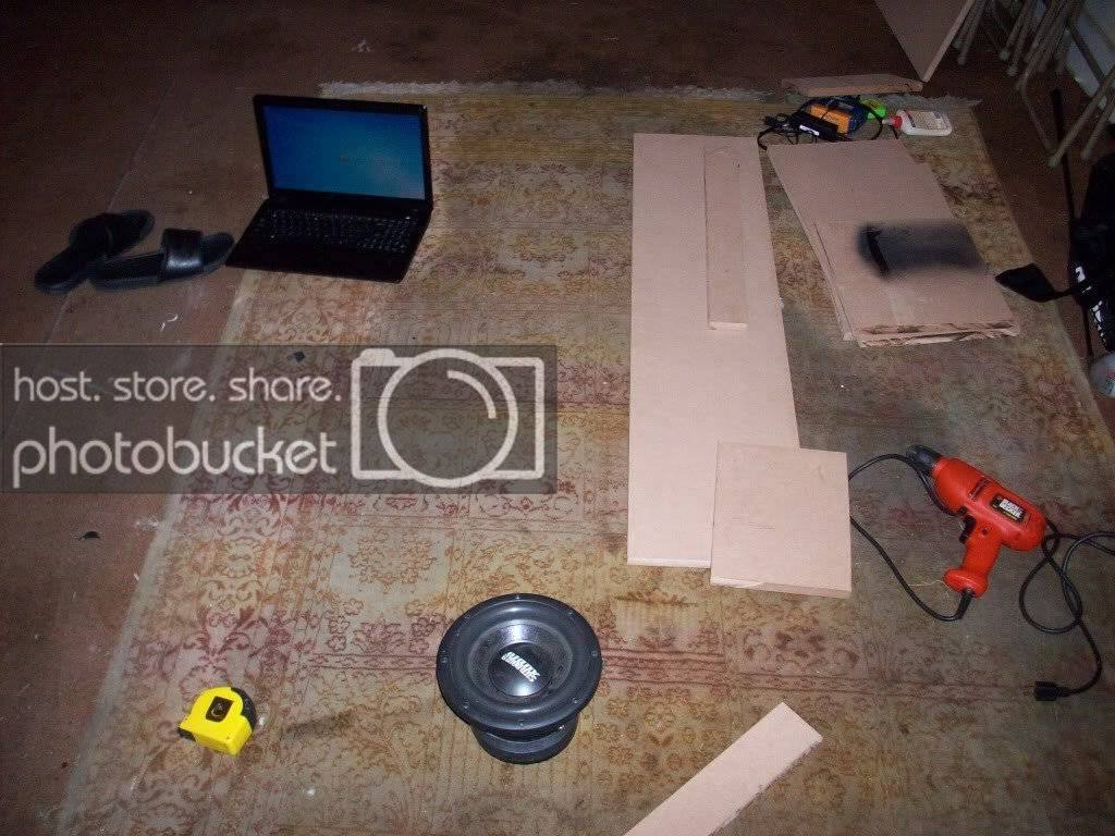

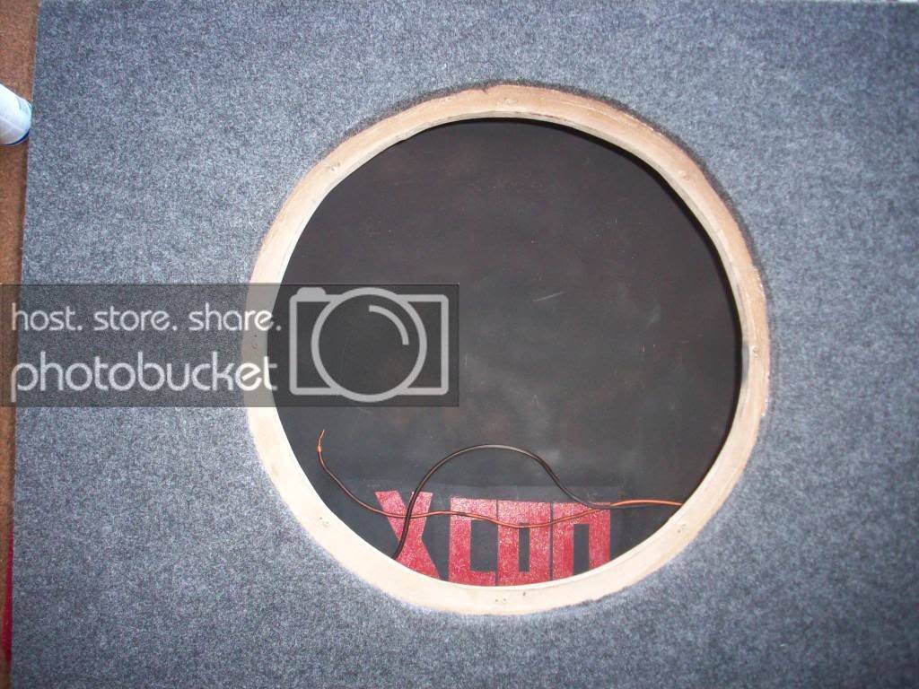

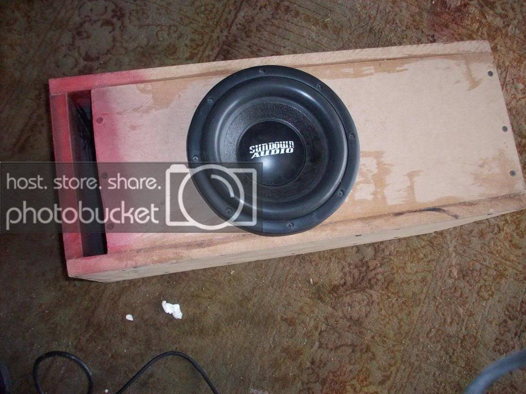

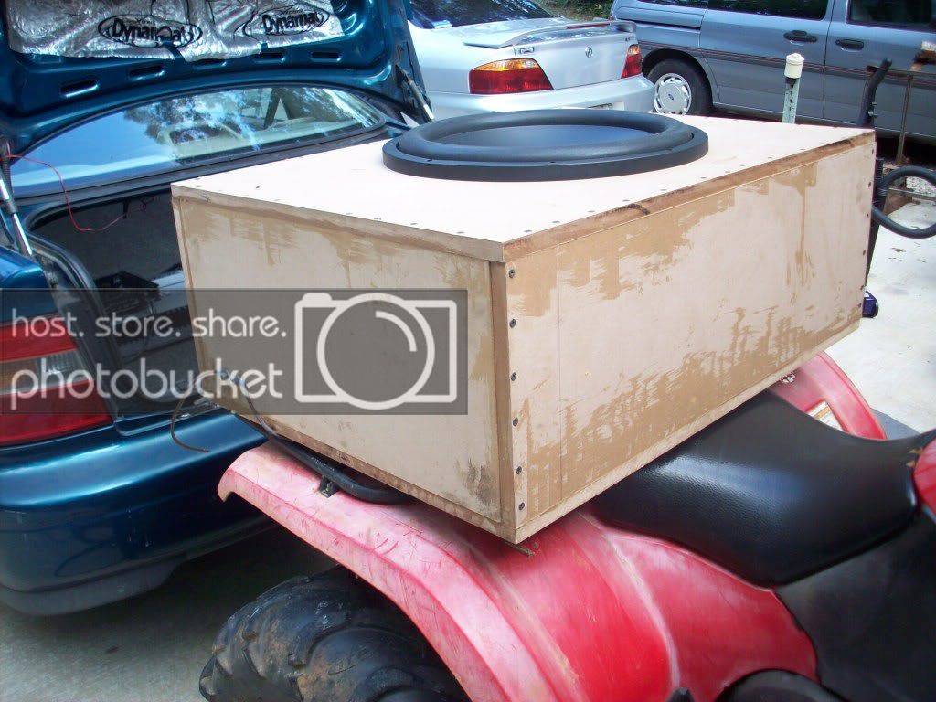

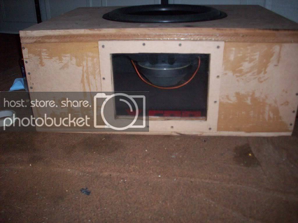

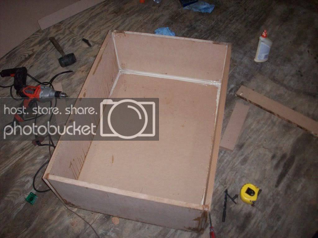

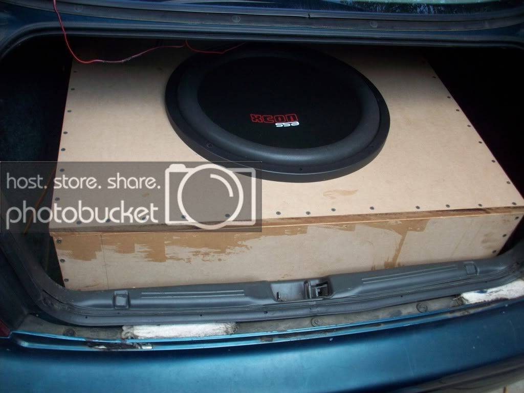

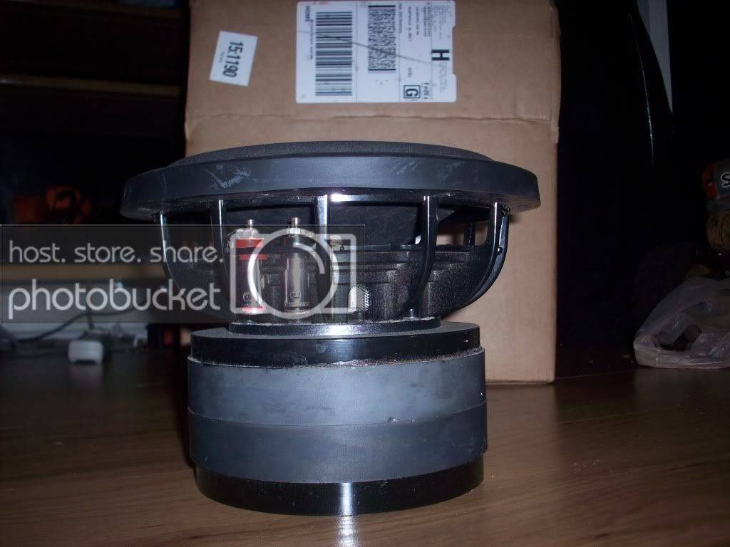

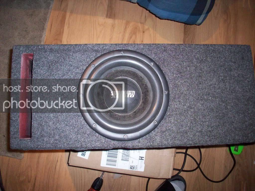

I blew my xcon so I bought me a used sundown sa 8 to hold me over until I get my xcon back.

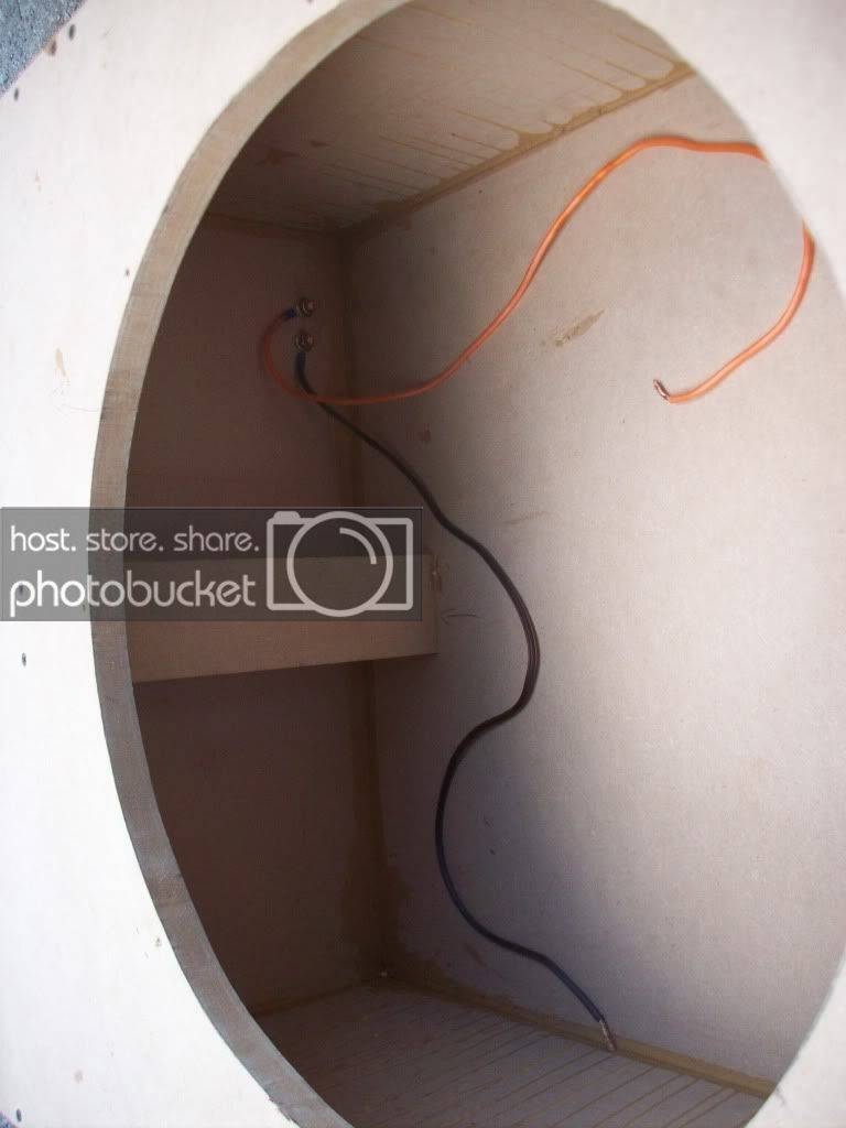

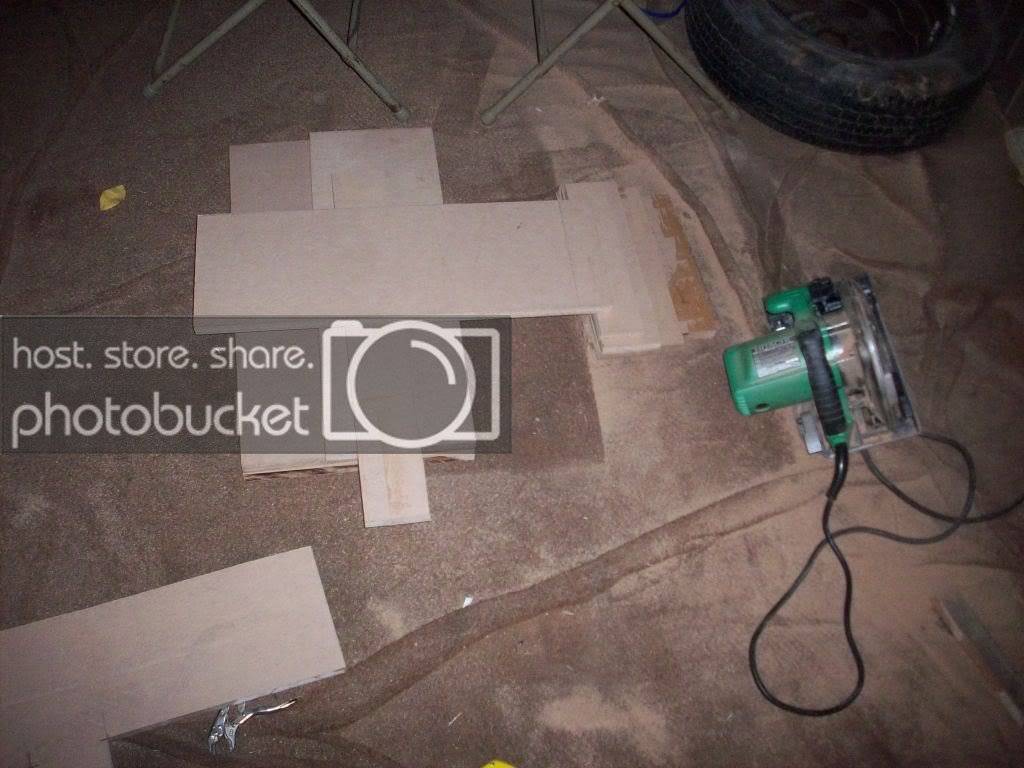

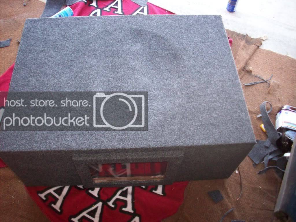

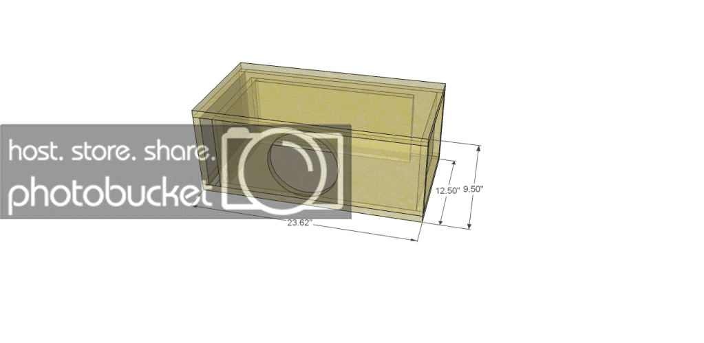

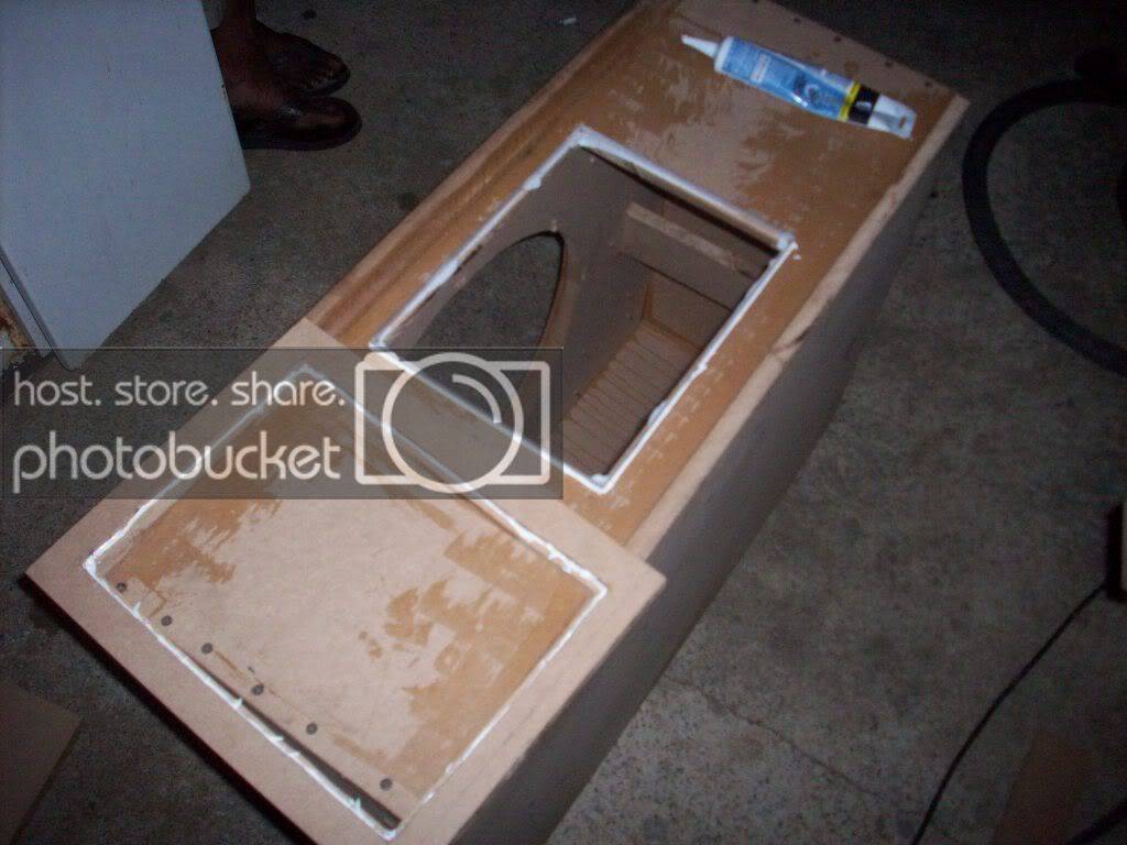

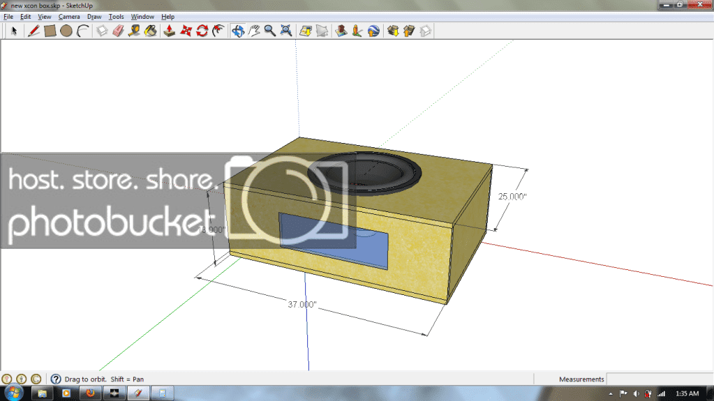

.76 cubes net, 10.4sq inches of port area, tuned around 33hz

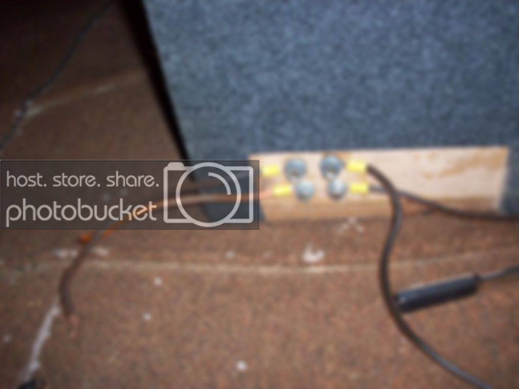

homemade fuse block

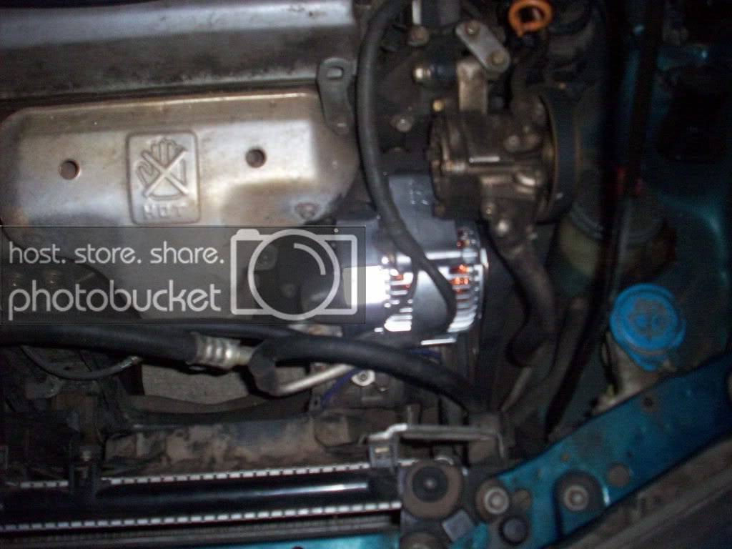

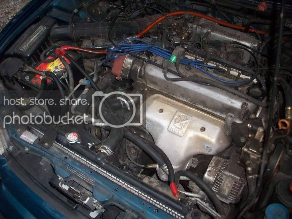

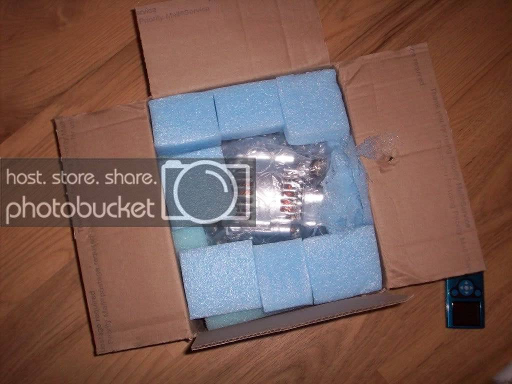

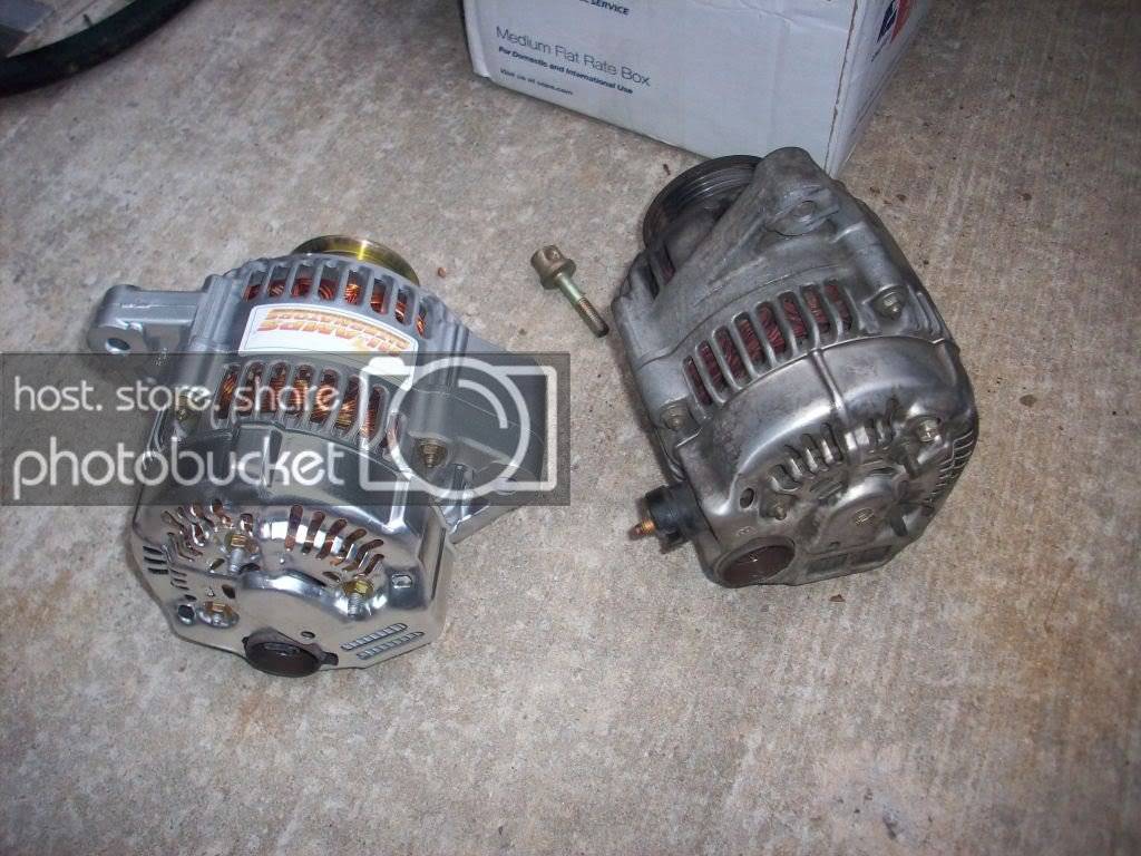

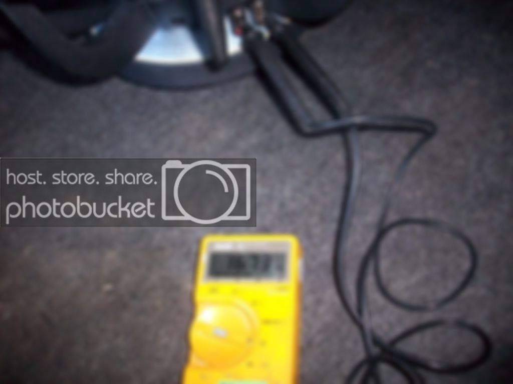

now with the second battery my voltage drops to 13 with head lights on and ac at full blast wired at 2ohms
I was driving and a wire came loose and it stop playing. When I reconnected it, it still didn't work.

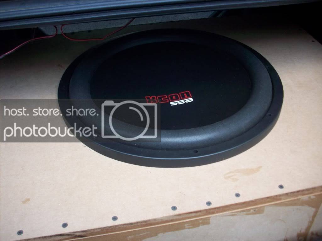

sending it in to get reconed to a d2

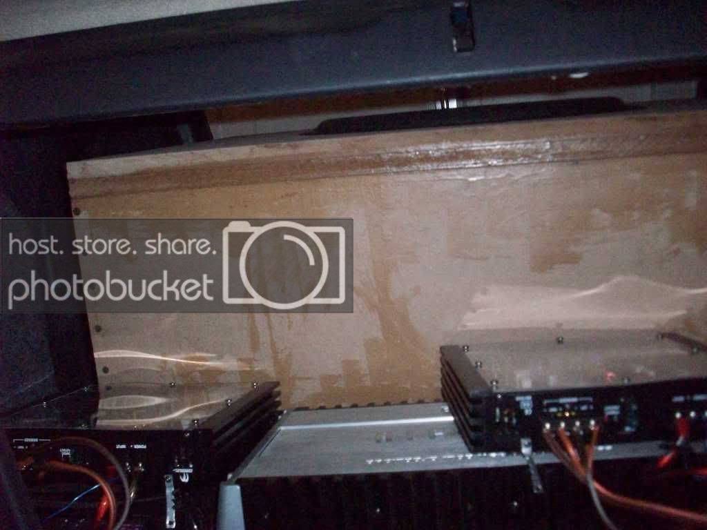

this wasn't my intended place I wanted to put them when I bought them, I didn't realize they were huge until I got them. I should have read the mounting depth. This was on the only place they would fit with out major modifications. Later I will move them forward once I learn how to fiberglass.

Oooo, you'll fit in perfect here with all those pics, I love it! The only thing I don't like is the lack of a CD player or at least a USB/Aux connection. BT streaming quality doesn't cut it for me >.
AND EVEN MORE PICS! **** those Crescendos are big. And the pics are a bit out of order, so what's the final amp selection right now? And is that Xcon only wired at 2 ohms? Is that cus it was a D4, and now it's being reconed a D2?
I just copied my build log from ssa forum. When I had a cd player, I never used it, I always used my ipod. Now I have the saz1500 & sa-8 as my current setup. The xcon was a D1 and I blew it and its being reconed now to a D2 so I can wire it to 1ohm. IT sounded great, it MURDERED the lows.
