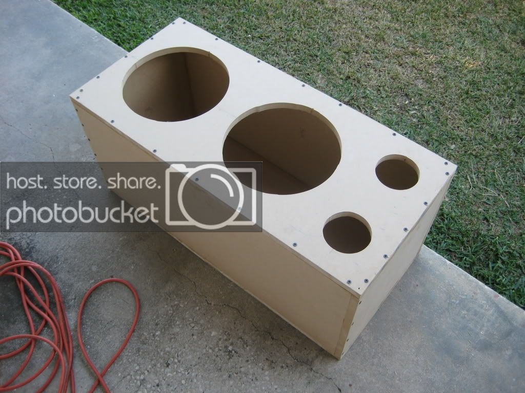

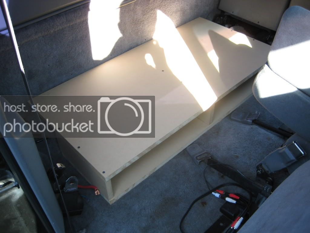

Here is my Xmas break project

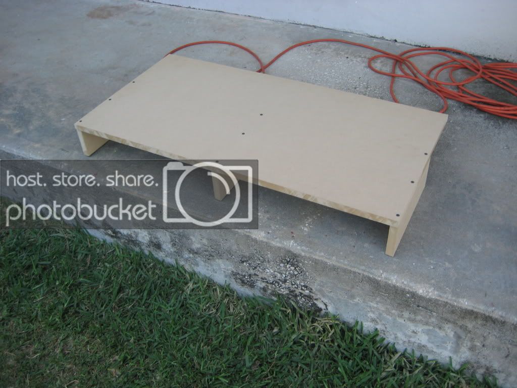

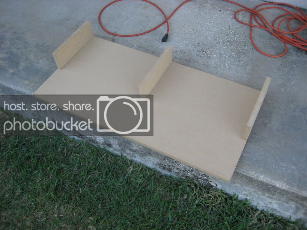

-Build a false floor to level out the back and house my amps

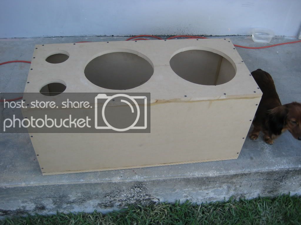

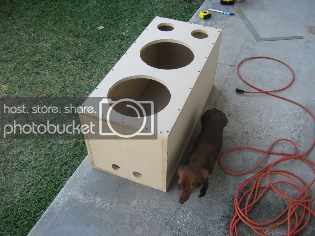

-Build a 4ft^3 ported box for my 12" Kicker comps to hold me over until i save enough $ for a new amp and subs
-Install the PG RSD component set I got for Xmas
-Sound deaden the doors
More pics will come as I finish

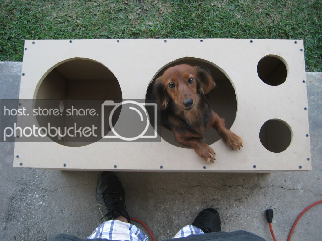

My sister's weiner dog decided to help me build everything =p
Great touch adding the dog in the box. Should improve DB to a higher level =) J?K nice job man looks good.
I was hoping she would add a few dbs lol.
Tomorrow I'm going to bolt the bottom of the false floor down, bolt the amps down, and run all the wiring.
Look good. The dogs going to kind of act as a passive radiator, right? //content.invisioncic.com/y282845/emoticons/smile.gif.1ebc41e1811405b213edfc4622c41e27.gif
Neat idea with the amps under the box. What are the dimensions of the box itself? Subs firing up or forward?

Yeah that idea came from a friend of mine. I'm going to wire some cooling fans down there so the amps don't get hot. That box is 35x16x16 and it's going to be subs up.
