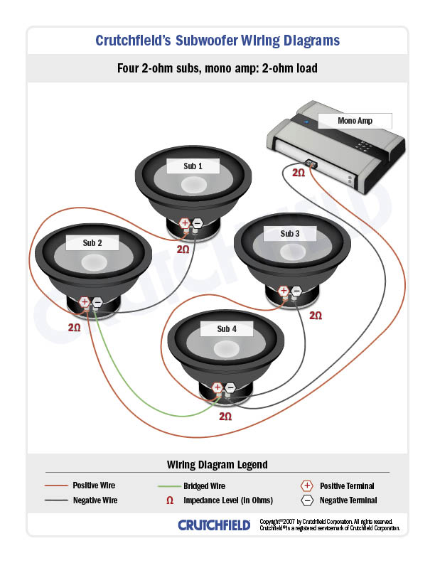

ehh probably under $150, going back to pe to check out what they have a 2ohms, since all I was looking for was an 8ohm amp, o and by the way is this diagram i made right?

What you are doing is running everything in parallel. Which makes the impedance .5 ohms.
What you should do is put the pairs of drivers in parallel, which gives you 1 ohms each. Then series the two pairs giving you 2 ohms final.
