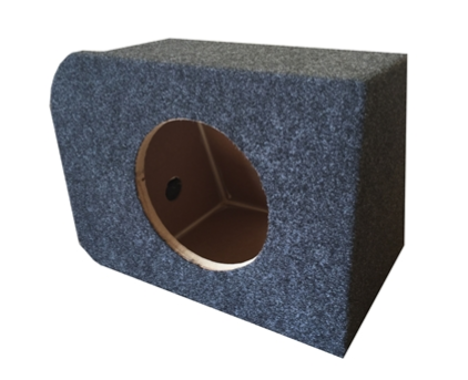

Hello all. My story is not unlike a million others you've probably all heard. Used to be really into car audio 15-20 years ago and want to get back in to it. I'm planning a small system for my 2015 Mustang. I don't want to add a bunch of weight or lose my entire trunk. For the enclosure, I think I've decided to go with the one in the link below. It's pretty compact and custom tailored to fit the trunk. I can and have built boxes in the past. I'm just not sure I want to this time around.
https://www.zenclosures.com/2015-Mustang-Subwoofer-Box-p/mustang15t1rfhalfbox.htm
For the amp, I've been looking at the RF R500X1D for the sub, I'm thinking a Sundown E-12 V.3 D4 or the 10" version. I've read a ton of good stuff about Sundown, so figured I'd give it a shot. My question is based on the volume of the box, .87 cubic feet, would it be better to go with the  10" (which calls for .5 cf) or the 12" (which calls for 1 CF). I guess essentially what I'm asking is if it's better to have a box that's too big for the driver or too small (could always load it up with polyfill).  I'd prefer the 12” personally because I like that deeper bass. But, don't want to sacrifice performance for the sake of a larger driver.

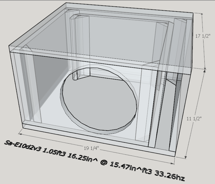

I'd throw it in a ported box, designed for your music if possible, especially with the power you're planning

I know space may be at a premium in his car/trunk but I'd find a way to fit something like this...

I'm not opposed to a ported box at all. In fact, that would be my preference. The issue(s) become then we're talking about a bigger box, which means more weight and more trunk space lost. Both of which are in direct conflict with my objectives. If I could build a ported box this size and throw one of these subs in there, I would.  What would you think about a smaller sub, like an 8" in a ported box this size?  Could I just buy this box and throw a port in the side of it?

Shredder will be able to come up with a design that will work with the subwoofer you choose and it won't be that big. He did a quick box above and like he said he could go smaller with it.

In all honesty, it's not just the size. I like how this box made to fit in that spot, so it really makes the most of the space it does take up.  I could probably steal a little width and get some more volume. But, I'm not sure it'd be enough to really make a difference.
