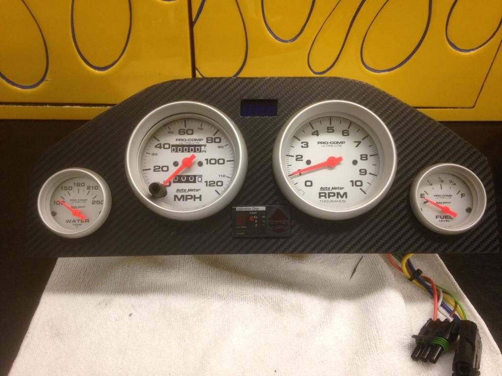

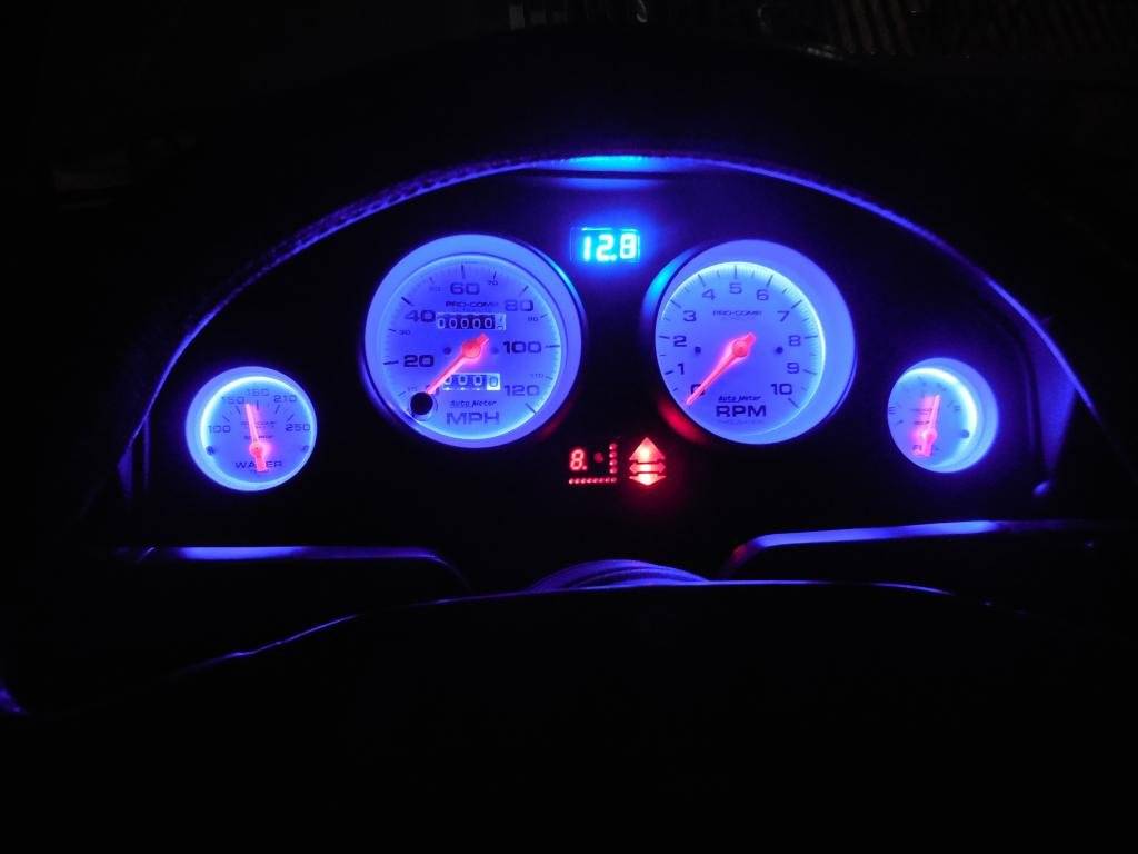

'80 VW Caddy (Rabbit truck) system, E30 dash, suspension...

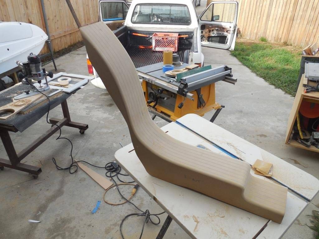

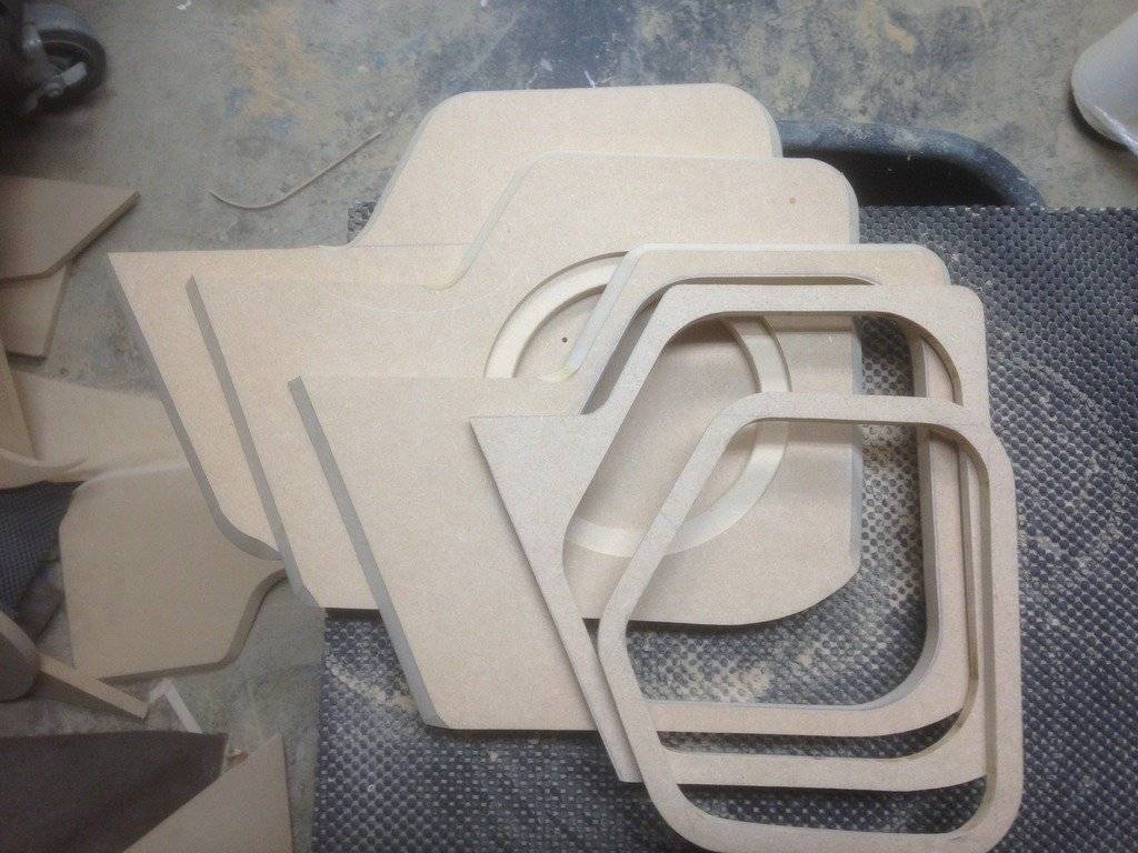

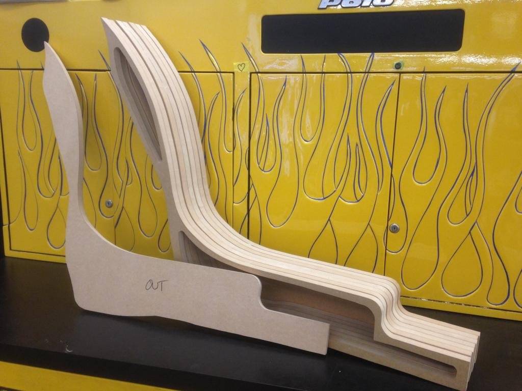

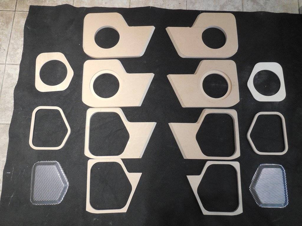

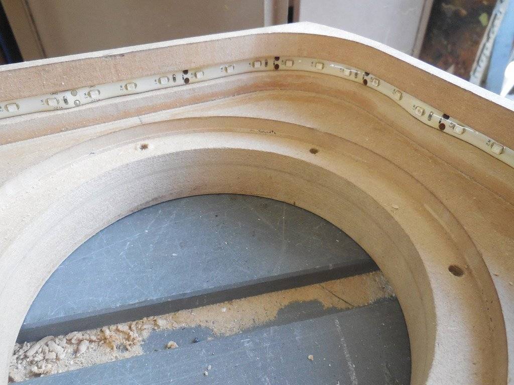

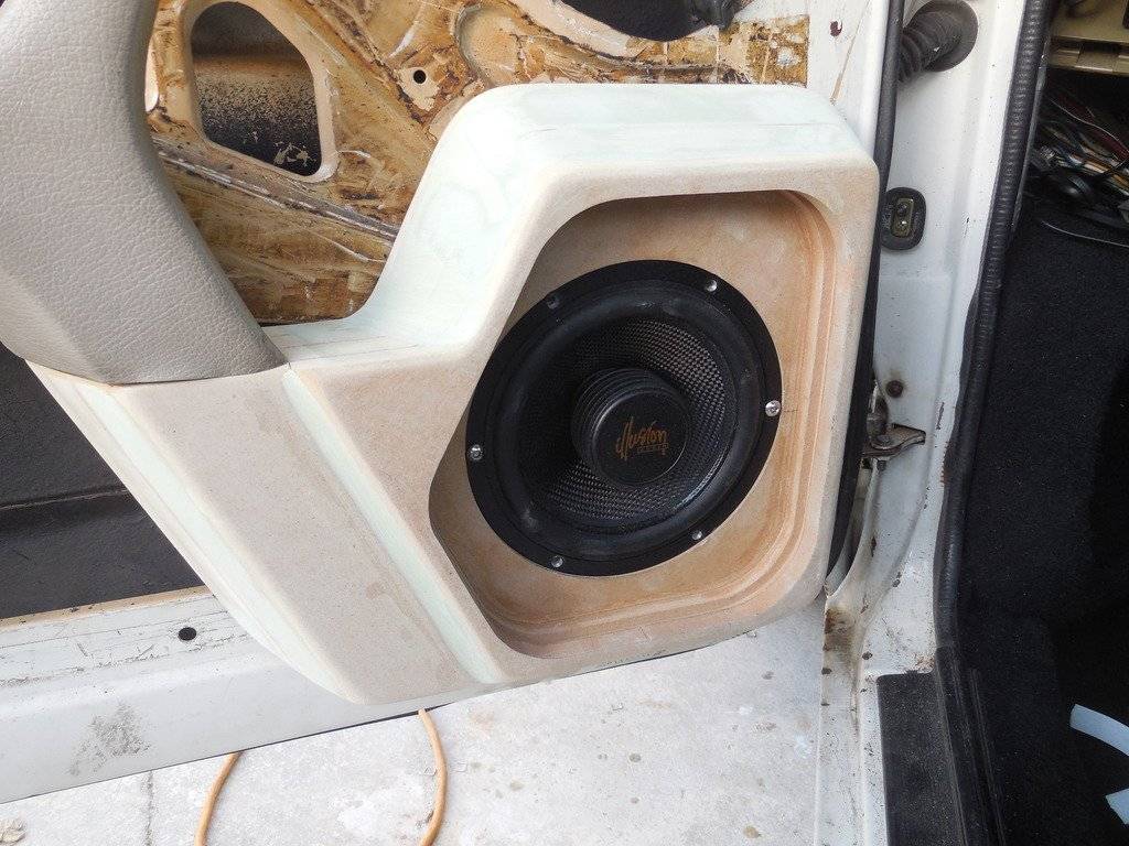

I put some hours in on the router and this is what I came up with.

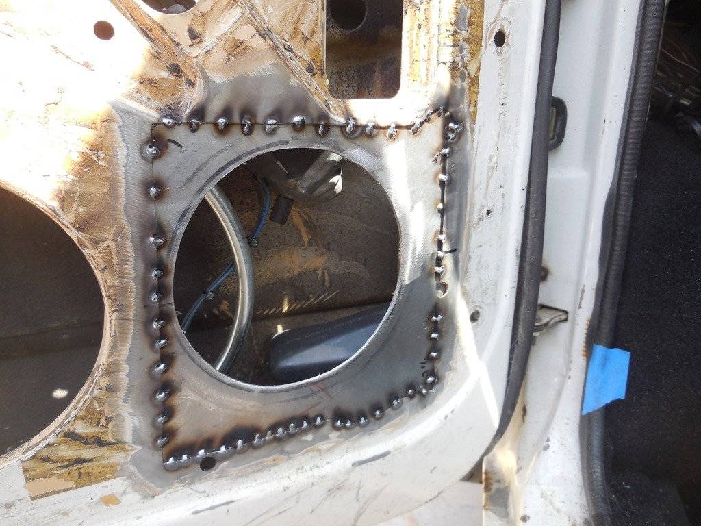

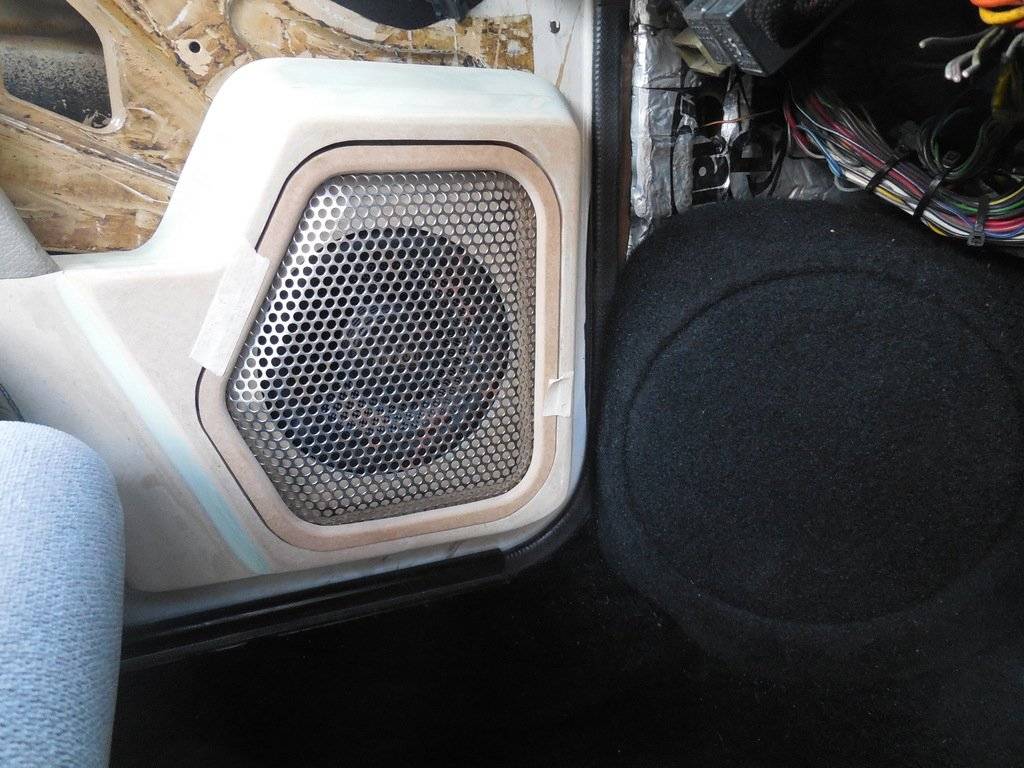

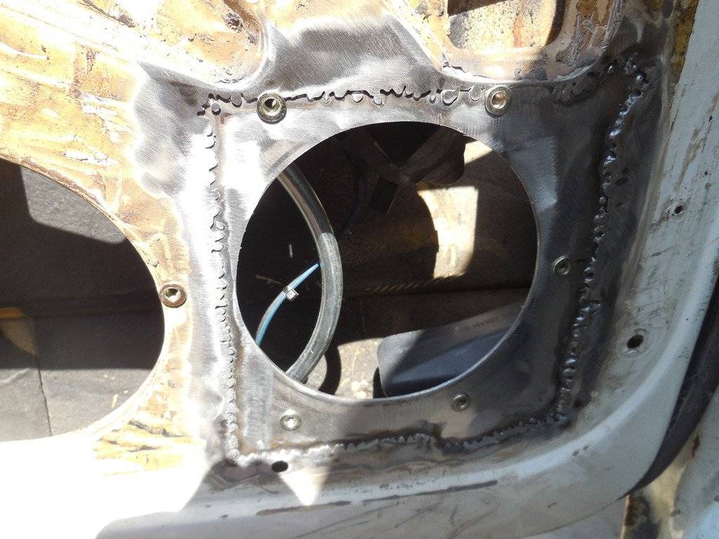

I started the metal work on the doors (still much more to do)

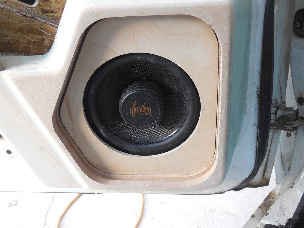

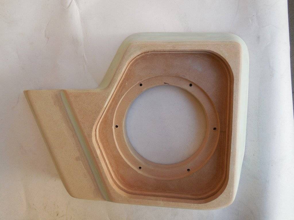

I installed six 10/24 rivnuts. The pods/speakers are attached with ss button head allens.

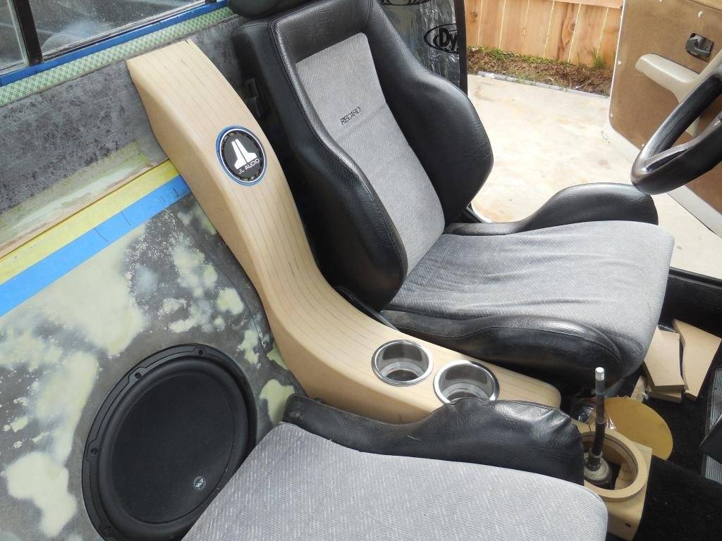

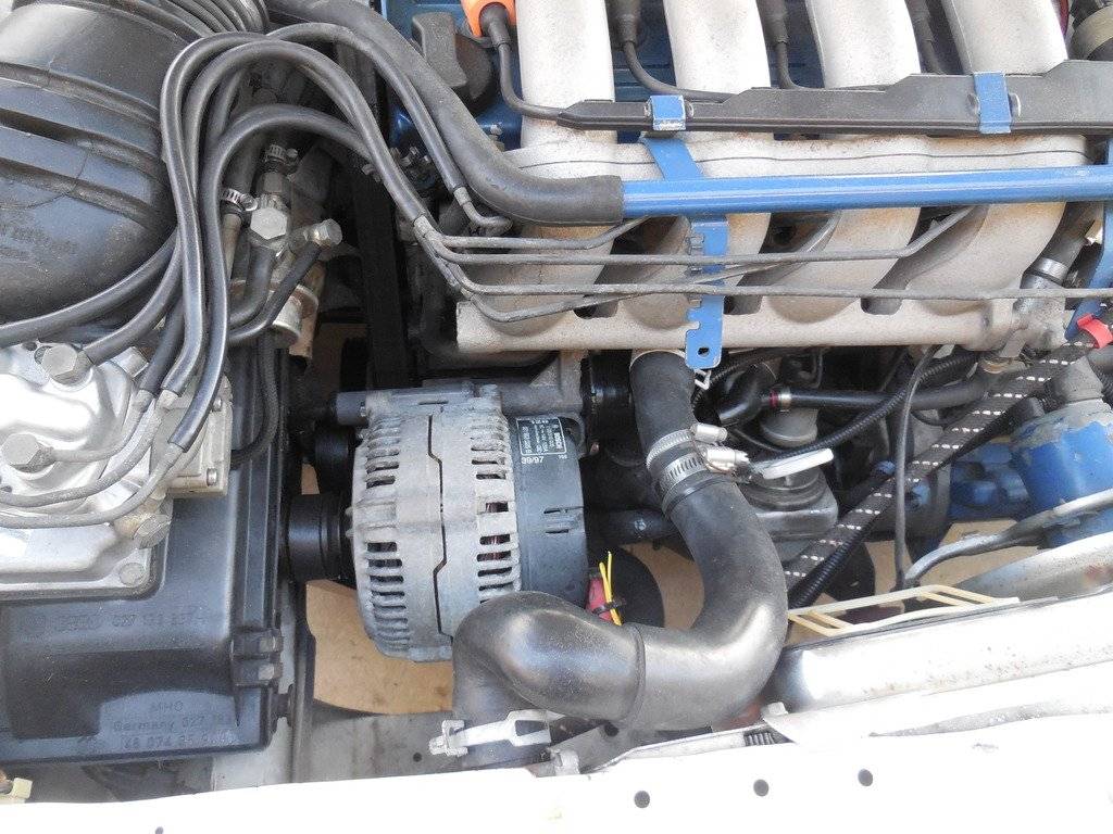

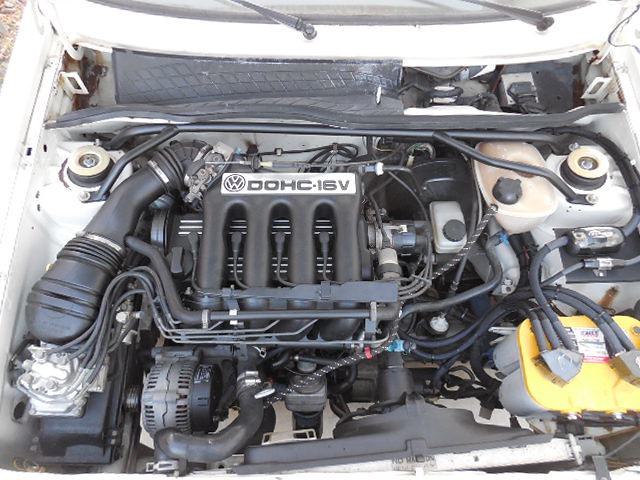

I've done some performance mods and cleaned up the engine bay. As of now the interior is still the same, driving it and enjoying the system. Too busy to work on it between  my 8-5 second job, and customer jobs right now.
