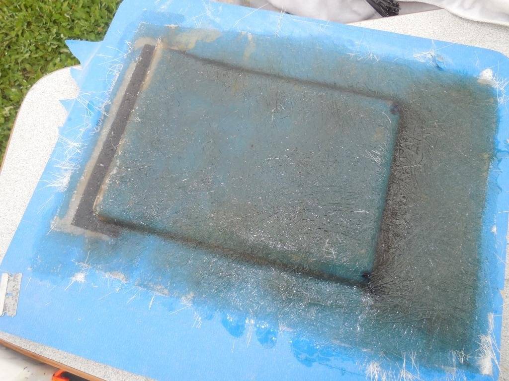

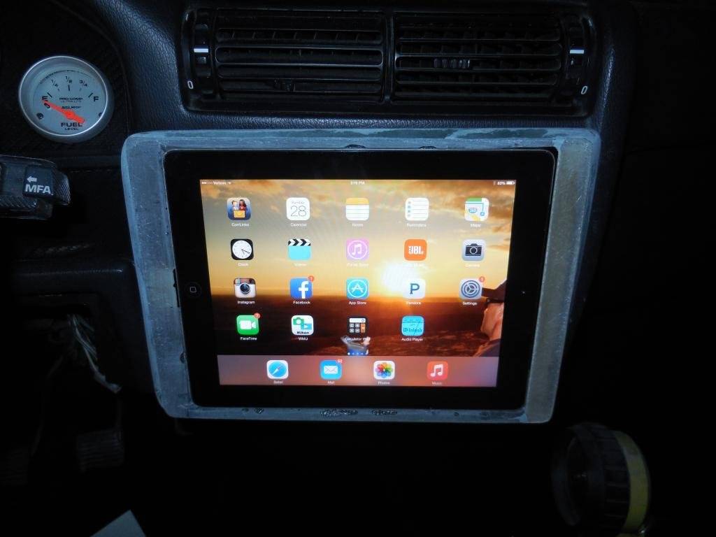

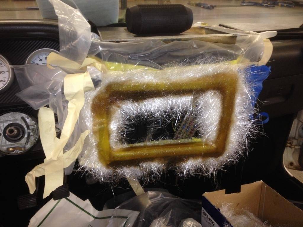

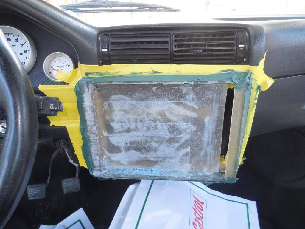

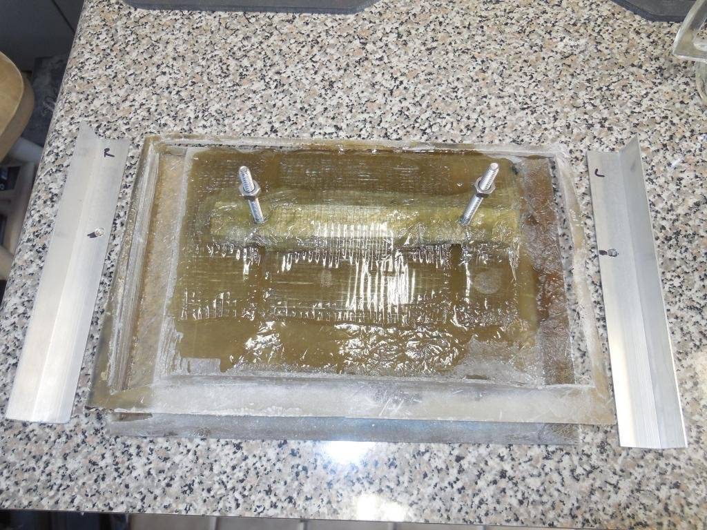

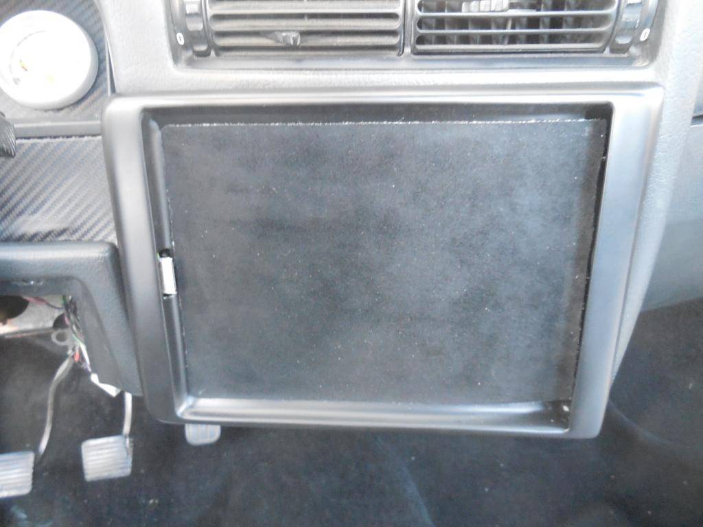

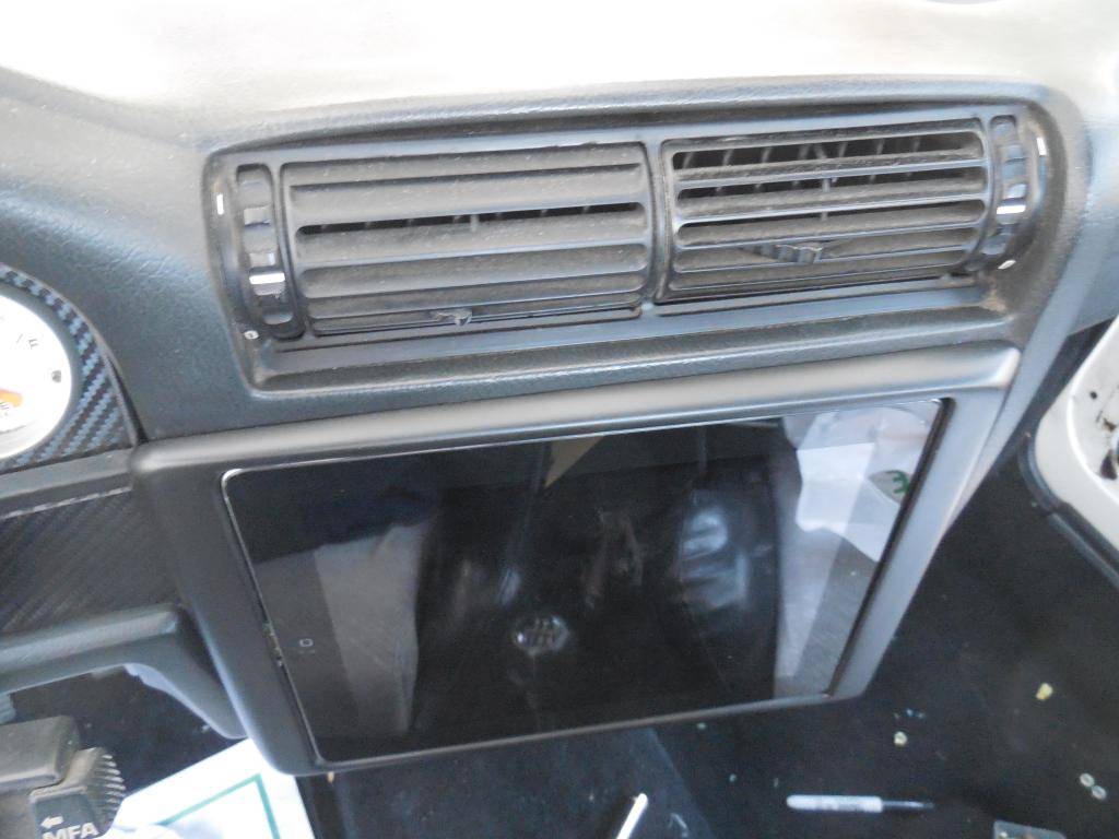

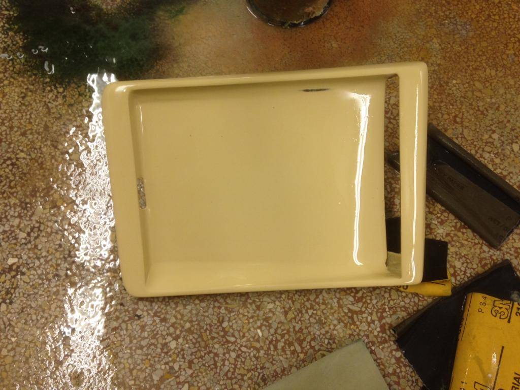

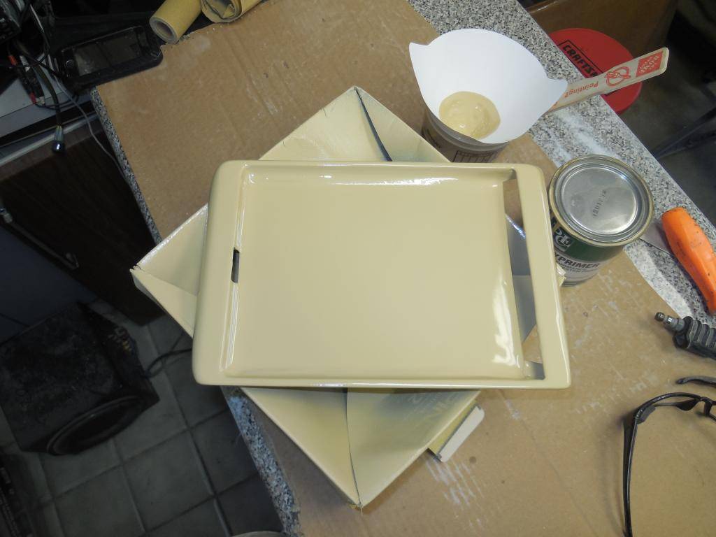

Next up is installing my iPad. First the iPad and dash were tapped off and layered up with fiberglass mat, trimmed to size then the two were attached together using Marglass. A bracket with two 1/4"-20 bolts was glassed to the back of the iPad mount.

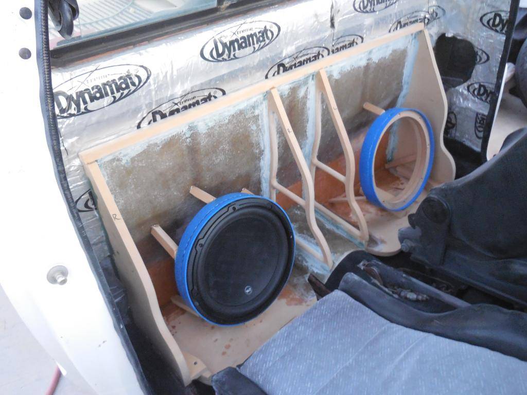

Incredible build. How are you sealed the pods to the enclosure within the a-pillar/fender?
I used a strip of rubber/foam that is used for home door jams. Hopefully it will seal along with the 7 bolts with fender washers that are being used to secure the pod to the body/A-piller.
Completely missed the bolts in post 10. Is that why the pod looks soo thick is because of the rubber/foam?
That's all glass on the pod, overkill !

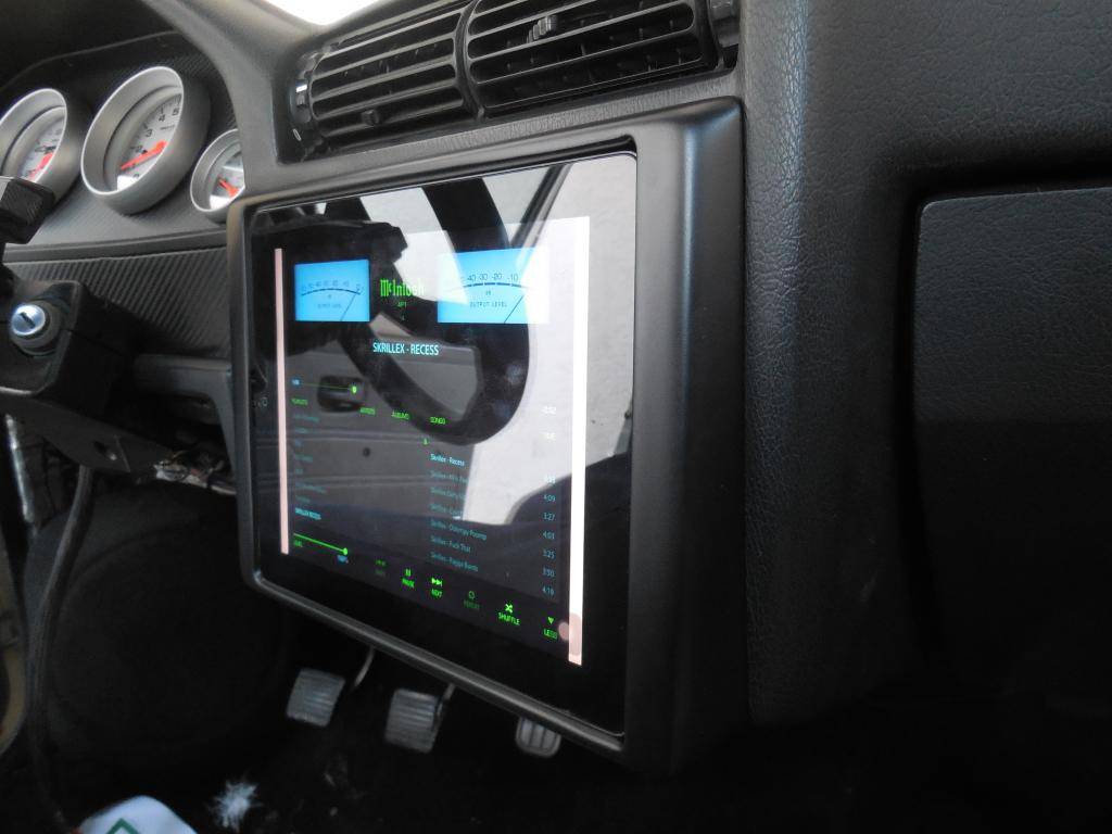

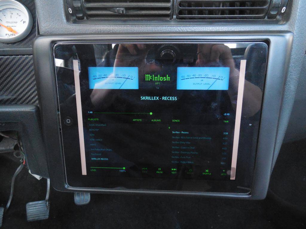

The iPad will be removable, self docking to a Schosche left/right/video out+charging cable.
