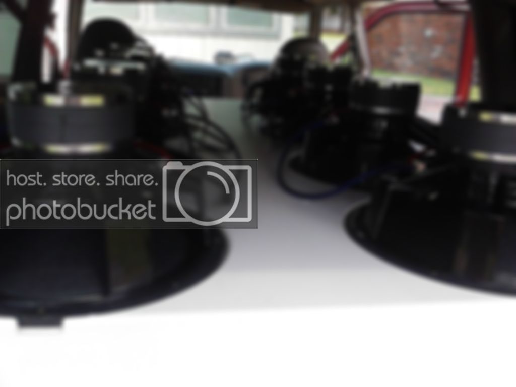

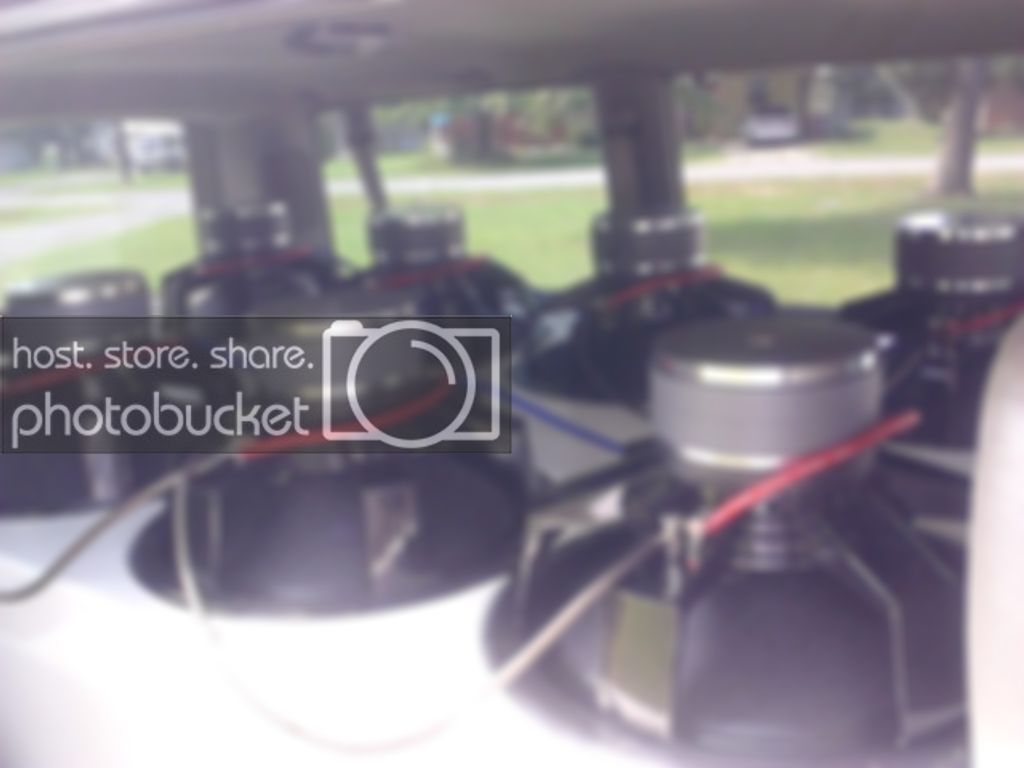

Little teaser video for you guys. Subs are seeing MAYBE 50 watts a piece, yet the whole van is flexing. Couldn't turn it up since he was in his neighborhood, but more videos to come.
I believe they were $159 for the preorder and you can buy them for $189 now that the preorder is over. I would email them for pricing though. But i'm pretty sure it's $189 for an 18.
Blake did a little experimenting today. Won't know results for another couple of days (when he gets a Sampson). Just inverting the subs lowered tuning 3 hz and raised box volume by 2 cubic feet.
The customer just bought a Sampson which is currently installed in the van. He said its just as loud if not louder than his previous setup (4th order with 6 15's doing a 155). The next step is to weld bracing to the roof and attach wood to it. His roof is cancelling out low frequencies at high volumes. Hopefully getting some hd video next weekend. But overall its an absolute beast.
