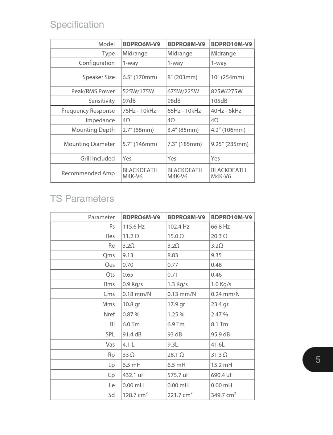

Ts parameters are in the owners manual, you have to download it under the support tab. I screen shot it and attached it so you dont have tonhunt for it

Ts parameters are in the owners manual, you have to download it under the support tab. I screen shot it and attached it so you dont have tonhunt for itView attachment 44772
Fs of 102hz is enough to say you aren't getting bass out of them a 93db spl efficiency rating means they will be very efficient and loud in their preferred frequency range.
Efficient is great when you want to get loud but they aren't balanced speakers when it comes to frequency response
The high efficiency and high fs is due to a light undamaged cone, which contributes to that awful "hot" sound you get from PA speakers. There’s enough of that crap in the car audio environment as it is.

So that kick me back to the big money morels as the should be more balanced as they are an audiophile speaker
The guy wants bass from door speakers those aren't gonna come even close to bass ranges. Closest midrange that can dig deep is likely the sundown vex8.
