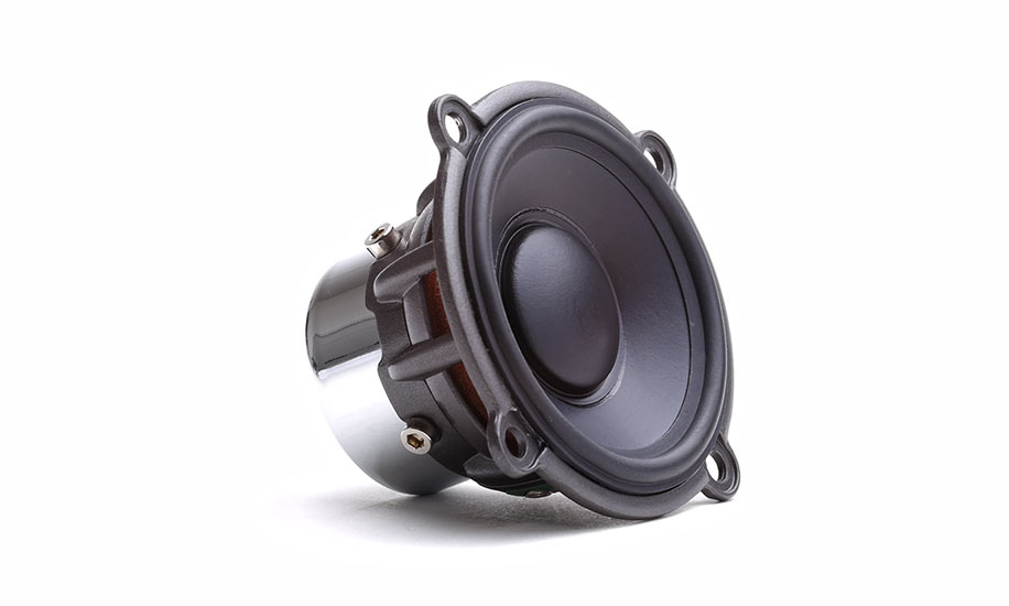

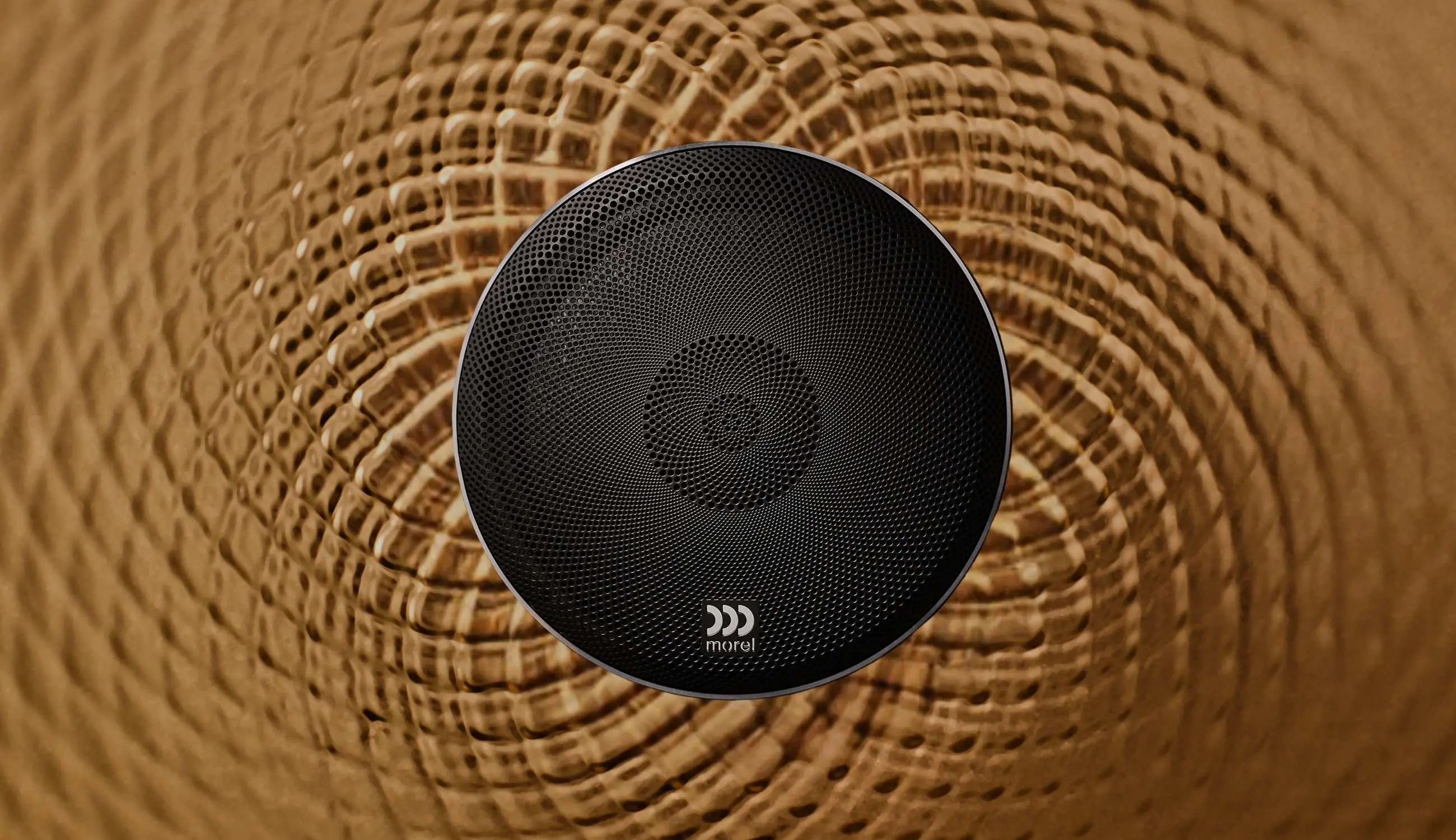

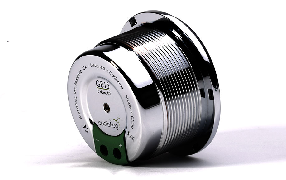

Theres not a ton of options out there but I've found two maybe three that I like. Ones a big money morel setup the other is a reasonably priced pa style speaker. Looking for some advice as I would be purchasing without actually listing to either potential setup first.
Option one:
Vibe audio UK BlackDeath 8 Inch Pro Audio Midrange with a tweeter, probably the matching 4.5" compression driver.
Option two:
Morel Elate Carbon 3-way
Option three:

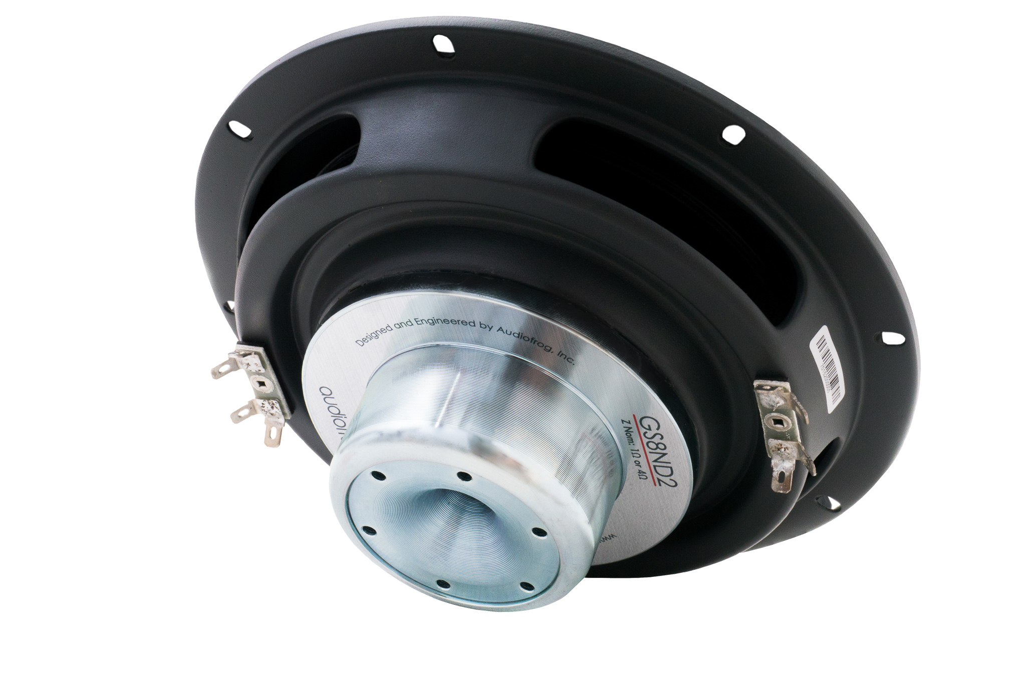

Some sort of 3-way set up using the audi frog GS8ND2 Shallow Woofer
With the mid and tweeter along these lines

The audiofrog 8 isn't really a good midbass from what I'm told more like a mild 8inch sub.
