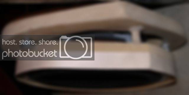

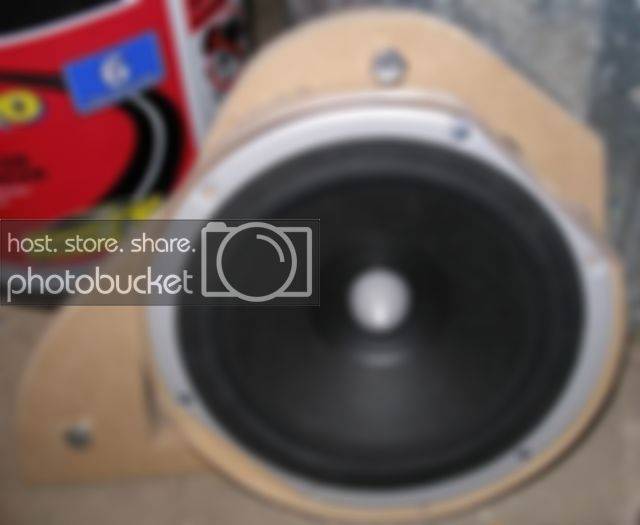

I am working on my door pods right now to fit a 8" driver. Mine is used from 50-1.6KHz though. This is my first crack at Fiberglass as well, but so far its been easy.
