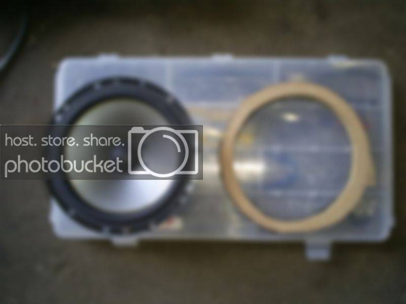

If you don't have the nessacary depth then you will have to make some baffles out of mdf like this picture but for the shape of the speaker you are trying to fit ie oval and not round like these ones for my 6 1/2's.
you can also check out my door speaker build log for ideas...
http://www.caraudio.com/forum/showthread.php?t=248366
just dont go crazy and hack the door panel like I did.
