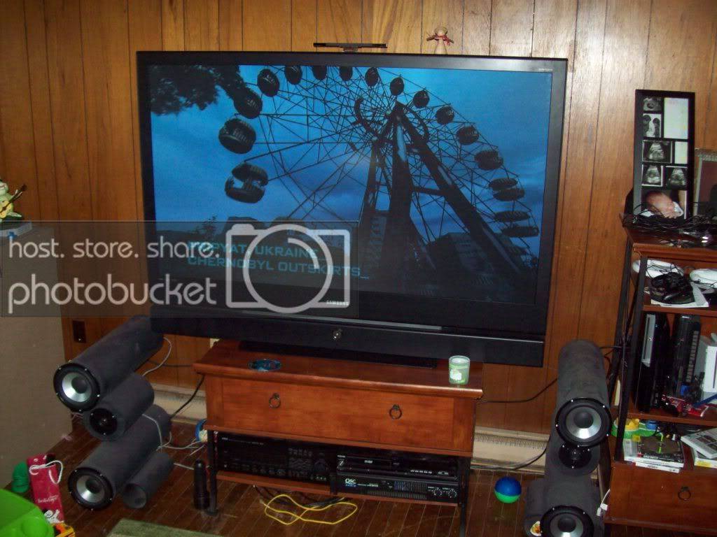

basicly, the plan is to replace that tv stand as it doesn't like the new tv, and replace it with the box for the 18. so i don't wanna go to much bigger than that.
