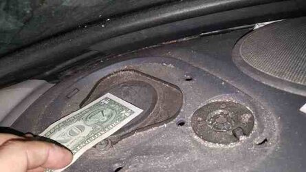

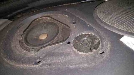

Dashboard with 4" speakers and 1" tweeters. not sure about exact size

I dont know what speakers will fit my dashboard
