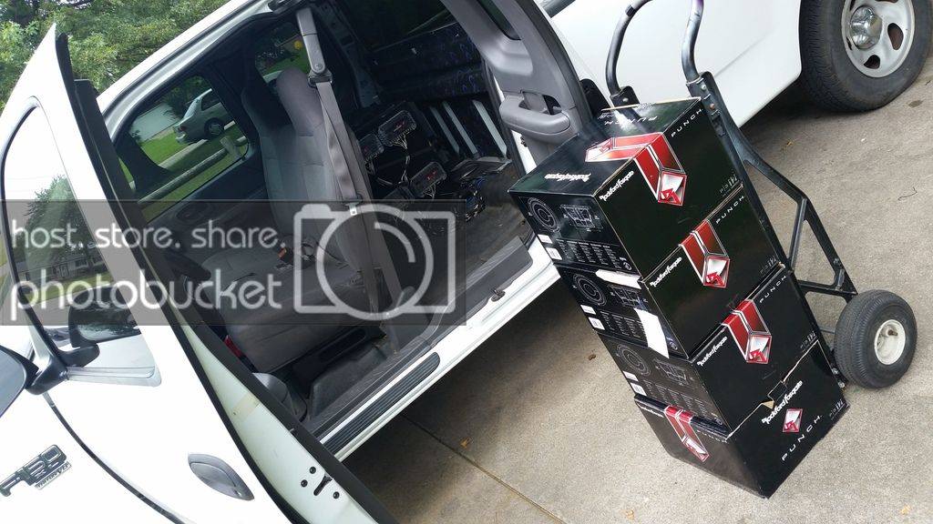

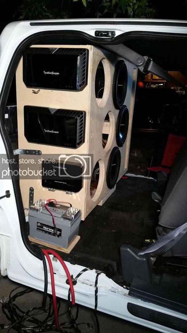

Whats up guys, have been scarce on here recently mainly because we have been doing several large overnight builds ( not completed over night, just working all night on them)
This is James Mcanally's Ford F150 and here is 8 days of work put into it so far, he's been driving here from Oklahoma about once every 2 weeks.
The Goal, total musical setup, from lows to 50hz+ able to hit kick drums on metal and hit the lows of slowed music. And thats what it does

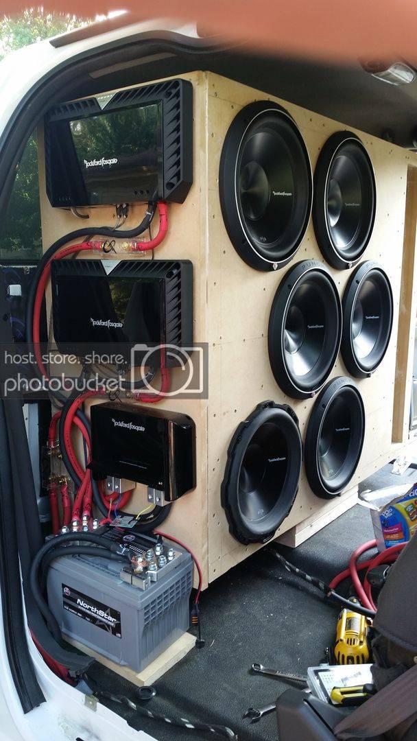

6 RF P3 12"s , tuned to 36 hz, enclosure dialed it to driver specifics to be fully musical and not hold back good SPL

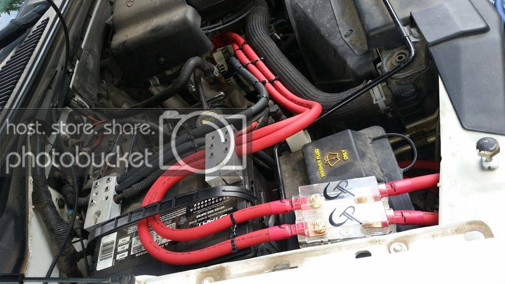

2 RF 1500.1's

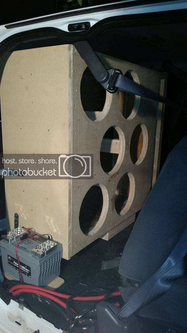

1) Northstar AGM34 as a rear bank

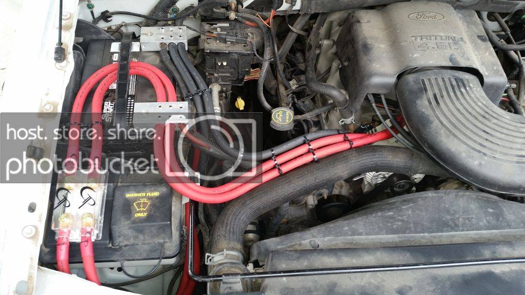

GP OFHC wiring
GP STFU 250 mil on roof and doors, STFU V1 already applied on back wall over a year ago.

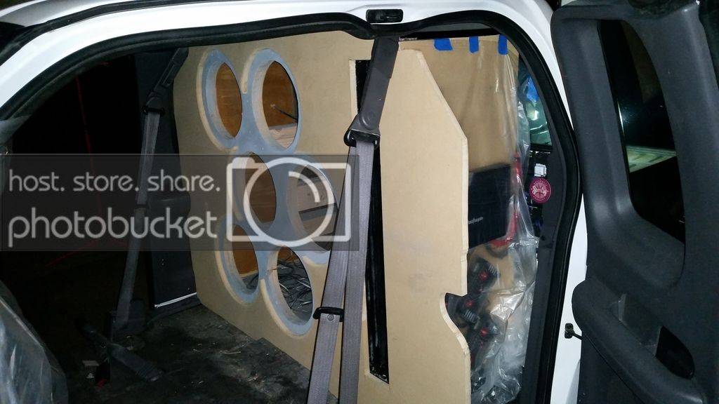

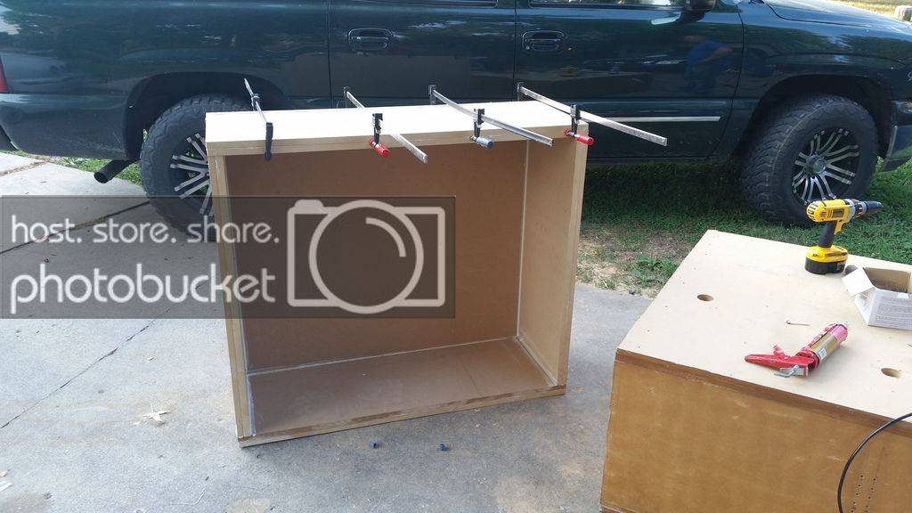

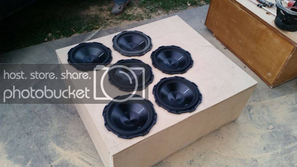

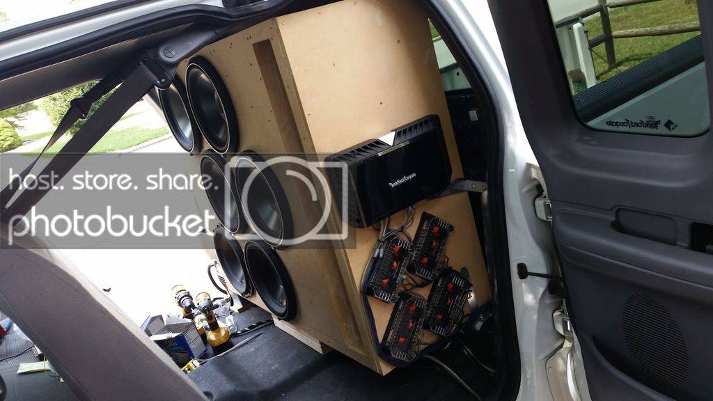

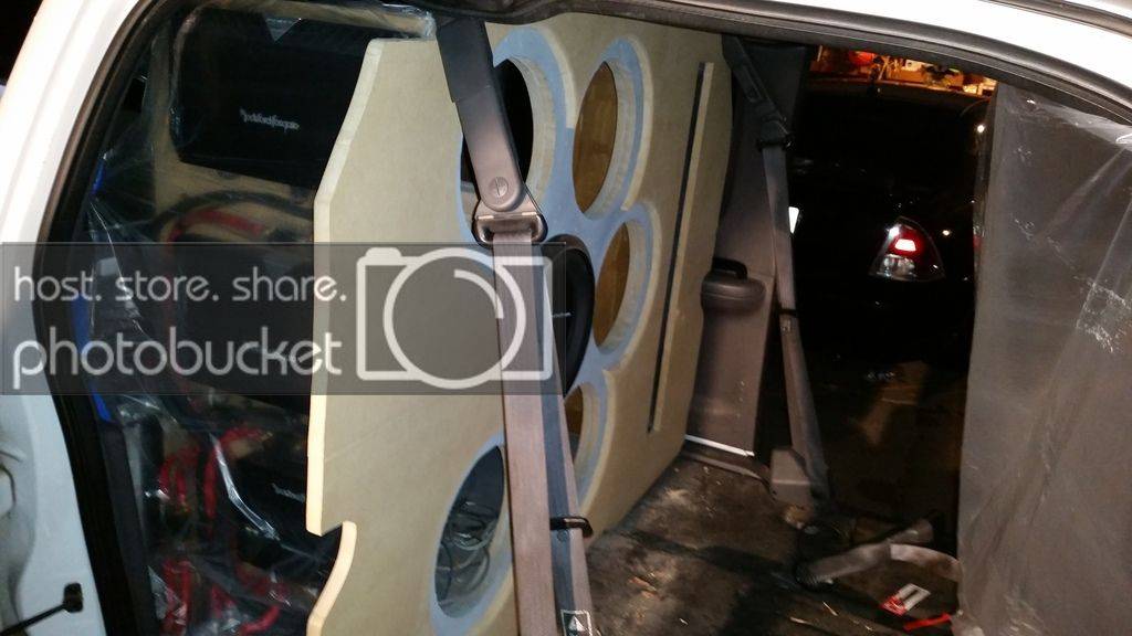

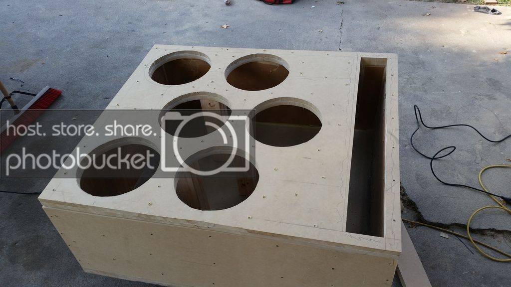

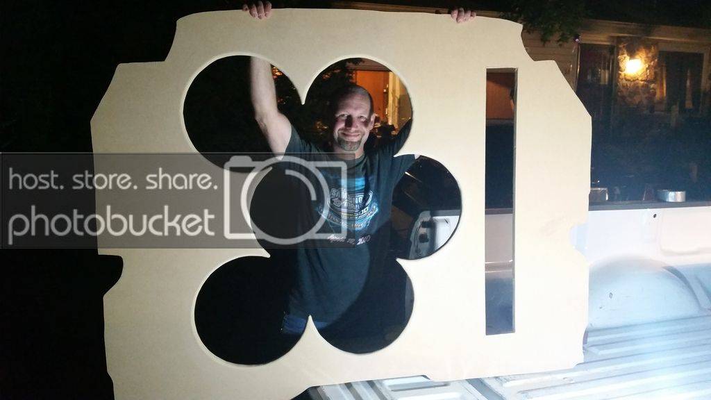

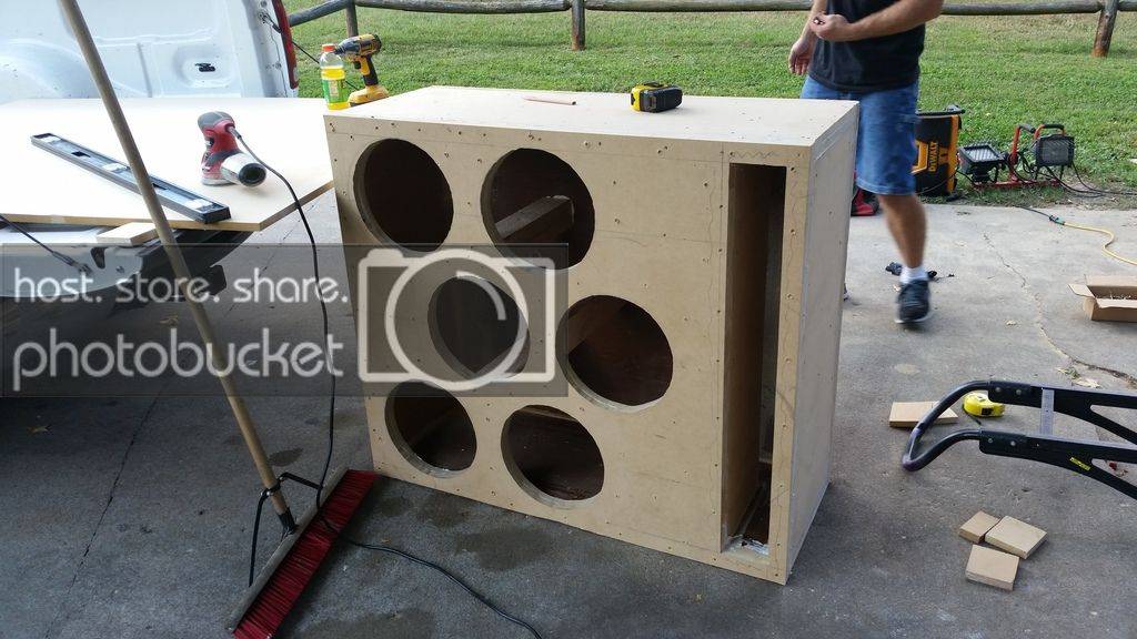

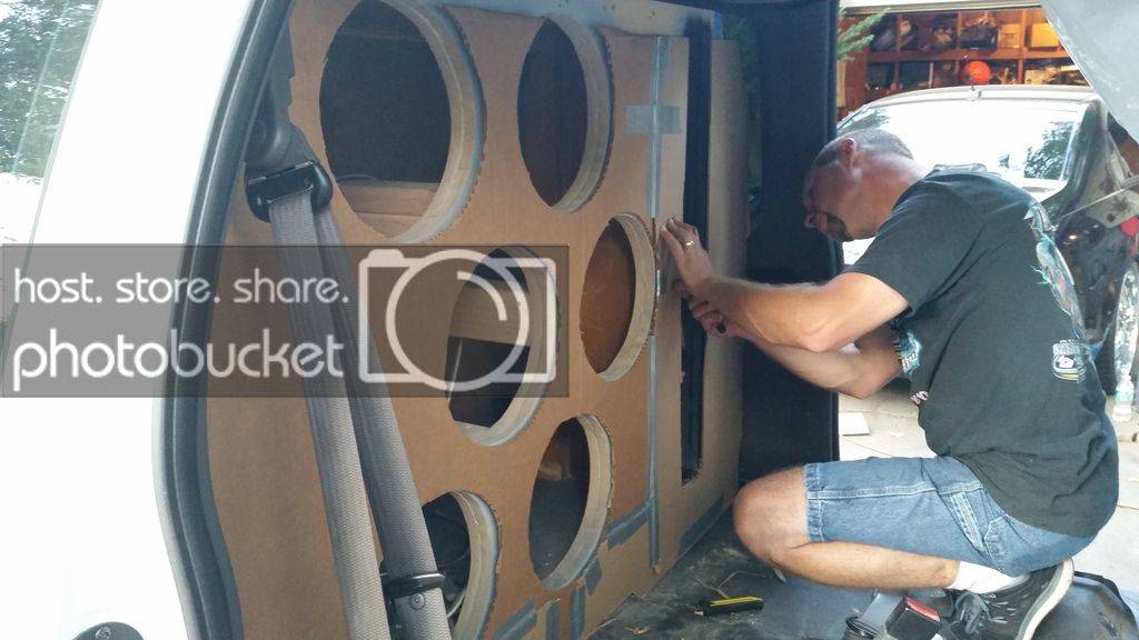

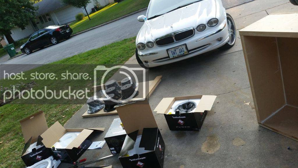

We took measurements of how large the shell of the enclosure could be and James had to go back to oklahoma so another team mate and I got everything ready for the test fit

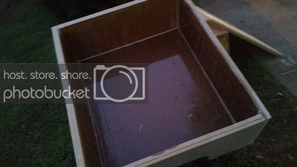

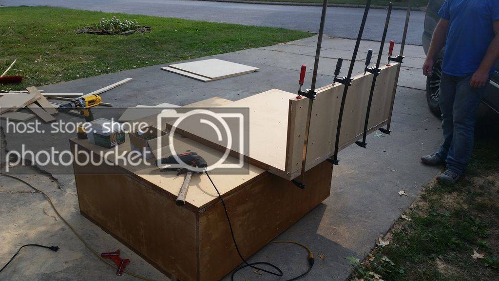

A thick coat of "coLD" mixed resin and continued to move it around as it soaked into the MDF, cold mixed will give you 30 minutes of play time VS 5 to 10, this allowed the MDF to get good and soaked with slowly curing resin

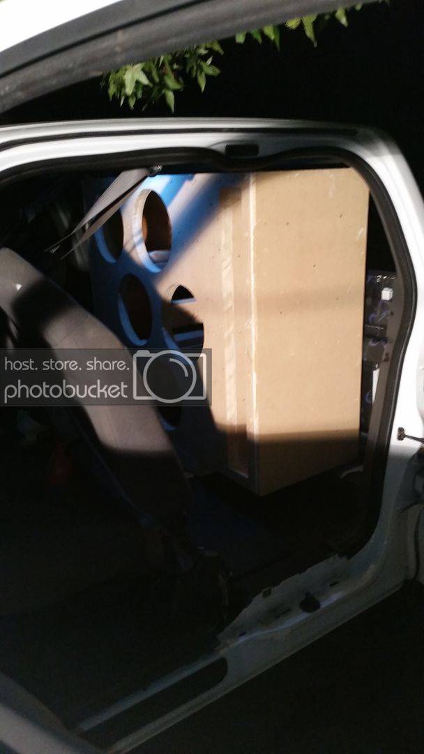

Test fit

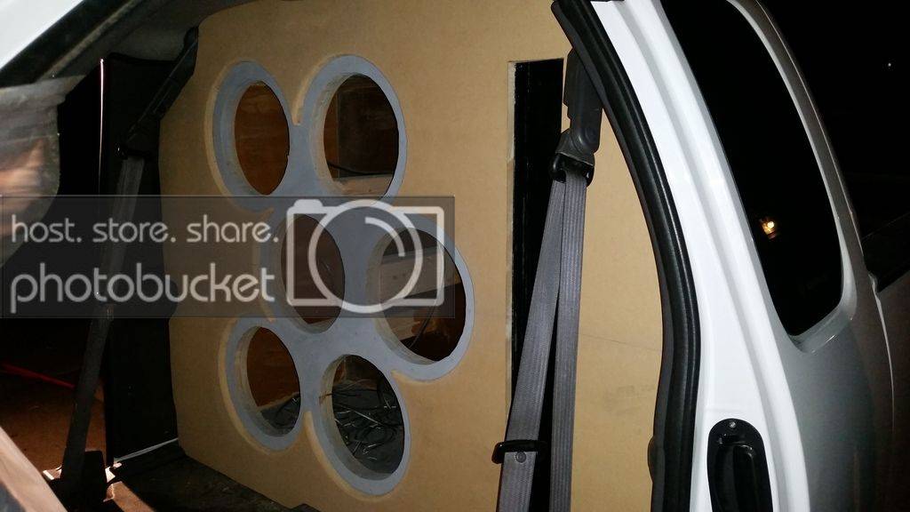

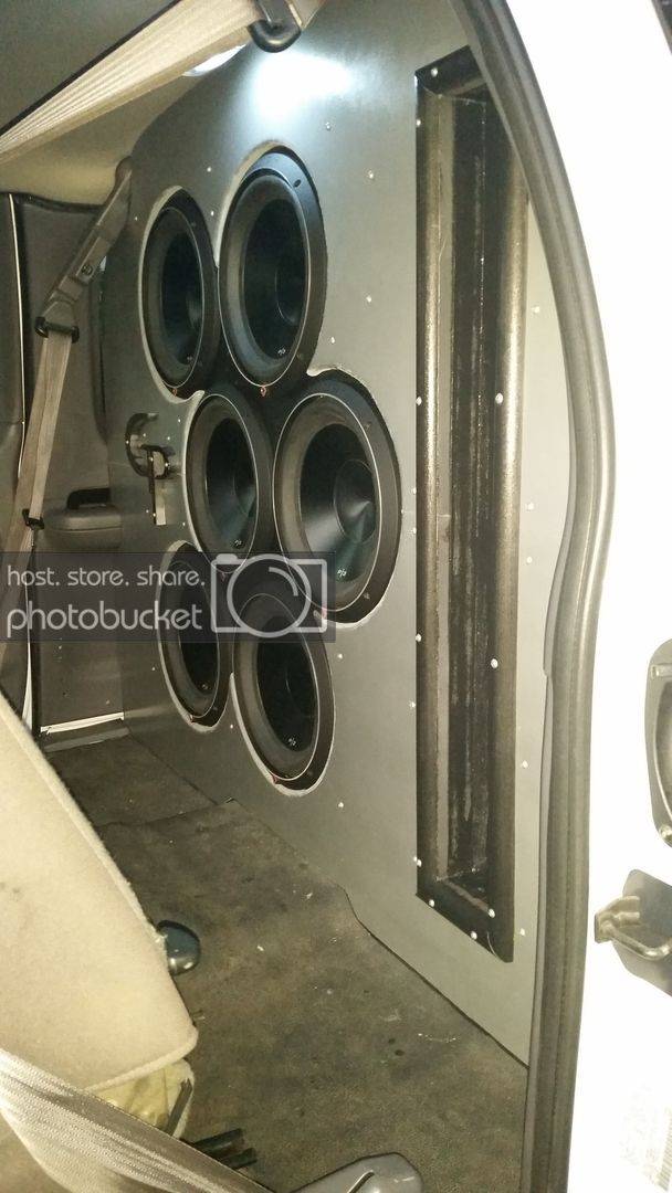

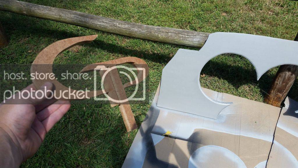

Lost the router jig, and everywhere was out of stock so cut the holes by hand then later smoothed out the cutouts with a sande. being on such a time crunch had to make that compromise.

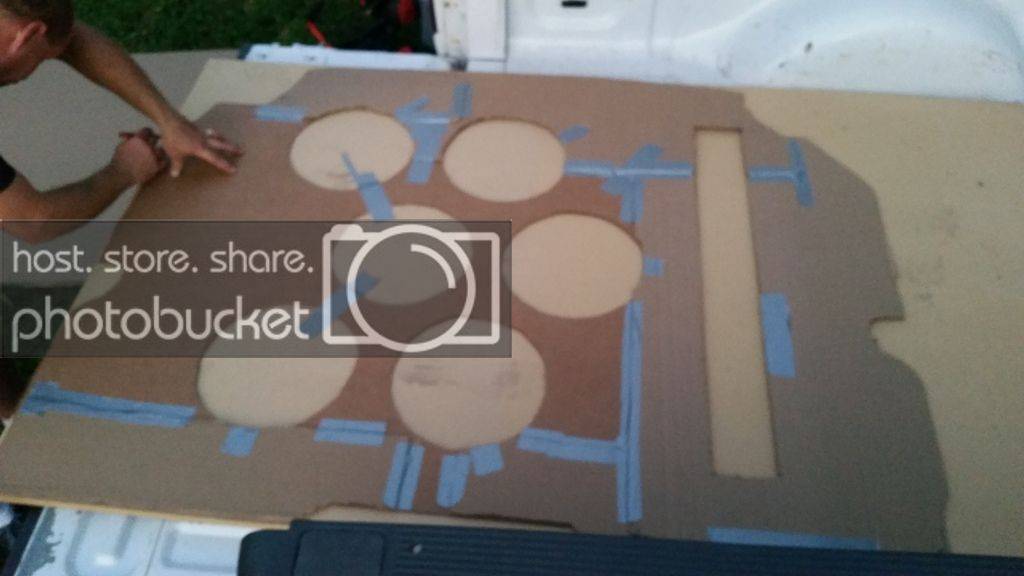

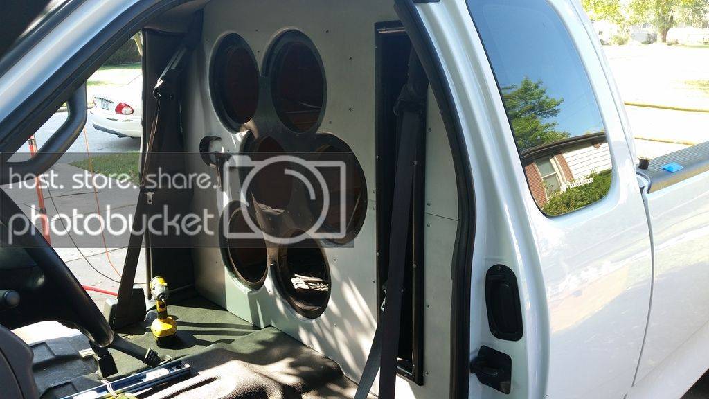

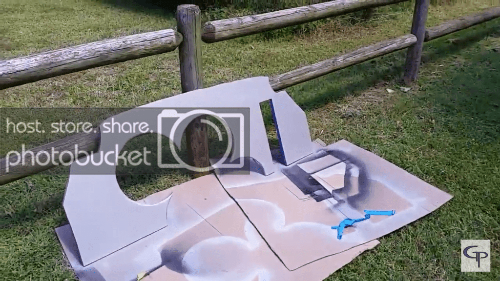

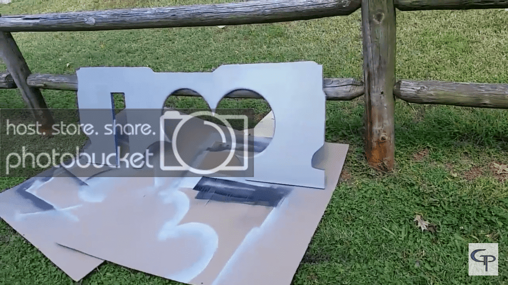

Now to seal it off, we took large cardboard sheets and made an exact template of the outer area of the vehicle around the wall
Cutout complete

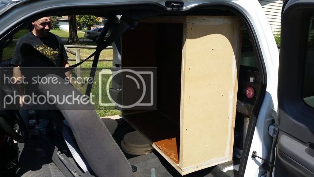

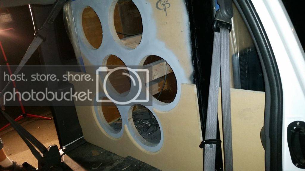

Test fitting the sealed off section
LIKE A GLOVE
the 2 panels locked in the center bracing the roof and floor

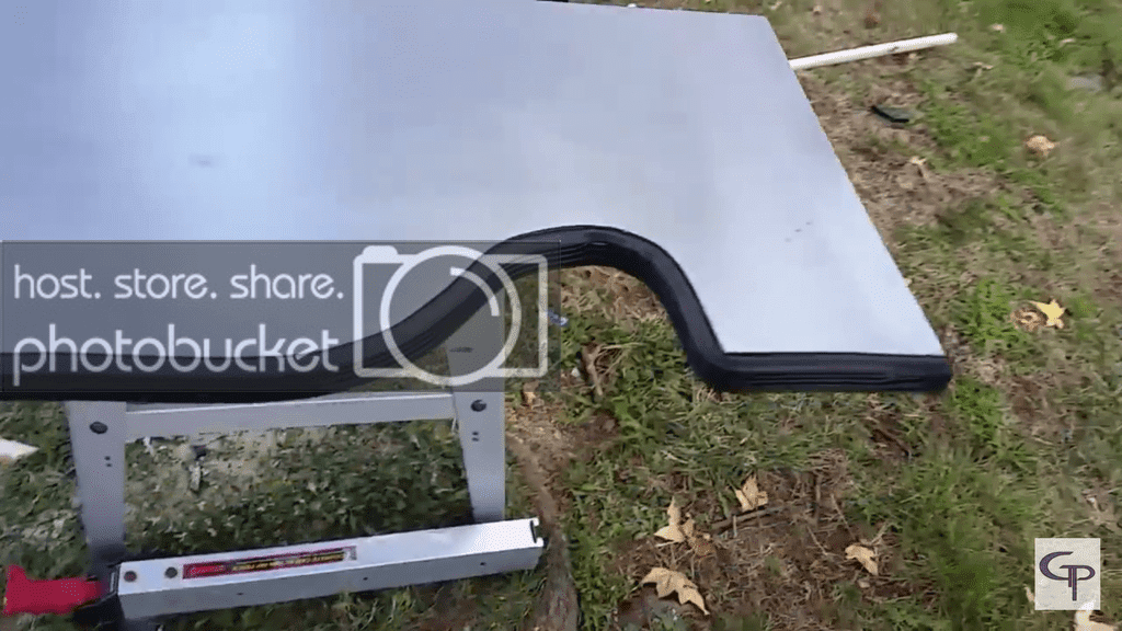

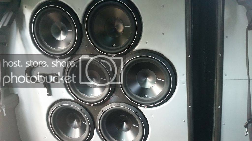

Primed and painted hammered silver

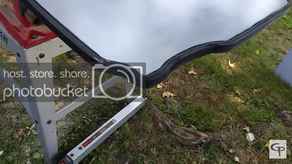

Sealed off fully with some real nice weather stripping, used a staple gun about every 4 inches or so to help hold in place with the glue

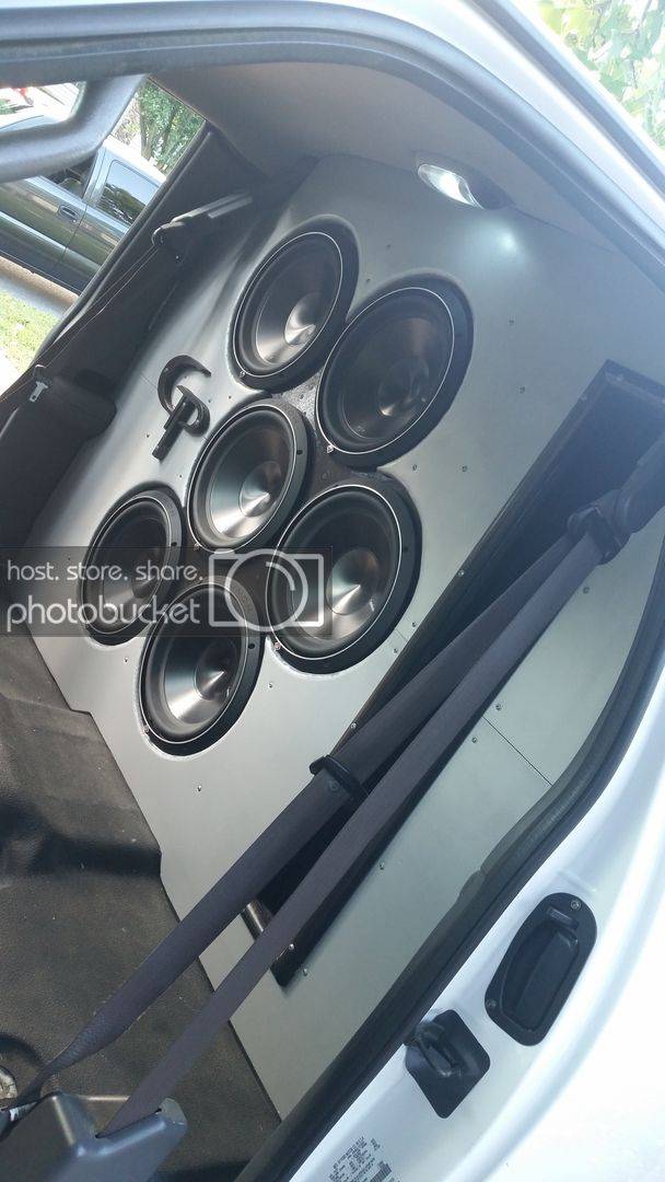

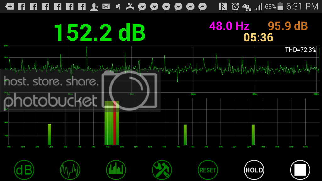

The full setup is 2) RF 1500's powered by one Northstar AGM34 as the rear battery bank. I do believe the RF 10 farad cap is bottlenecking full potential where the setup stands now, but nonetheless, not being 100% finished its doing well
here was a quick metering, as we get things dialed in we will be closer to the 155 mark, Not bad for RF
This is the SPL LAB on android which is reading 1db lower than the Termlab magnum based off of multiple team member meterings on the SPL lab vs the magnum. So on the magnum this will be at a 153+ where it stands now.

fully musical build plays a huge range excellent, quarter wave measurement to the meter location on the dash was 48hz on the dot so all numbers lined up well.
