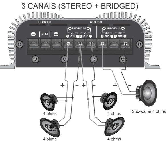

Amp everything on the front wired parallel together on channel 1 and 2. Bridge channel 3 and 4 for a low powered 4 ohm sub. Leave rear 6x9s on head unit power done deal. Simple.

If I go this route, I can wait on the sub, for now just the items you listed included amp. Do you think I can safely power all four speakers off this amp, or at least the front two speakers and leave the rear unamped until I get a sub in the future. I like to listen to the radio when I am working outside with the motor turned off.
If I power four speakers off the one amp I just run the rca to the amp from the head unit and the wire back to the front on channels 1-2 and the rear 6x9 to channel 3-4? Thanks again for the help just trying to make sure before I start ordering parts

I beleive this will be my sub set up ,minus the 6x9s when I get there. For wiring the two 3.5s and two 6.9s Ill just wire them up across the board.
