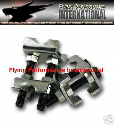

Is there a good way to get rid of some of the rear sag in my stock COIL spring truck, and get some ride quality back. I was thinking either some lift assist airbags (if cheap) or maybe just a simple coil spacer in the rear would do it?? Or those spring lifter things Ive seen at vatozone??
Don't half as s it. Those will not doing anything except get rid of the sag for a few weeks maybe. I've seen those used and break springs. The "bouncy" feeling will either stay the same or get worse too. Now think if your taking a corner and the spring breaks . . . have fun. And for the air shocks also be careful as those put weight sometimes where it wasn't meant to be, not to mention the ride quality will be greatly effected. Either buy heavy duty springs or bag it. But if you check the shock mounts and they seem strong enough use air shocks if you can deal with a "bouncy" ride
