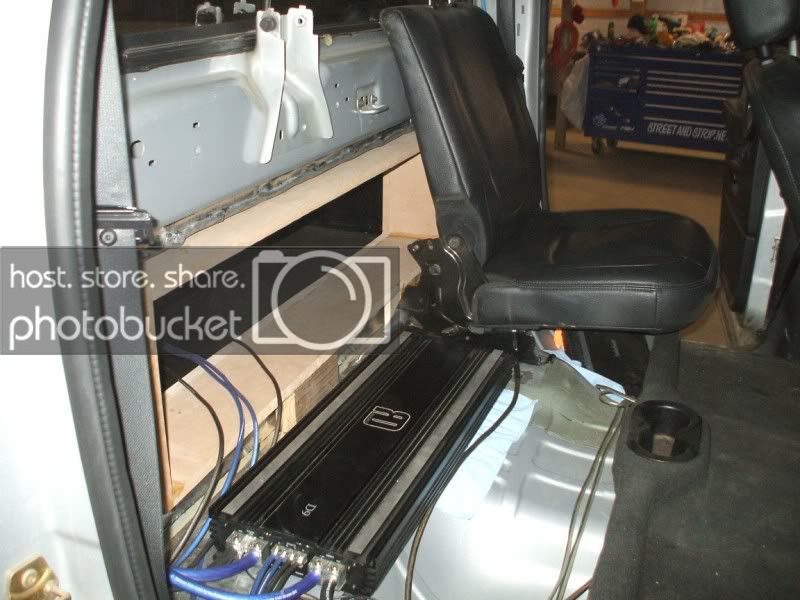

Try placing something in line with your port that extends further out than the port itself does, just as an experiment. It may lower your tuning slightly, but it may stop your subs from being overloaded, or move the frequency that it occurs out of your needed bandwidth.
I was thinking about this as well (even going the entire length of the box) to cut down on cancellation.
Consider this too. The hole in the cab for the blowthrough is about half the size of the opening in the box for the clamshell. Could that affect things?
When it was further away, it sounded bad (even with two subs, which always sounded good, on all frequencies) so it's as close as it can be right now.
I haven't done any troubleshooting yet, but I will Tuesday.
The deciding factor I think is going to be that inner port wall, and I might want to seal it up against the cab like so...
But then again, I don't want to lose any more area that's venting into the cab, since the hole is already half the size of the box opening.

I dont think this is your freq problem, but you mentioned the subs looking like they were playing out of phase sometimes. Your port mouth (inside the enclosures) is not symmetrical about the subs, is it? Im amazed how many people dont think about this when designing enclosures. The sub mounted closer to the port will unload faster due to less resistance on cone motion, and this difference in resistance between the subs creates the uneven excursion you mentioned seeing. This also creates a situation in which each sub perceives a different interior enclosure volume, thus altering tuning between the two subs in the shared chamber, making over all freq response erratic.
I agree I think a baffle board between the two enclosures would be a good first step in troubleshooting this issue.

I mostly noticed it on rock, but I solved the problem.
The RE's are the older style, FWIW. Supposedly have a better build quality than the new RE Audio stuff, although these lower end RE subs are all made in China anyway. I'm happy with them now, they play **** low, but because they don't require such big boxes (1.5 for each in my box) they also are really punch and not boomy (as long as you set your amp correctly, unlike how mine has been for months now //content.invisioncic.com/y282845/emoticons/crap.gif.7f4dd41e3e9b23fbd170a1ee6f65cecc.gif)!
Wow really? I had no idea. But wouldn't that be the case with all ported boxes out there where the port is on only one side?
I did the extended port wall about a week back and it did indeed clean up how the bass sounded. But what really made an impact was when I went over all my setting on the amp again. Apparently I didn't know what I was doing when I set the amp, I had the LPF too low and when I raised that to around 100, it really cleaned up the sound. I guess I set the LPF really low to counteract how it sounded weird around 60 Hz. Still doesn't sound great that high, but I don't listen to much music at that frequency. But bass is a lot more punchy now, not as boomy, and rock sounds great.
Yes, really. And yes, it happens on all non-symmetrical enclosures/ports where multiple subs share a chamber.
If it makes you feel any better, ideally anything above 60hz should come from your front stage anyway. Time to start thinking about beefing up your midbass (and yes, tweeter, I remember your tweeter thread too). Dont worry, you are making a natural progression in car audio.
