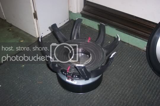

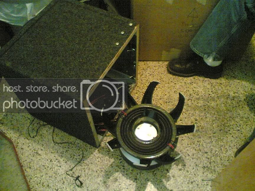

My MTX 9500 was broken yes, was broken! I know it sound impossible, so my advice is get a support for the magnet. The frame broke off & cone rip off also.
Here before
AND after

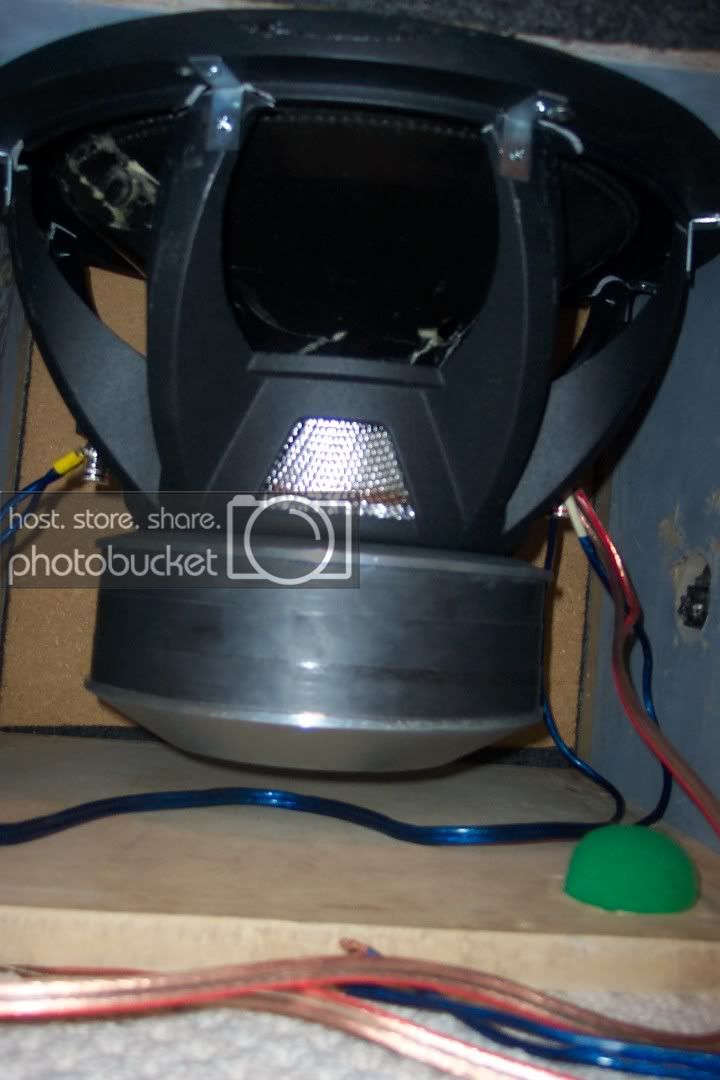

so i created an idea is to fix it. yes fix it //content.invisioncic.com/y282845/emoticons/biggrin.gif.d71a5d36fcbab170f2364c9f2e3946cb.gif

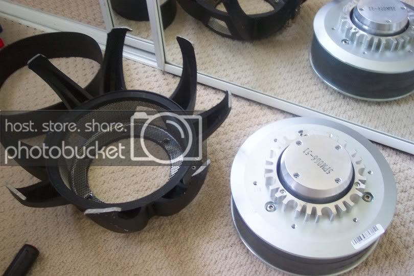

so i took everthing apart & clean it
i brought L shape to connect ring & frame together & Glue call Gorilla
Pros: on Gorilla glue: Strong as Fu*k
Cons: Take long time to dry

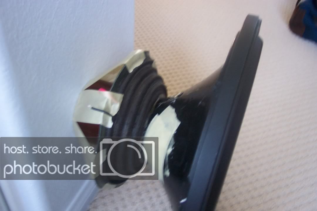

I glue cone back to voice coil. Was working like i want it to.
As for frame i use L shape to connect frame together see pic Below.
& this is how it turn out //content.invisioncic.com/y282845/emoticons/naughty.gif.94359f346c0f1259df8038d60b41863e.gif

i know, I was driving one day, I heard a loud drop in back of my car, like a bomb went off lol & the bass stop, but i hear loud distortion sound. As soon i pop my trunk, i was like hmm, nothing wrong with it. I push the cone, i knew something is wrong with it. Cuz i though it blew up. so i look back of my box which is see through. & i saw this magnet fall off. I was pisss off. but i learn the lesson hard way
SO PEOPLE WHO OWN MTX 9500 BECAREFUL
