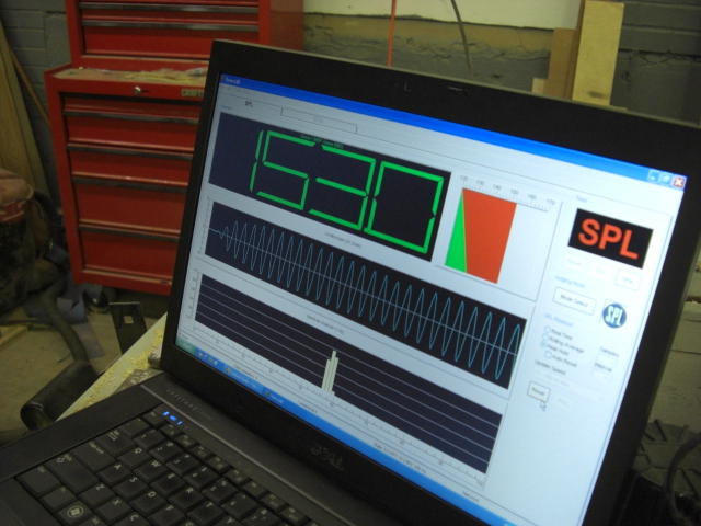

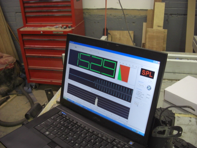

152.7 a minute ago with four 1500s installed... working on getting it tuned a bit better to see what it maxes out at.
Trying for ~153 and I'll be pleased.
Raised impedance on amps from 0.25 each to 0.5 each so real power gain on a burp is not enormous but should give it a good nudge //content.invisioncic.com/y282845/emoticons/smile.gif.1ebc41e1811405b213edfc4622c41e27.gif

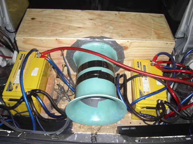

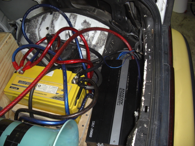

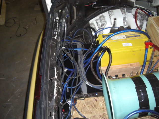

Setup with four 1500s (very messy... 10 lbs of stuff in a 5 lb bag, LoL) -- two amps under rack and two on top.
If the four amps end up staying I will order some matching wire and get it looking a bit nicer... wired it up with scrap wire to see if it would work well or not.
