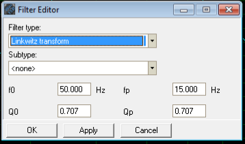

Try adding a filter in the editor like this to get an Idea of the cabin gain you'll get.
It's something that'll help... no, it's not super accurate but with experience it can be used to APPROXIMATE response and extension in-car.
It changes response when added and also the SPL plot but gets screwy with anything else.
