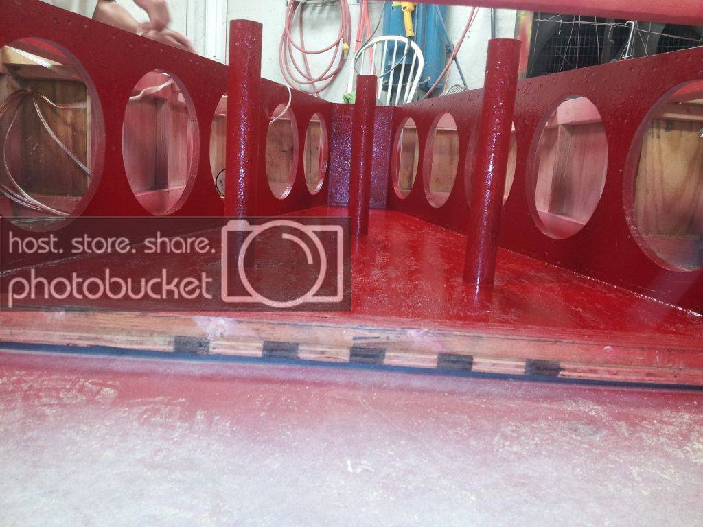

4th Order blow through for 10 12s, 87 Chevy long bed

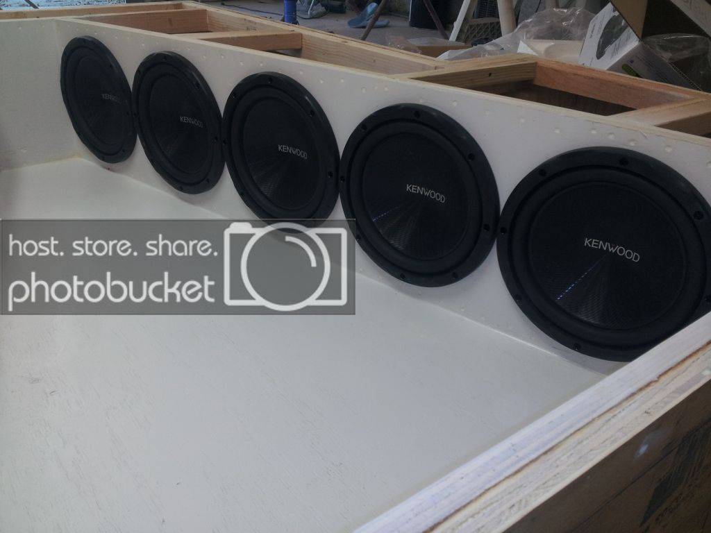

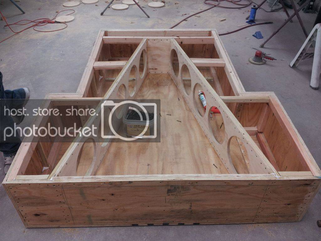

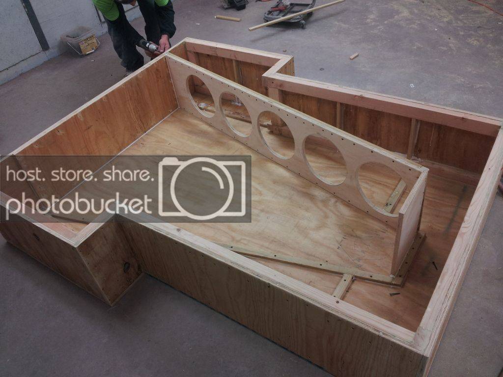

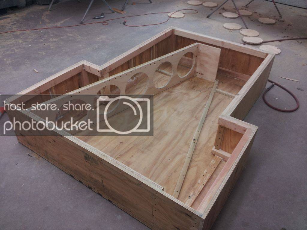

From other forth order builds I've seen and the amount of power your adding I would double up the plywood, or even triple it up. And also I would water prof all the wood with water seal and also fiberglass it.
subbed...looks good so far. cant wait to see outcome //content.invisioncic.com/y282845/emoticons/smile.gif.1ebc41e1811405b213edfc4622c41e27.gif
Cool layout man, how much does that thing weigh? Would love to see a nice plexi window on the top in the shape of a triangle. Would look sick. What are the plans for finishing the box? Carpet, paint?
looks good man, good bracing. cant wait to see this finished, after i get my truck painted and slammed im thinking about doing a blow through

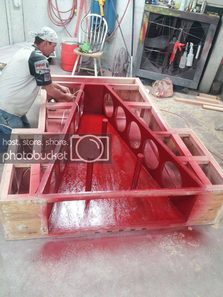

Color change and added several more braces along with some 2" dowels. Getting the wiring started. Also the accordion boot came in today.
you may like them facing forward rather than Rear faced. Its all about how you like and enjoy by your ear/listening not others. try Both...

is this a ported enclosure or a 4th order? If 4th and tuned to 33hz, unless specifically designed to do that, it wont have any bandwidth. It might...

I’m going to stick with the 4th order bandpass for now and see if it can improve it. The bandpass actually plays 100 rebased songs good.

I'd try rear facing. Have you tried opening the trunk to see if that restores your bass?

Any direction you orient a sub can affect it's output, this true even more so in a car. Nevertheless it doesn't add an order and generally...
