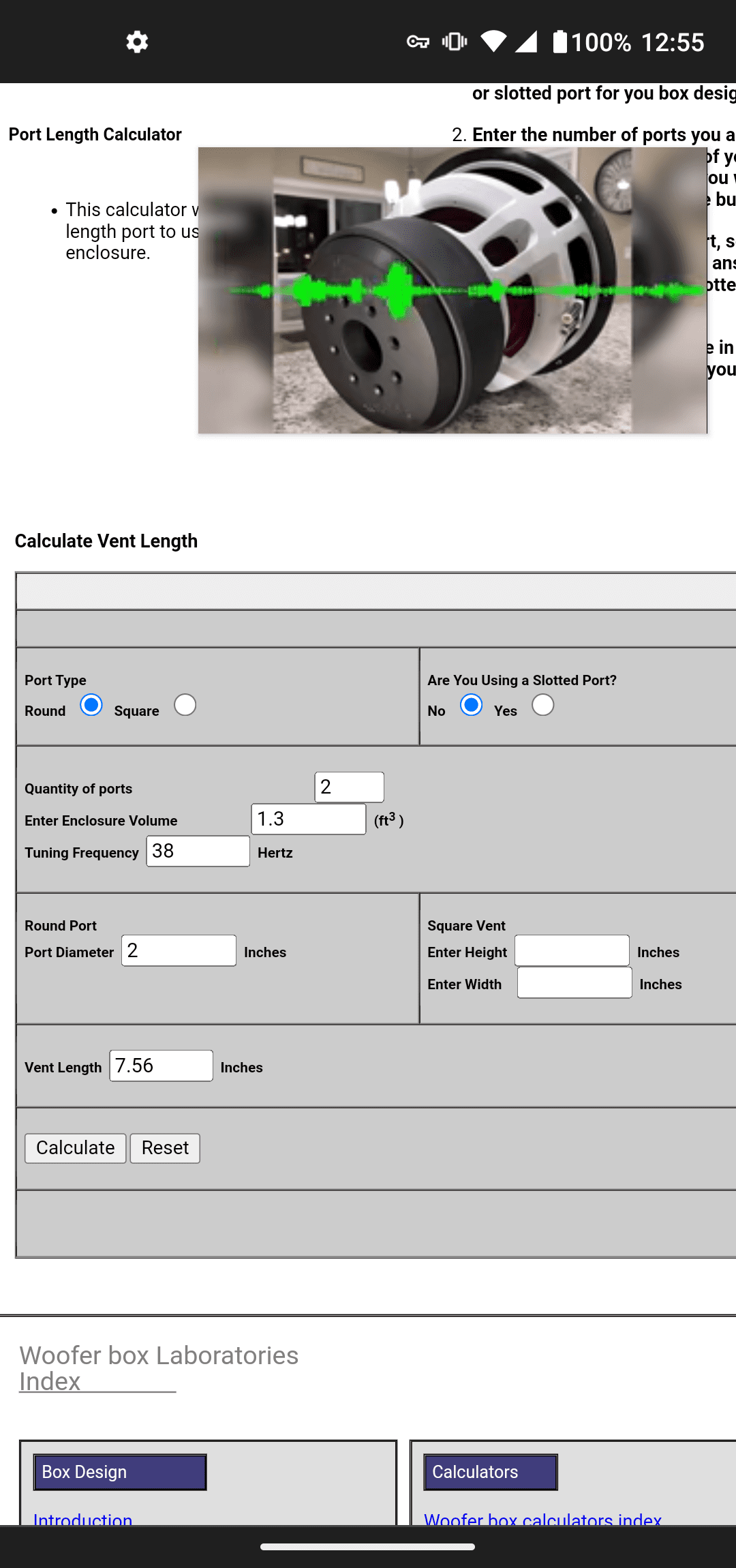

Don't use a 2 inch aero for an 8 especially not a high excursion 8. 3inch minimum. You'll end up with a lot of port noise. Aeros should be 7-14in² per cube of airspace.
In 1.3cubes you nearly require a 4inch port.

And yes you can use a 4inch port in 1.3cubes at 16 1/8" it'll be tuned to 38hz

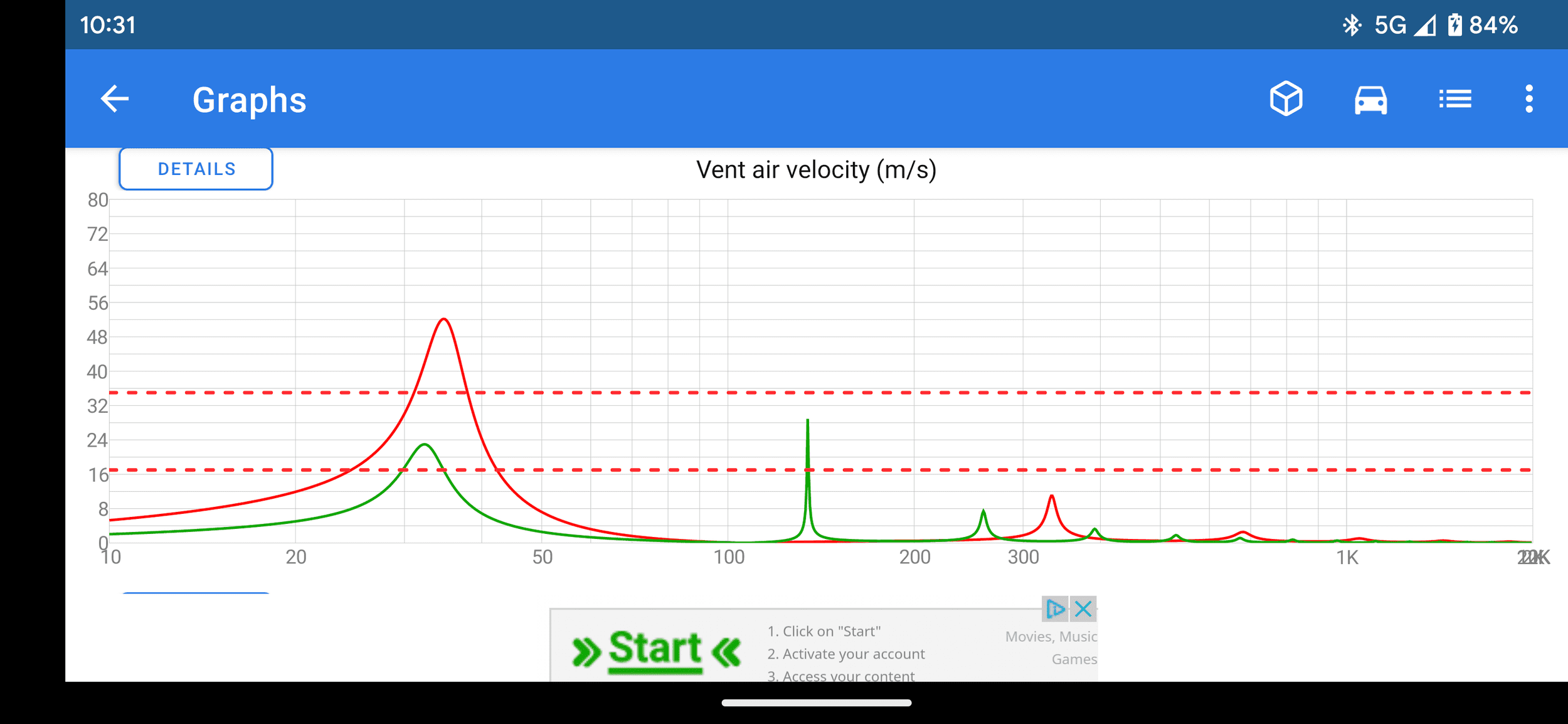

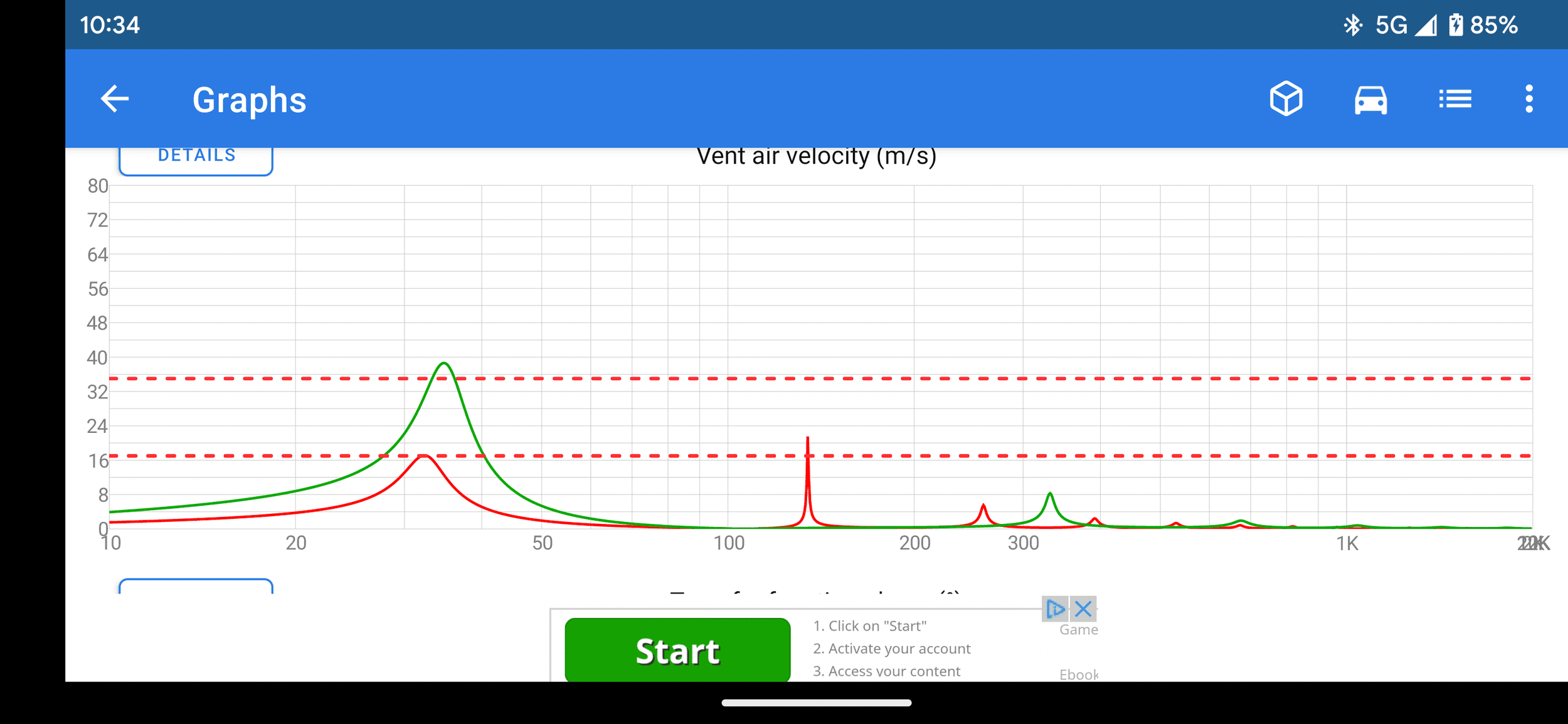

I would do a 4inch aero personally vent air speeds far exceed the 40m/s max with the 3inch port. They even exceed it with the 4inch port once your exceed 1000w.
At 1000w and a 4inch port flared on both sides you are sitting just below 40m/s so you shouldn't get port noise it's only 16-17inches or port length for 38hz

Well you calculate on worst case scenario max power across the whole bandwidth.
This is the 608d2 with both a 4inch port (tall peak) and 6inch port on 1800w which the power is unrealistic but lowering the power only lowers the peaks.
This would be at the more reasonable 1000w and the colors swapped because I'm an idiot and didn't start from scratch
