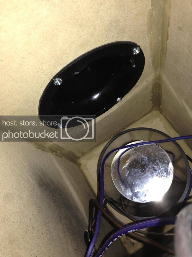

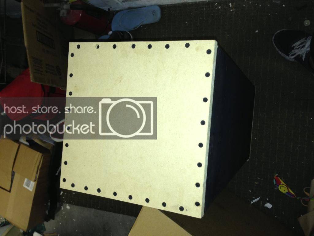

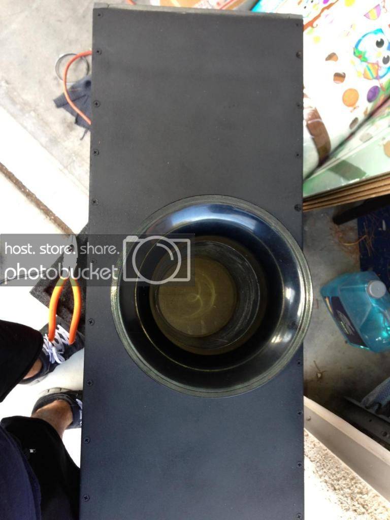

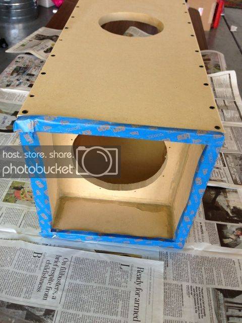

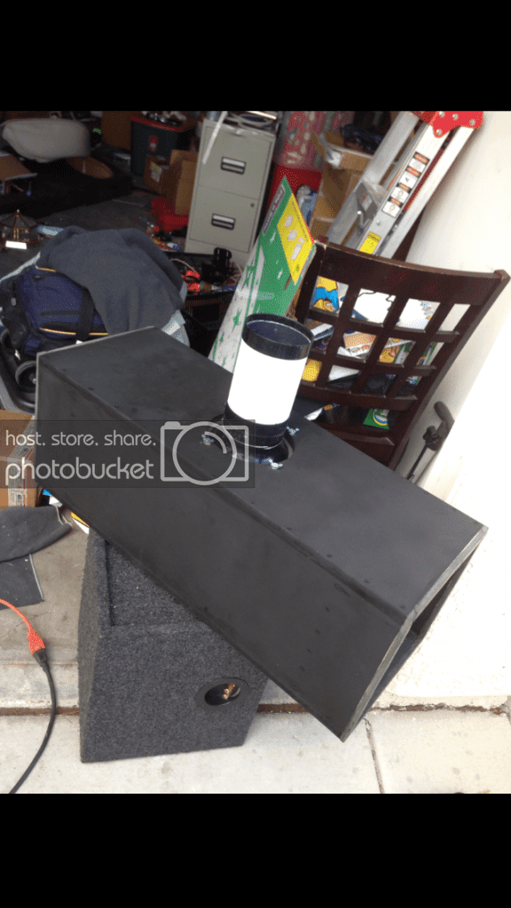

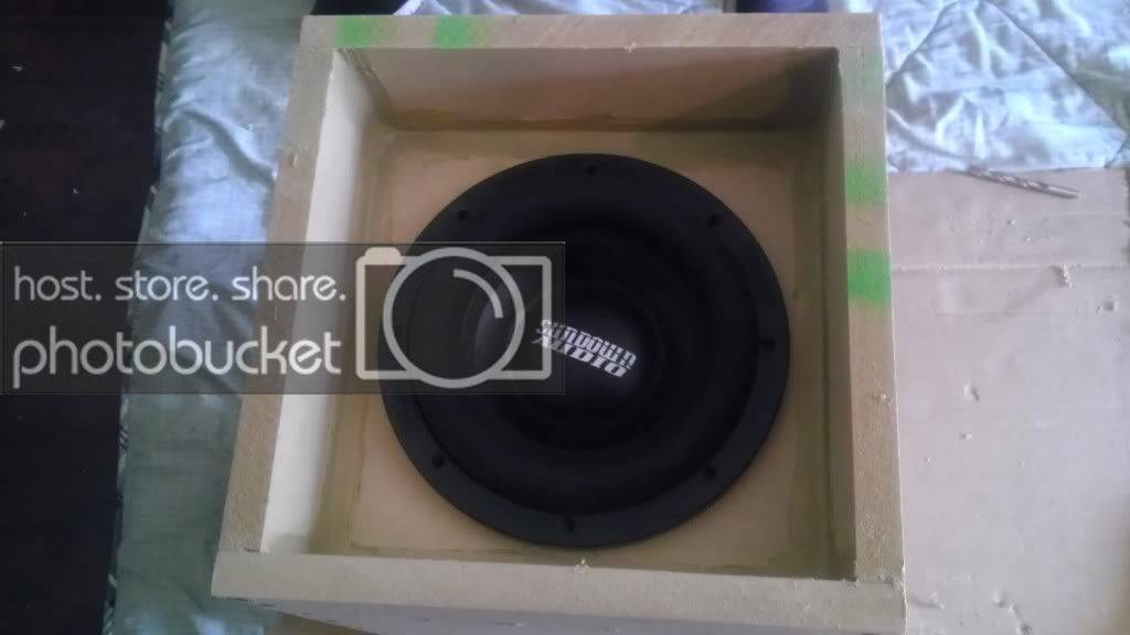

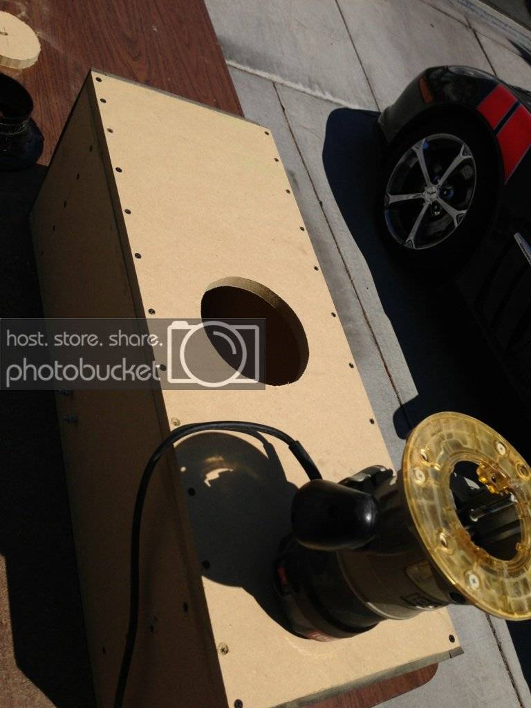

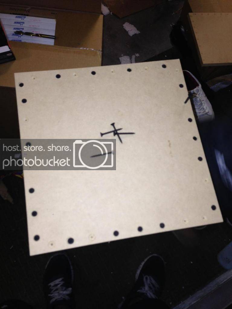

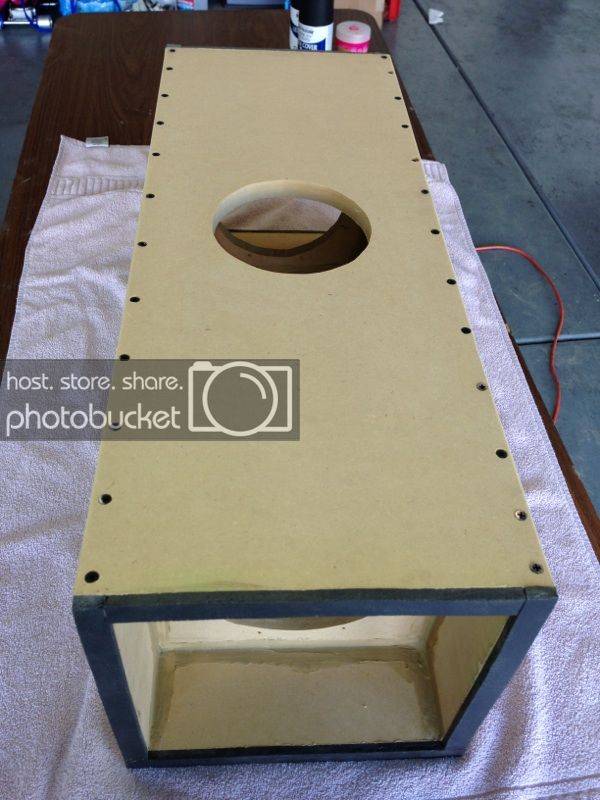

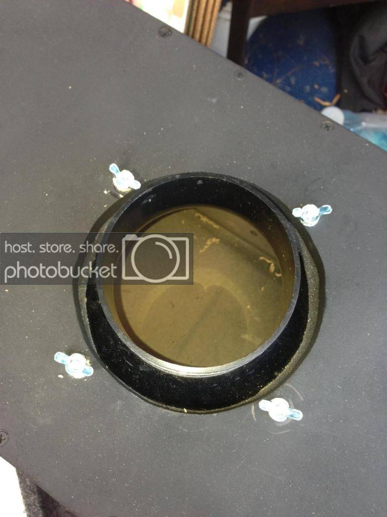

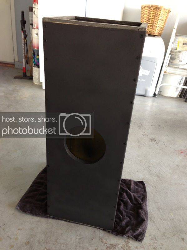

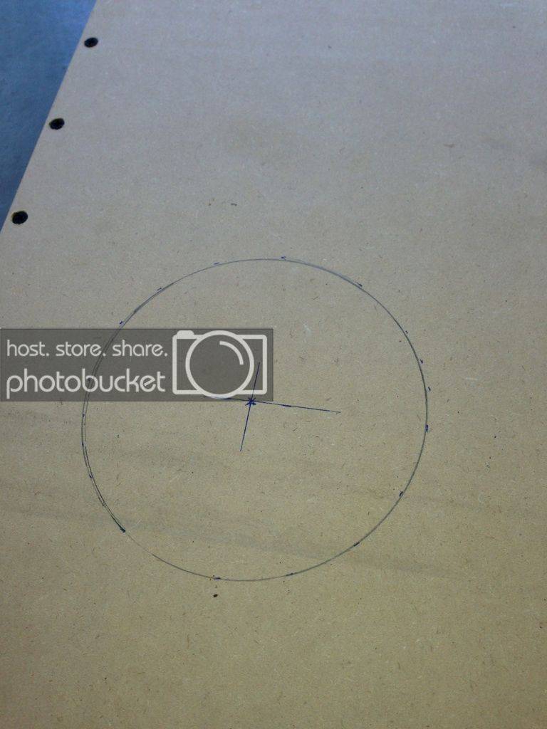

Building this for my buddy for two SA8V2 subs. It is .2 sealed each and 1.1 ported shared. Tuned to 50hz. Powered by a Hifonics BRX2400D wired 2 ohms (1600 watts).

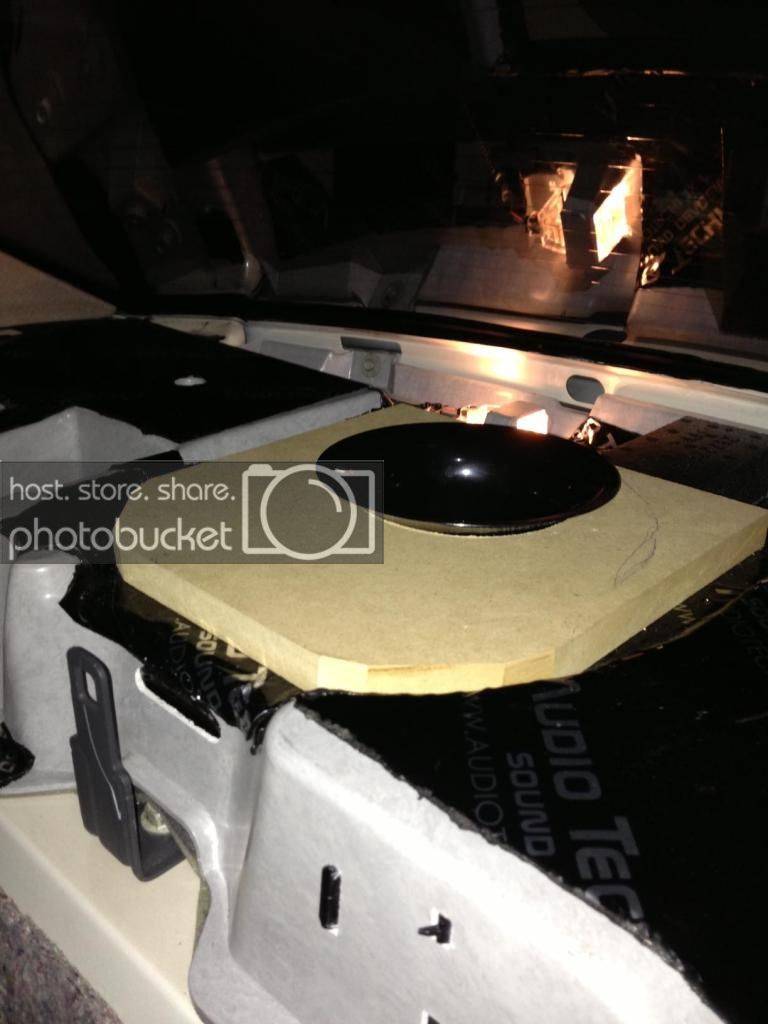

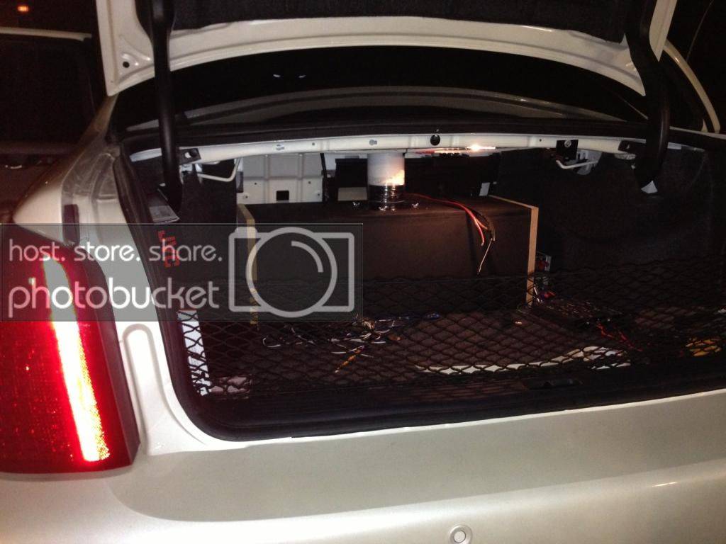

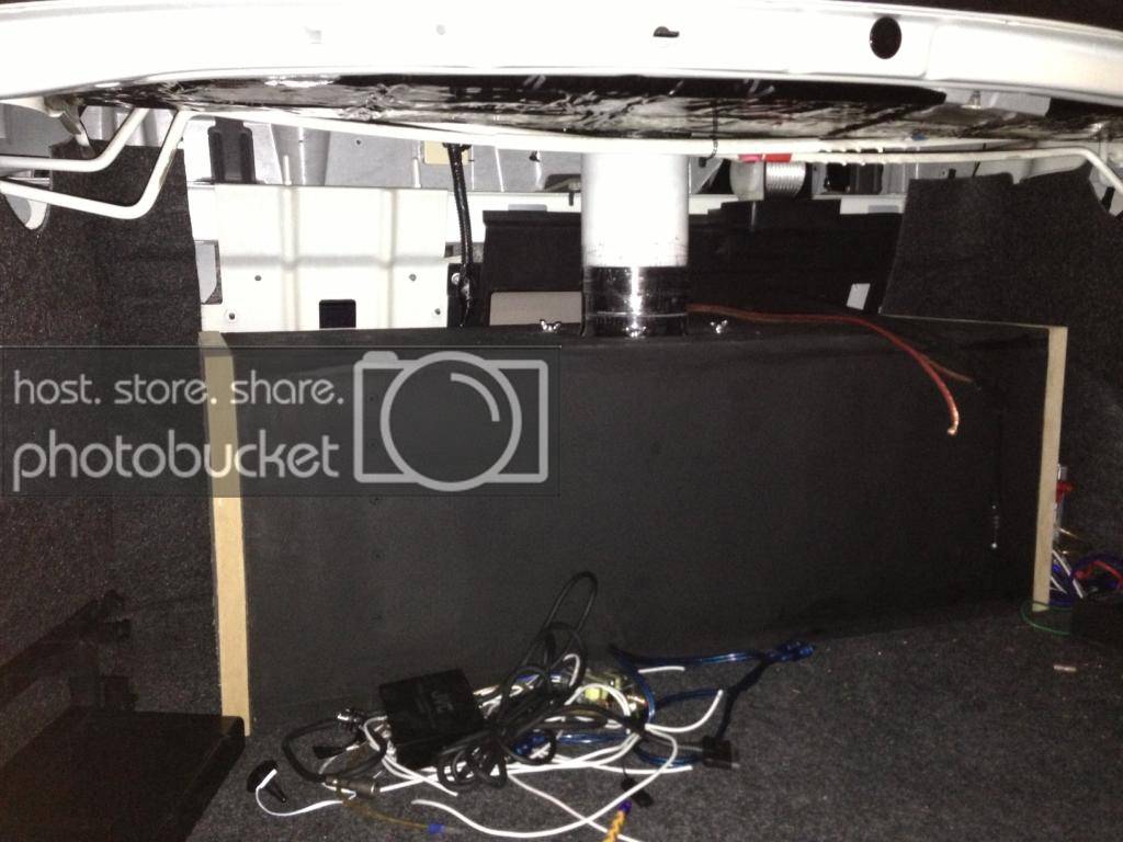

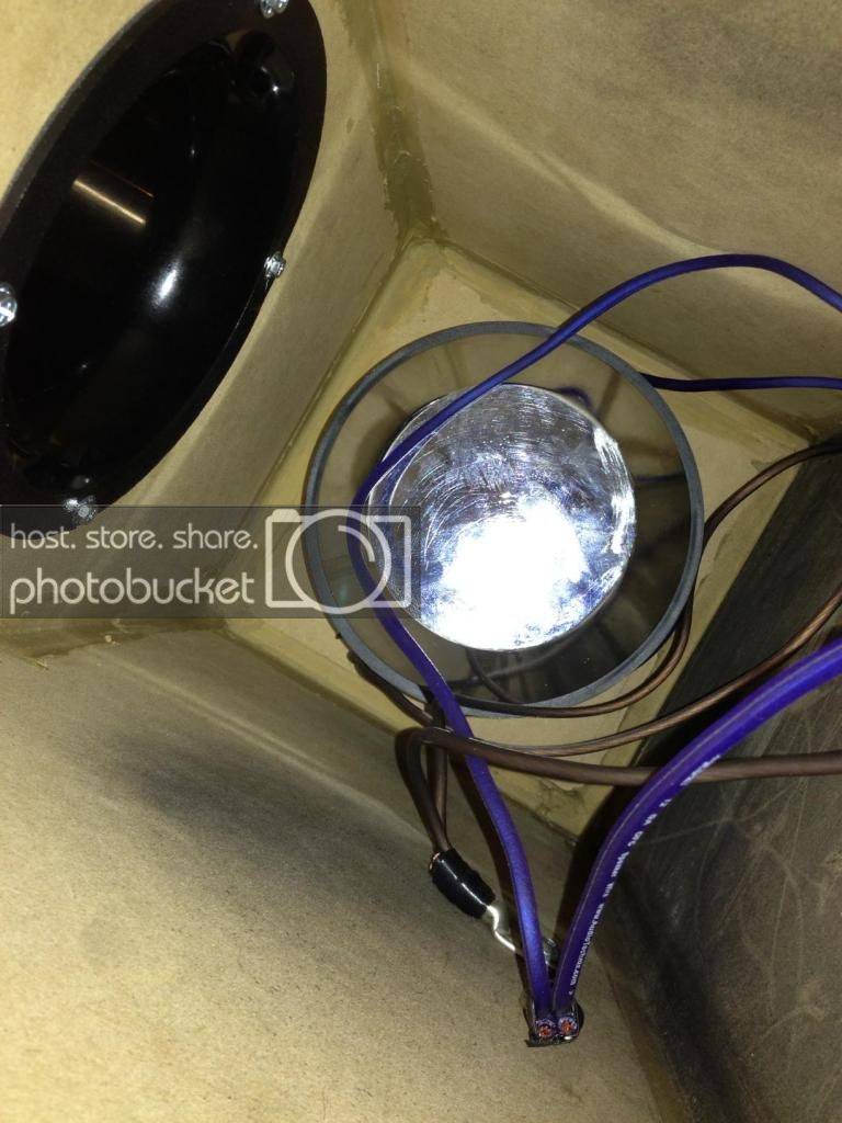

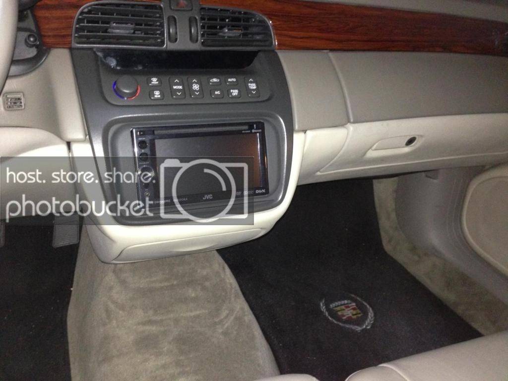

Porting it through the rear deck in his cadillac deville with a aero port. Got the cuft measurements from T-fade. This little beast should be pretty loud!
Good design, but I would be real worried about the sealed section being that small. Not saying it wont work or sound good, just never seen any Sundown design run in a sealed that small. Ive got a 4th order design for an sa8 and mine is about .50 with the sub inverted @ 50 hz and it was done that small for space requirement.
