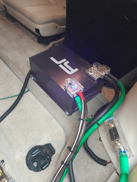

I'm still dropping into the low 12's or lower with 40ah lifepo4 bank.
I'm trying to run ~2-3k rms.
Stock gm alt is 160amps.
Largest draw i've clamped on my jp23 is 120-140 amps on music.
I've clamped my alternator-- normally 40-50amps@ idle.
So where is my weak link?
40ah of lithium just not enough capacity or i got something else going on???
It'll probably drop in a few minutes.. depending on how hard I push.

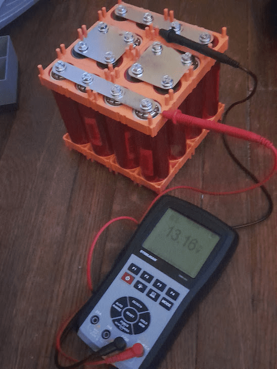

Checked some measurements tonight....
JY40 will draw only ~50amps when you first start the car.
It will stay pretty consistent for a few minutes until the voltage climbs up to 14.0
The battery/ car sits at 13.2v with the key off. Agm up front hooked in parallel.
Sub sits at 1.4ohm nominal--- just checked that tonight too.
Amps never drew over 40amps tonight, so no voltage drop to test....
But i bet i'll start sagging with 100amps continous draw
46626
added a 32AH bank to my system......
Cot damn! Now we rockin.
Voltage staying above 13 wide open!!
