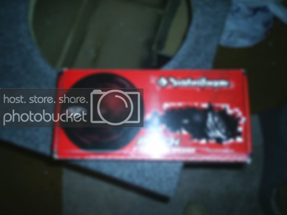

i have some rockford 4'' speakers brand new in the box if u wanna buy them $25
