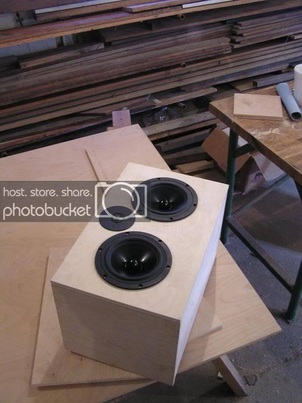

Mid tweeter Mid or a Tweeter Mid configuration.
These are MTM's
eh thats a little more than i wanted to spend...is there any way i could just do like 1 8" and 1 tweeter in each speaker cabinent and build them myself...and keep the cost low?
There are smaller BIBs you know, specifically the one for the pioneer B20 full range on parts express...8 inch full range driver. Lacks a bit on anything above 12k ish but you can always add a piezo for a couple dollars to help that...personally I think it would sound just fine without a helper tweeter if you just want it for parties...
Still fairly large, but not to bad, corner placing will yield output down to the 30s/20s...so no real need for sub if you just listen to music
http://www.zillaspeak.com/bib-pioneer.asp
Looking at around 50ish for the speakers, and up to 100 bucks or more in wood if you go with Birch, surely under 100 for MDF
Im running a set of floor loaded BIBs and I love them, they are only three inch speakers but easily go down to around 60hz and blend well with a subwoofer, imagine the 8, it would be insane...
