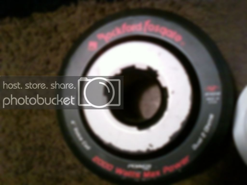

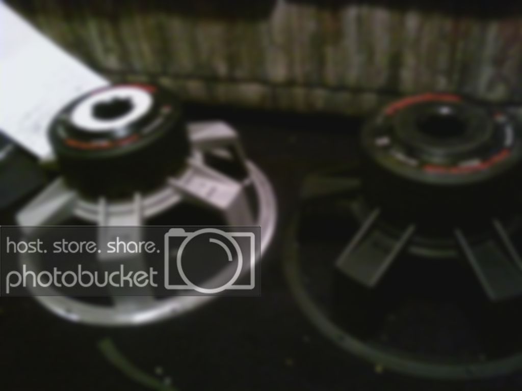

and so here are some other 18s i built for my buddy with some power hx2 motors, 4 staked stiff 9.25 spiders on a 6 spoke basket, with a 4 inch 8 layer flatwound aluminum coil. 8.5 flat dustcap
Are the two RF's Batemans subs, I believe I sold him the motors. If they are glad to se they are getting use....That 160 should be no problem....
no these werent yours, but yours are going with 4 15s i'm building. had to drill out the hole and tap it
