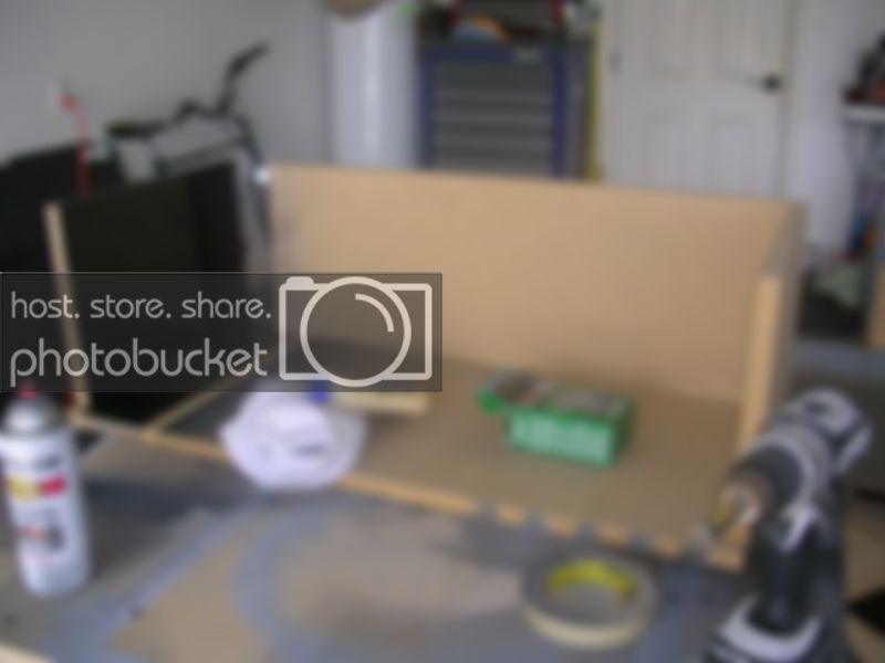

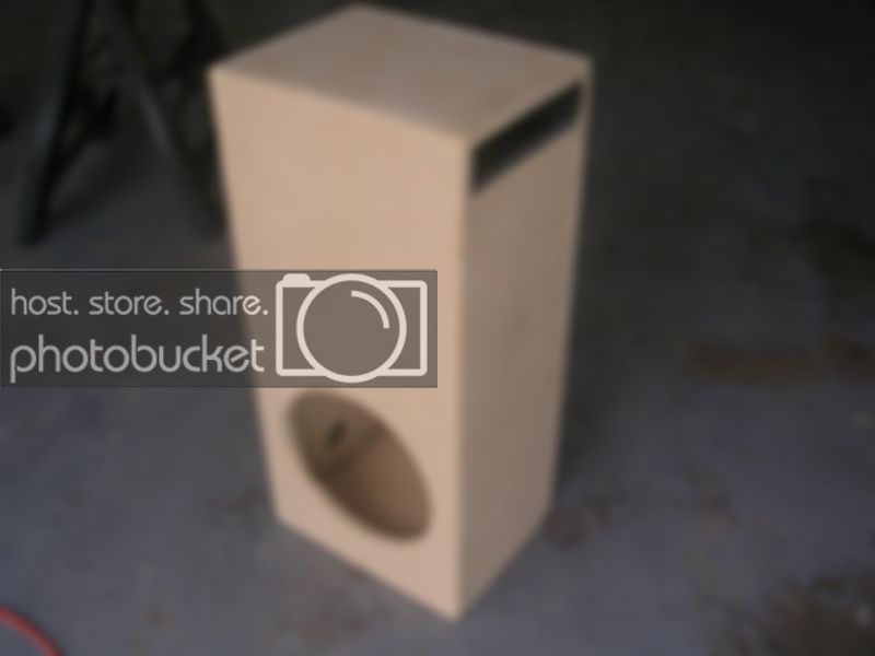

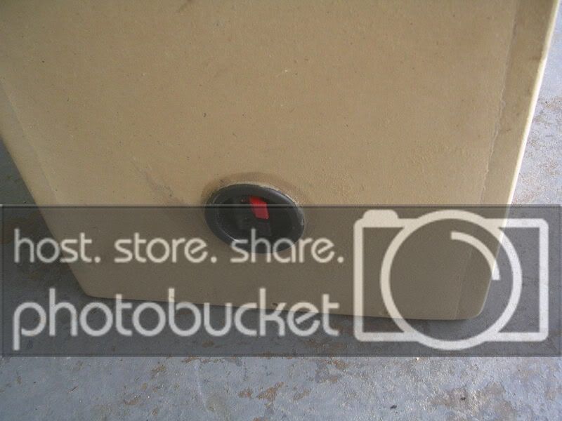

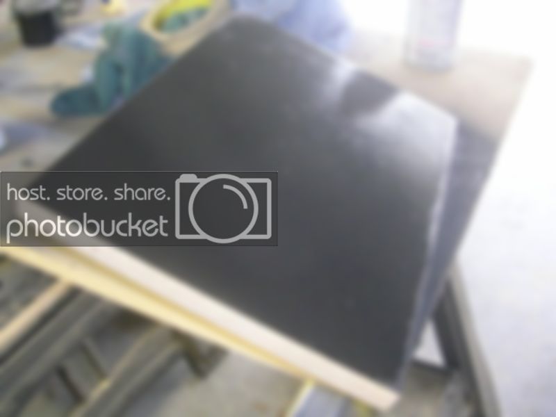

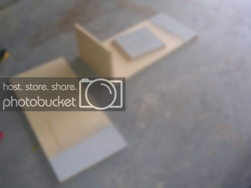

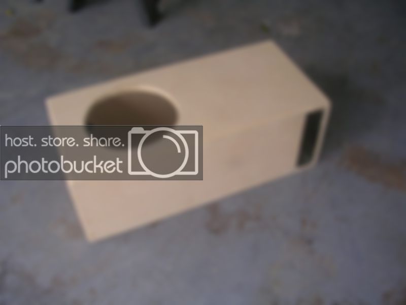

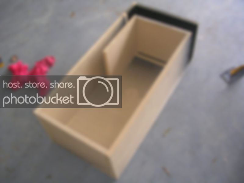

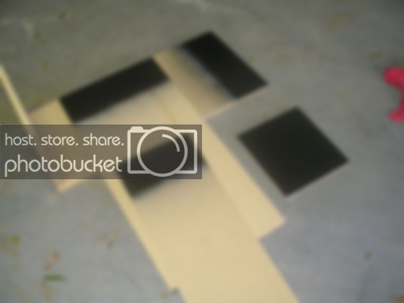

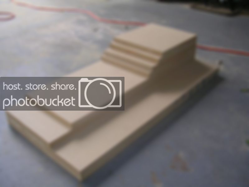

2.0 cu ft tuned to 32 hz, for a Type-R 12. Box is for a new guy, Kraze.

good job. seems like you got your self busy with these boxes. and they even want you to pay shipping? lol. what are the dimensions?
LOL yeah, I've had like 2 or 3 people PM me asking if I'll pay shipping. One guy even wanted me to pay for wood. Uhhhhhhhhh no.
32 x 11 x 15

Does your jigsaw have a variable speed setting? You should try slowing it down some as it might help you keep a more constant circle. It's either that you need a different blade or you just need to slow down. Jigsaws can make beautiful circles free hand, even cheap and ghetto saws.
Other than your cutouts, your enclosures are looking pretty good.
Good idea, I'll have to try a lower speed.//content.invisioncic.com/y282845/emoticons/biggrin.gif.d71a5d36fcbab170f2364c9f2e3946cb.gif
