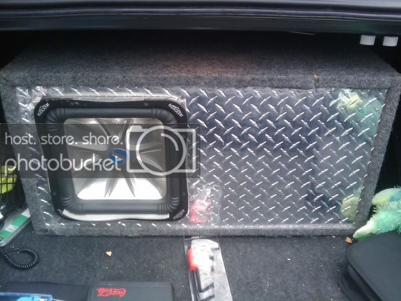

I hear ya on that! I havent yet heard another single sub in my area as loud as mine, most are like "Bullsh*t thats not one twelve". with your dimensions i think you may be able to get like 3.25-3.5, a lil more than your current setup, Id also port it out the side of the box if you fold your seats down alot, I had a 00 grand am with fold-downs and it sounded great ported out the side rather than into cab, as for rattling that trunk to pieces, thats a project all on its own, just depends on the car.I was pretty impressed with minimal rattles my grand am. Heres a pic of my old box, the one im referring to.
