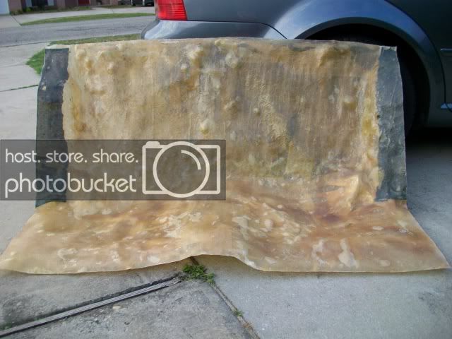

The fiberglass bottom/back...

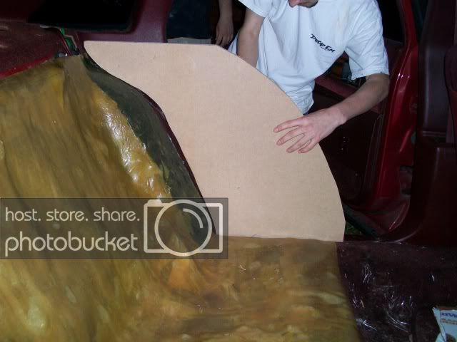

The first dry fit trying to get the sides right...

I don't know about that fiberglassing. Looks like a lot of bubbles. I can't imagine it's very strong at all considering the wide, flat sections of it. Do you think it'll be sturdy enough for 4 15"s?
Well, it does have a good bit of bubbles... But its being backed by the floor and back of the car to give it more strength... It's pretty strong already, and I'm probably going to throw one more layer on it... When it's in the car I'm pretty sure it'll hold up alright...
