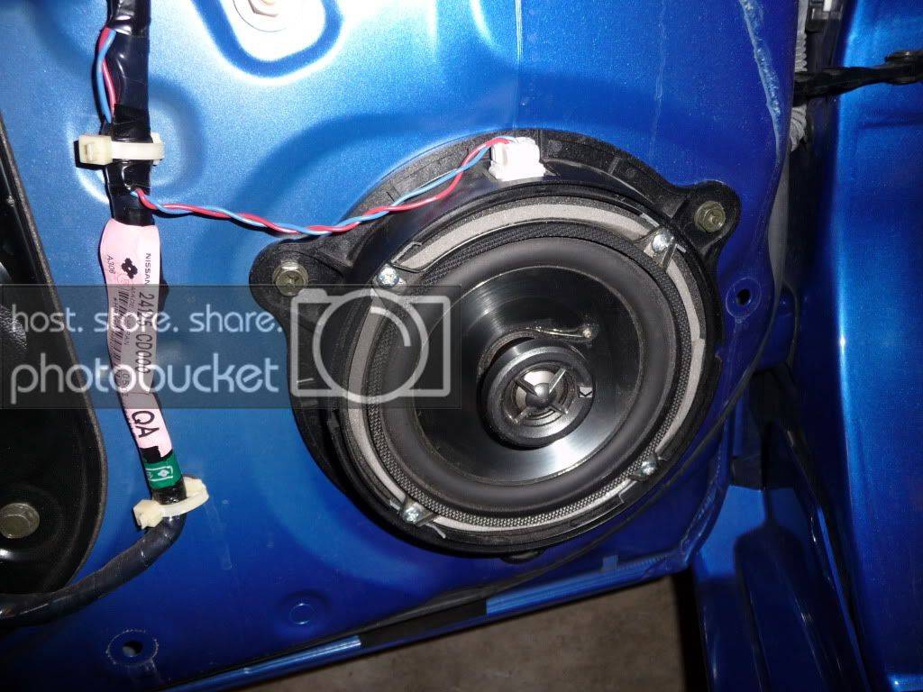

I really want to listen to some different comps before I get a set, so I just dug out a set of Kicker KS5250's that have been gathering dust for a few years and proceeded to "make it fit."

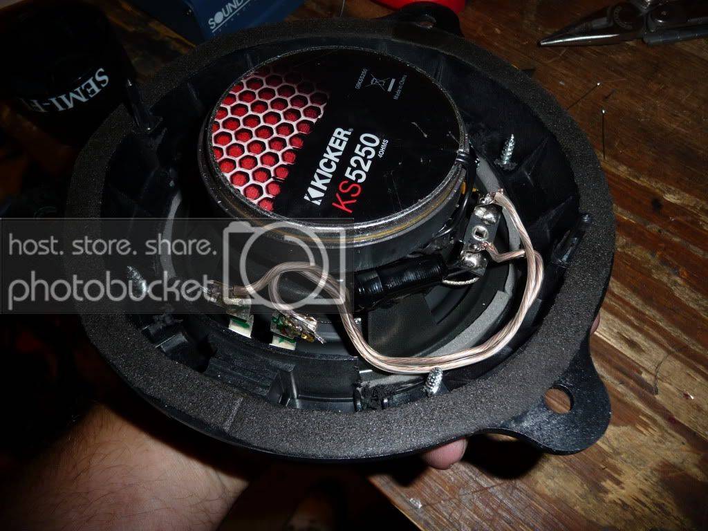

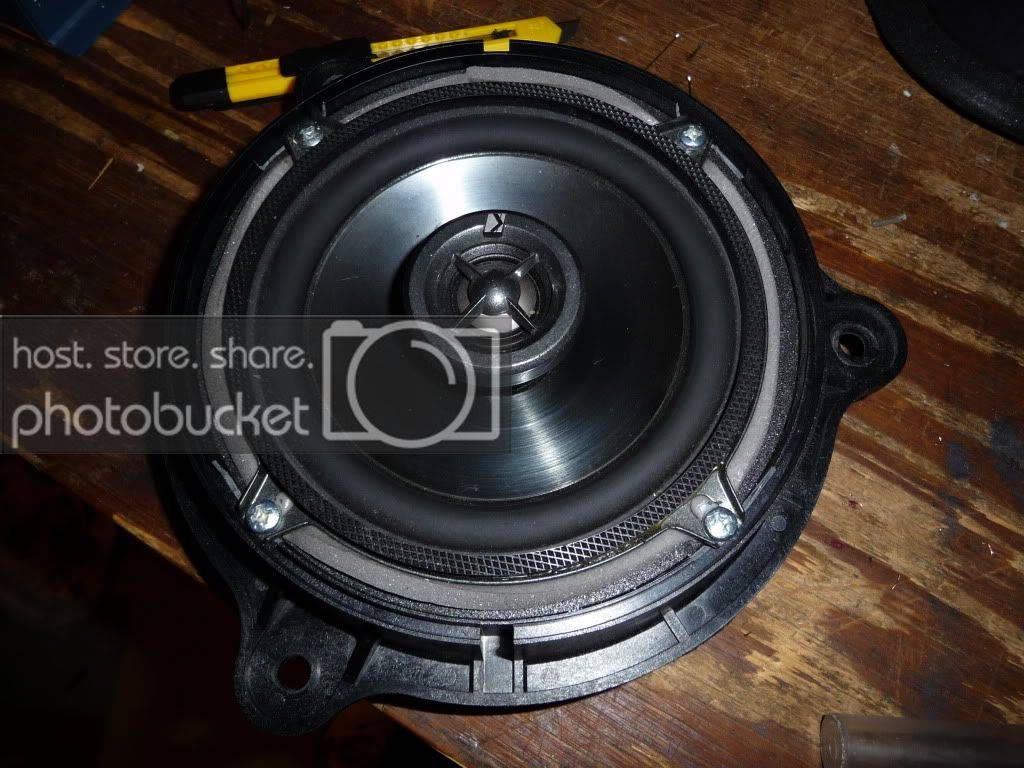

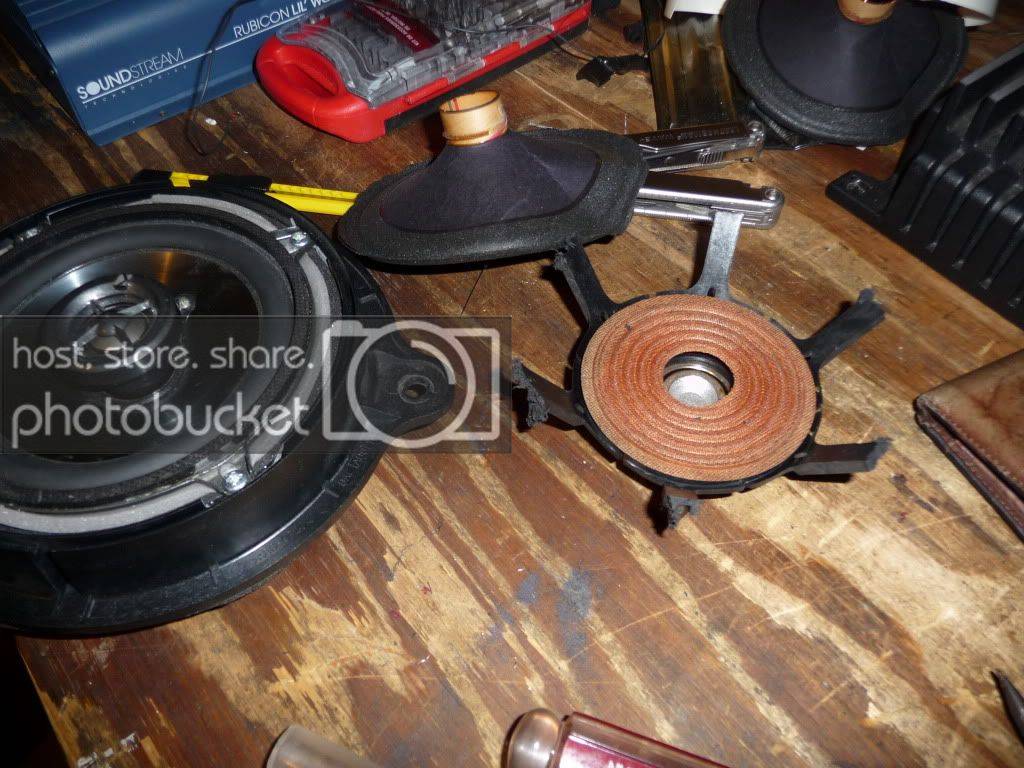

First, I used an exact-o knife to cut the cone out of the basket. Using a rotary cutting tool, I cut the plastic basket away from the trim ring. Then I fabricated a gasket from some window gasket tape. Drilling through the plastic ring to mount the 5.25 was easy. (The plastic was soft enough that it didn't crack, even with some of the wholes close to the edge) Once mounted in the factory trim ring, I just soldered a little jumper from the new speaker to the stock tinsel lead connection points...

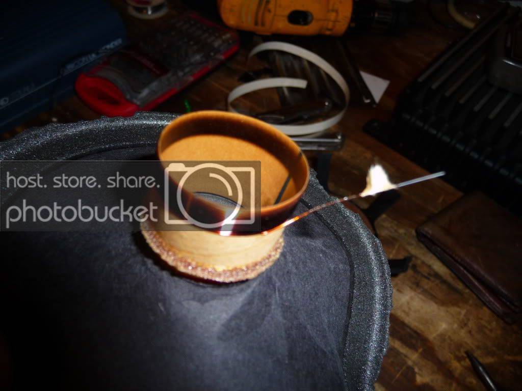

Burned VC on stock unit. (Smelled very burnt)
All in all, cannibalizing the stock speakers yielded some good spacers with a perfect seal to the door.
