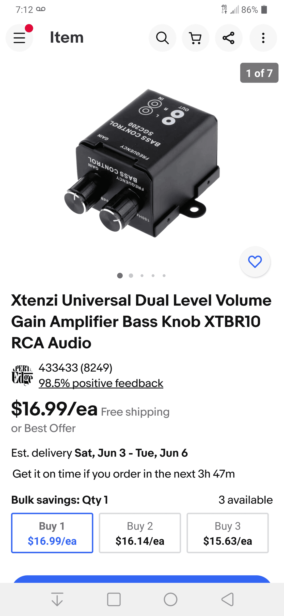

I was wondering about that. I have an older amp that I want to hook up for mids and highs. The manual says the inputs are 200 mv - 2 volt. As you know most head units are now manufactured with 4 volt. They still make some 2 volt head units, but they seem be limited on features compared to the 4 volt and higher. I have not purchased a head unit yet. Can I use a head unit with 4 volt outputs on this amp and just turn the gains down? https://download.phoenixphorum.com/Manuals/Amplifiers/MQ_Amps/MQ430_manual.PDF
You can use one of these-
For some reason you can't link to DIYMA from here. 2v is just fine. If you have a 4v HU, just use a lower volume setting (down 3db) to set your gains.
