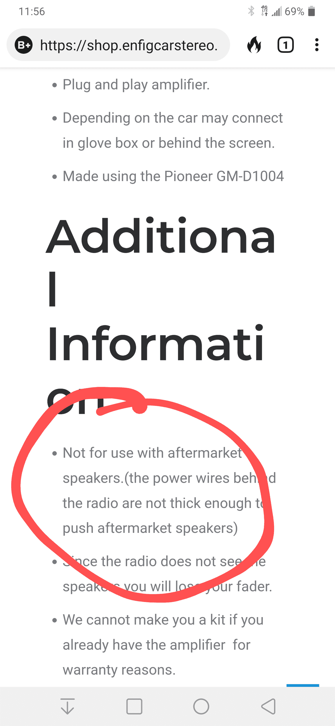

First thought was a Resistance issue, but the specifications say 45w x 4 @ 2 or 4 Ohms. So that is off the table. Another thing that comes to mind is insufficient power. Specs say 15+ amps, so I would check that out. I think it should have at least a 14 AWG power wire. Ground is just as important so make sure it is solid.
I just checked that kit you got, it looks like the issue is the power supply:

No. The company that pieced that set together says that the amp cannot handle aftermarket speakers due to the thin OEM wires that it is spliced to. Meaning if you give the amp it's own power supply, it will handle aftermarket speakers easily. So the shutting down of your amp is due to lack of power to it.

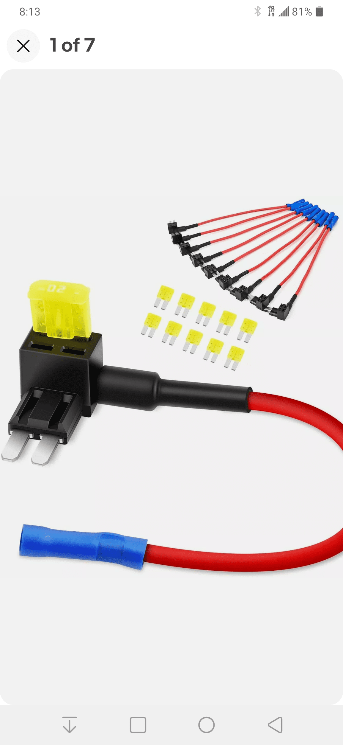

To solve this, cut the 12v power (Yellow) and ground (Black) wires that go into the amp (tape the ends that do not go into the amp) Splice them with 12 AWG wire. Run the Yellow to the fuse box and use an Add-A-Circuit kit (specific to your fuses). The Black wire can be screwed to any bare metal for ground.

I will need to purchase a add a circuit kit that is specific to the types of fuse sizes I have in my car - any specific amp rating I should aim for when tapping into a fuse? 15 and above based on the manual?

Ok, was able to get some high quality 12awg wiring. Waiting on a 20a Add-A-Circuit to ship to me (everything nearby only had up to 10a, I figured better safe than sorry.)
