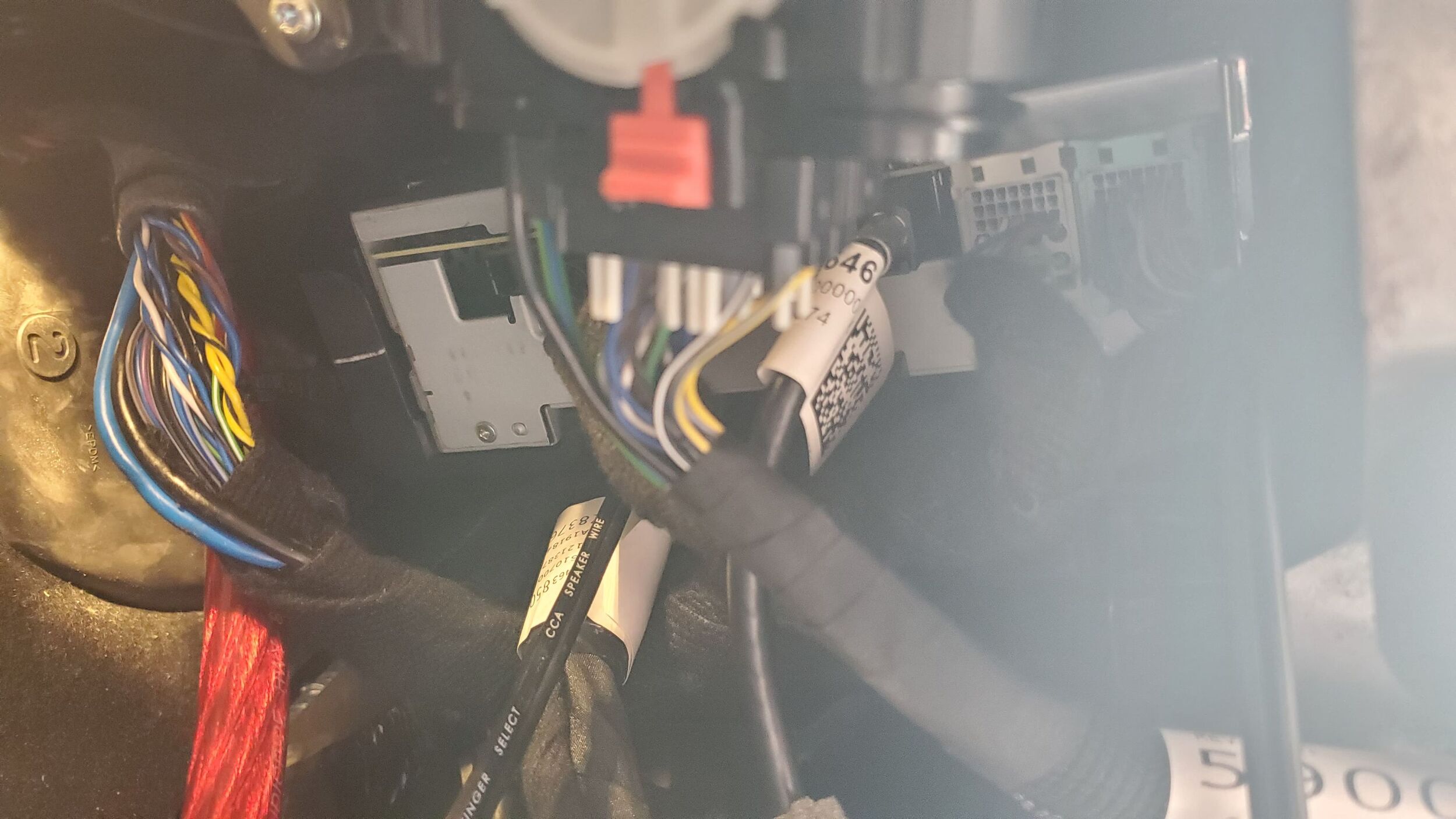

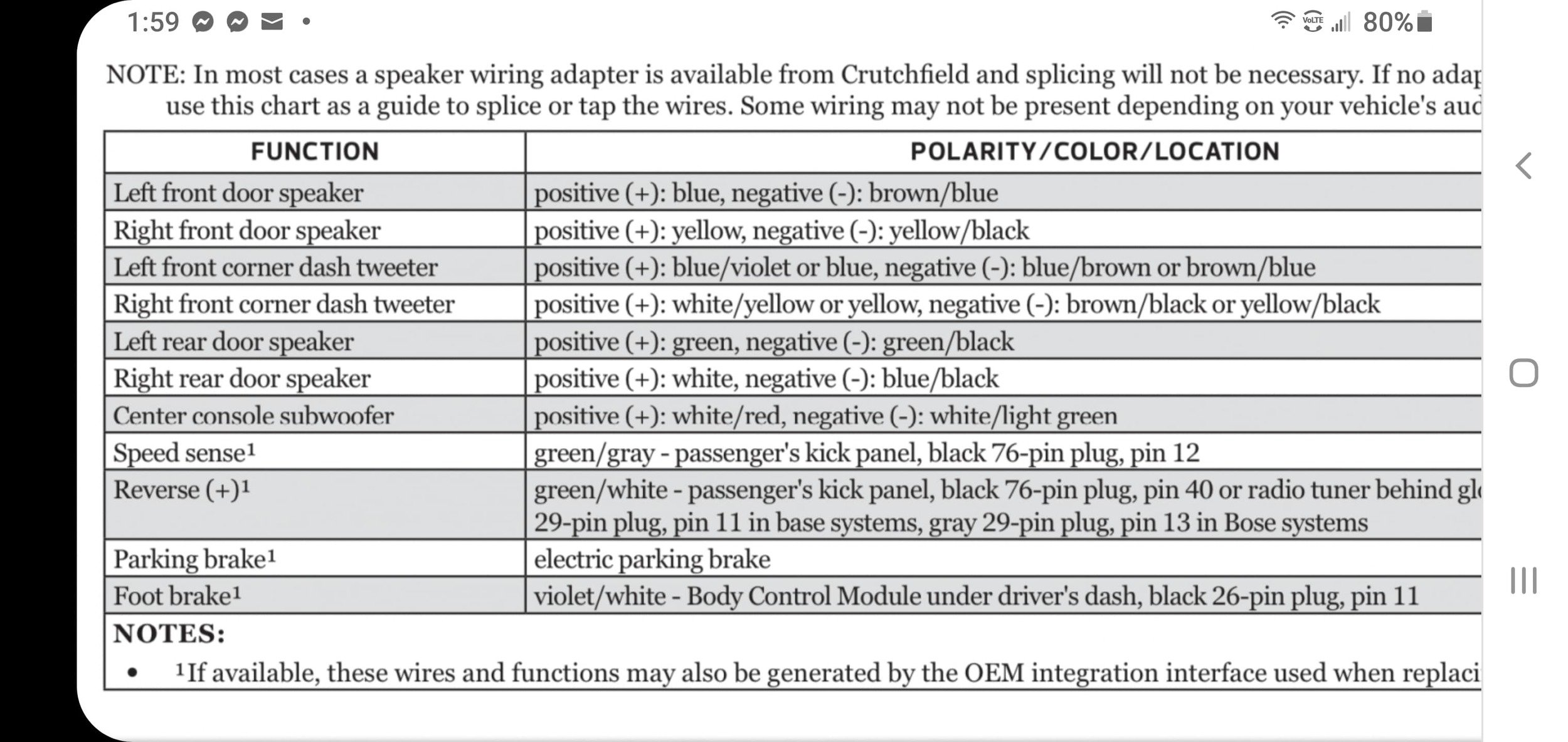

So, after messing around with my truck for several months. I figured out some of the wiring. Ill attach a few pics. The pic shows where the harness enters the module for the radio (on the right, blue and white plugs). Then on the left you can see I found the wiring (twisted pairs). You will have to peel back the black cloth surrounding it. I am also attaching a wiring print out. Enjoy
